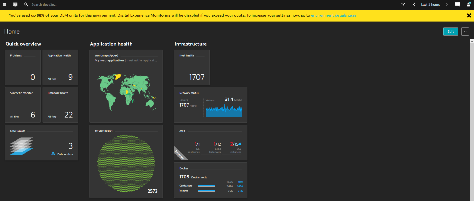

Receive notifications when your quota of Digital Experience Monitoring (DEM) units runs low
We want to make sure that monitoring of your applications’ digital experience isn’t stopped due to your license running short of DEM units. Dynatrace Managed now notifies you when you’ve consumed 90% of your licensed DEM unit quota. With this approach, your cluster administrator can pro-actively adjust your licensed monthly or annual DEM unit quota. See example notification below, stating that 90% of the allotted DEM units have been consumed

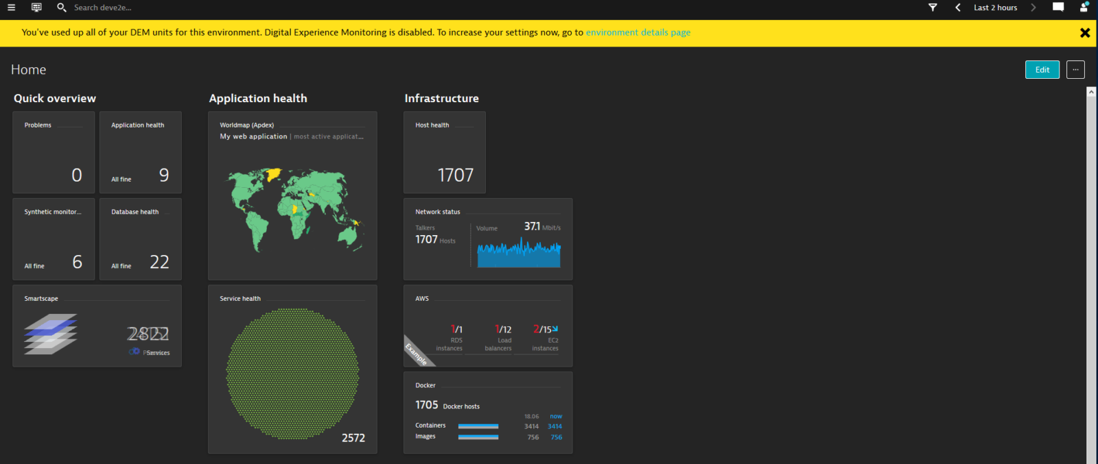

Once the quota limit is reached, the notification changes, letting you know that DEM has been disabled:
Once the quota has been adjusted, notifications for all affected users are removed automatically. Note that these notifications are only triggered for DEM licenses. Notifications for other monitoring unit types, such as host units, custom metrics, and Log Analytics, will be added in future releases.
