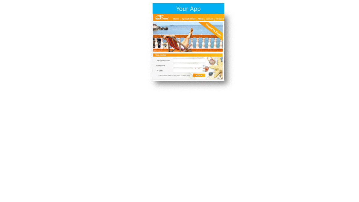

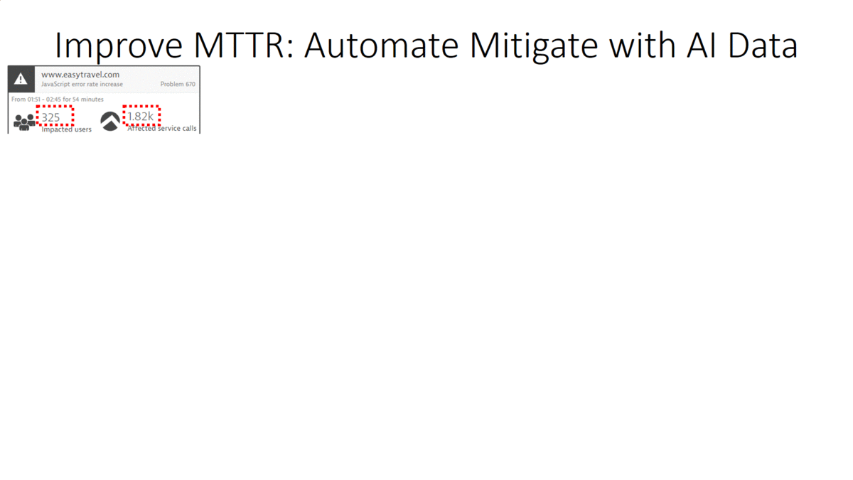

Here is the animated slide from our webinar that started the discussion:
AI Detected Problem details allow us to build smarter automated mitigation actions. No need to wake up engineers at 2AM every time a problem happens.
Our point of the webinar was that with the Dynatrace AI (Artificial Intelligence) analyzed data, we can trigger and build much smarter Auto Mitigation actions. Here are our thoughts to explain the slide:
  • Escalate at 2AM? Dynatrace auto detects the problem and how many end users and service endpoints are impacted and this translates directly to the severity of our escalation process.
  • Auto Mitigate! Dynatrace is aware of all important events across all entities involved in the problem. (e.g: network connection issue, critical log message after a configuration change, CPU exhaustion) This allows us to write smarter auto-mitigation steps to address the root cause and not the symptom of the problem!
  • Update Dev Ticket! If the mitigation actions work, we can automatically update the JIRA ticket about the executed actions and in the daily stand-up, developers can discuss what happened last night.
  • Mark Bad Commits! If the mitigation actions didn’t solve the problem, we still have the option to rollback and mark the responsible Pull Request as BAD and Detailed Analysis can be done in the post-mortem retrospective!
  • Escalate as last resort! If rolling back doesn’t solve the situation, it’s time to definitely escalate – even at 2AM!

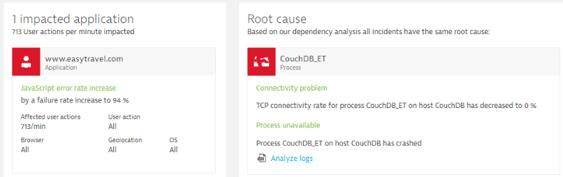

The first use case is a simple, but very common use case. Dynatrace AI detected a JavaScript error rate increased to 94%, impacting 713 real user actions per minute. Dynatrace AI detected the root cause of this error to be a crash of a CouchDB process which is used by Tomcat (Application Server) to serve all dynamic page requests:
Dynatrace automatically tells us impact and root cause thanks to data from OneAgent, Smartscape and AI-based Anomaly Detection detection
One would normally not suspect the correlation of a spike in JavaScript Errors to a CoucheDB process crash. Thanks to Dynatrace OneAgent (FullStack Data), Smartscape (Automated Dependency Model) and the AI engine (Anomaly Detection) the root cause was automatically detected.

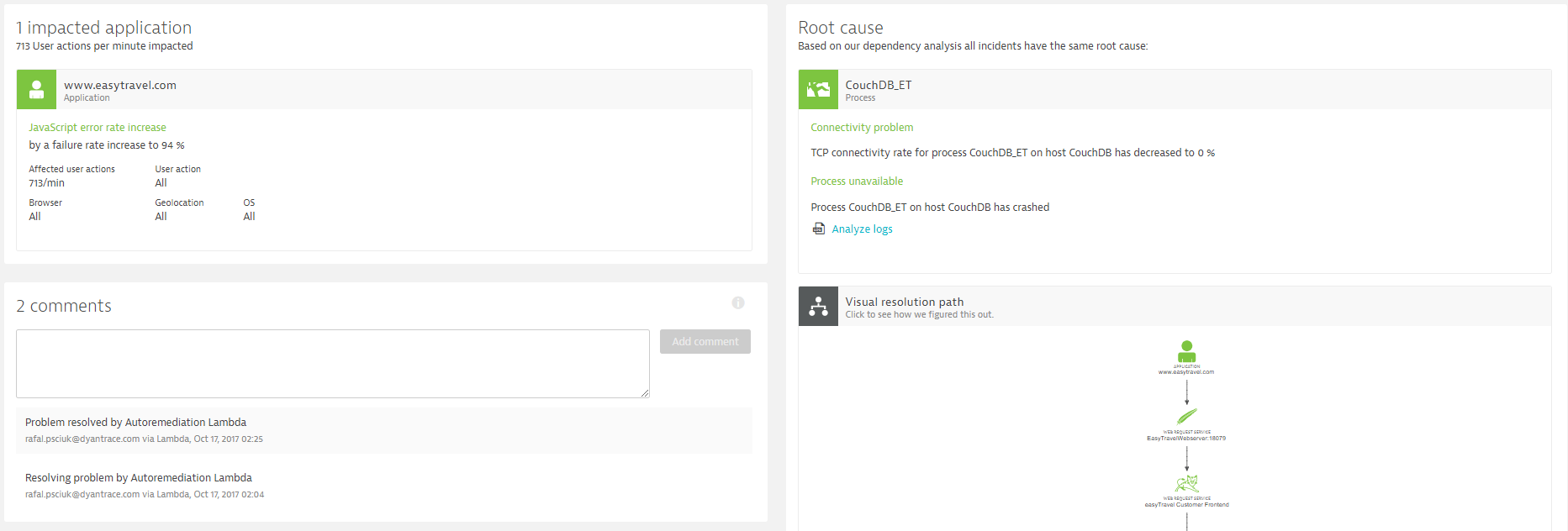

The Lambda function also puts a comment on the Dynatrace Problem to indicate when the function started to mitigate the problem and when it eventually solved the problem! All of this is neatly documented when looking at the Dynatrace Problem history!
The Lambda Mitigation Code not only fixes the problem the AI detected, it also protocols each step along the way back to the Dynatrace Problem ticket.

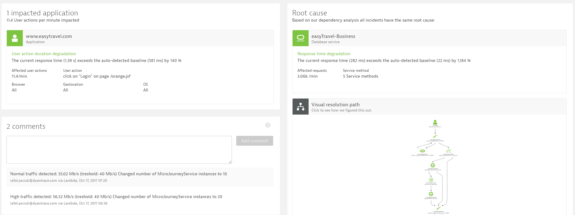

The login page is experiencing a 140% increased load time caused a slowdown of the backend database which is used by 5 different service instances!

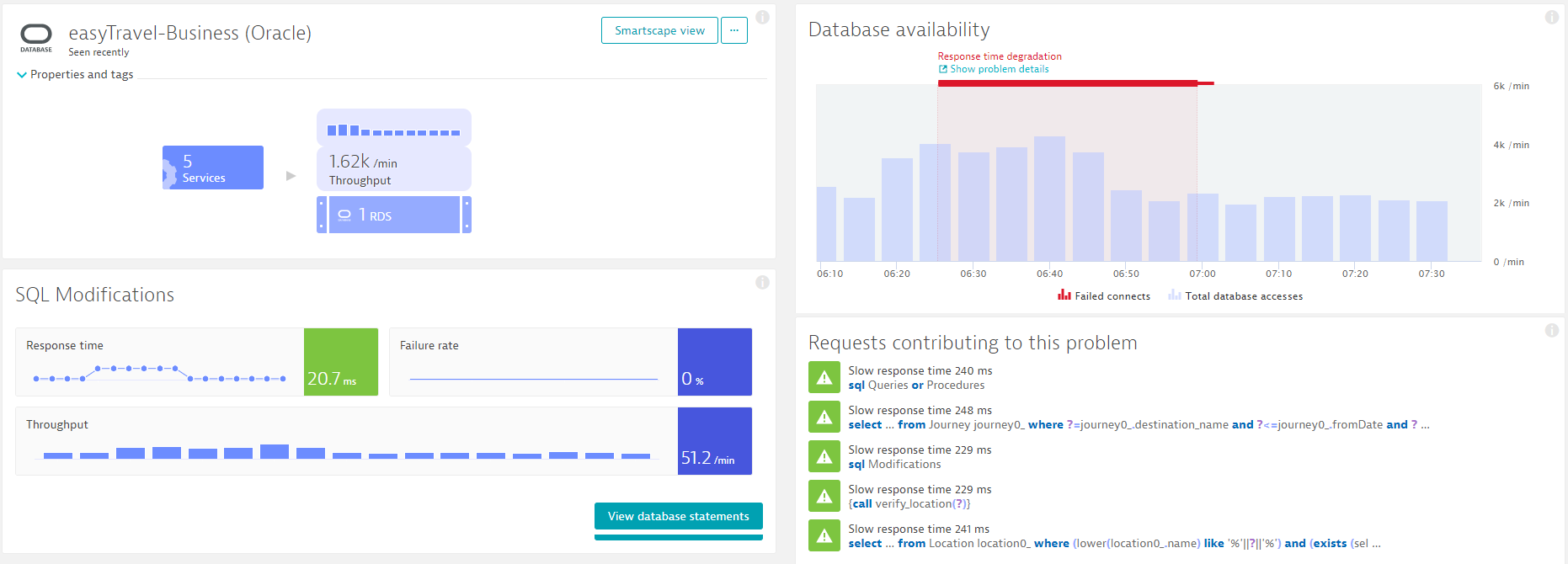

The first observation is that the database is the problem and therefore, it has to be fixed. A closer look at all the details Dynatrace captured, shows us that the slow down came from a high number of UPDATE statements executed by one of the 5 services that share this database. It was basically a batch job that somebody had triggered, impacting all other services that use that database.
All other services had to wait much longer for database responses, which meant that their threads were blocked and couldn’t accept newly incoming requests fast enough.
The increase in throughput and response time for UPDATE queries caused an impact on all sorts of SQL queries executed by 5 different services.

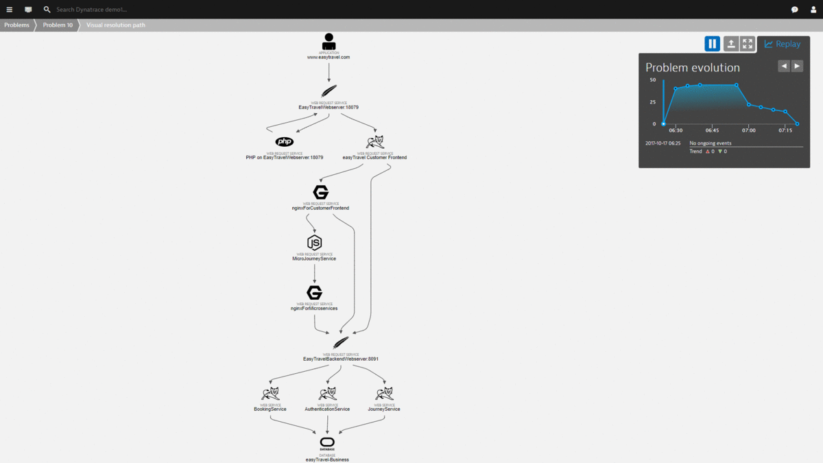

Here is the Problem Evolution replay of this use case – showing how the Dynatrace AI not only detects the problem, but also detects when it was mitigated / solved:
Problem Evolution showing how the slowdown in the database impacted the MicroJourneyService until we scaled up by adding more instances
Problem Evolution showing how the slowdown in the database impacted the MicroJourneyService until we scaled up by adding more instances.
The Lambda function also puts a more detailed comment on the Dynatrace Problem to indicate WHICH situation was detected (high database traffic) and how it solved the problem!
“Self Healing” function not only documented remediating action but also more details about what more details it found in the problem details that lead to that specific scaling action
“Self Healing” function not only documented remediating action, but also more details about what more details it found in the problem details that lead to that specific scaling action.
