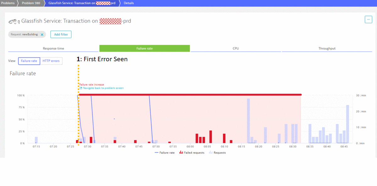

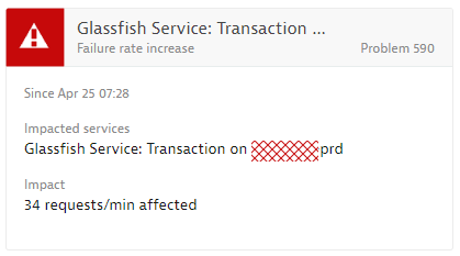

7:38 am – Dynatrace notifies about Failure Rate Increase
Dynatrace baselines a multitude of metrics across all end users, applications, services, processes and infrastructure. At 7:28 am, Dynatrace noticed an increase of failure rate. To avoid false/positives, Dynatrace’s anomaly detection algorithm keeps observing the situation until it is clear –  an abnormal behavior is a real impact on End User Experience or SLAs (Service Level Agreements). At 7:38 am, Dynatrace confirmed the failure rate to be a business impacting issue and opened Problem 590. The problem included context information about the actual impact (34 requests / min), the type of issue (Failure Rate) and listed the impacted service (a Glassfish service running on the named host):
Dynatrace detected failure rate increase in a specific Glassfish instance and also highlights the current impact this issue has!

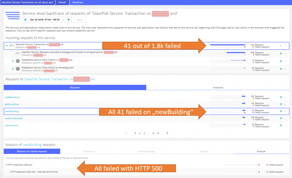

7:43 am – Analyzing Root Cause and Connecting to Dev
The customer was one of the first responders to the issue. A single click on the problem ticket showed him that the issue only affected one of the many service endpoints – the one for “newBuilding”. The following screenshot shows the Dynatrace Backtrace view – showing how many requests failed, how they are distributed across the different endpoints and which error was actually causing the failure rate increase:
Dynatrace pinpoints the problem to individual endpoints and highlights the actual reason of the error!

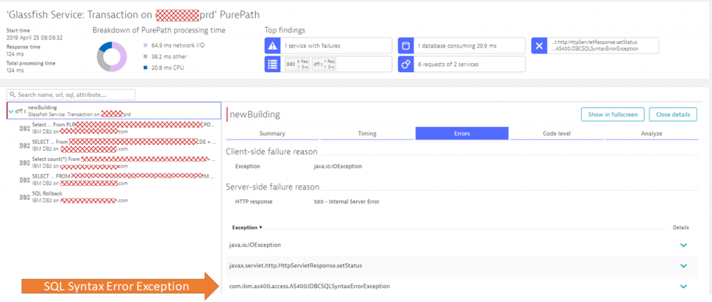

One click in the analysis tab brings us directly to one of the PurePath’s that contained that error. For those of you that are not familiar with PurePath, it is the automated End-to-End Transactional Trace that Dynatrace captures for incoming requests. PurePaths contain lots of context, error and performance information such as URL, HTTP parameters, HTTP Headers, method arguments & return values, SQL statements & bind values, exceptions and more. If you want to learn more about PurePaths, check my Performance Clinics on Basic & Advanced Diagnostics where I give hands-on tips on how to best leverage this data for diagnostics purposes.
For the customer, it was easy to spot the root cause as it is highlighted in the PurePath view. The incoming request to newBuilding made a couple of SQL Calls to the backend DB2 database. One of these calls failing with a SQL Syntax Error Exception (AS400JDBCSQLSyntaxErrorException) which ultimately led to the HTTP 500 Response to the end user:
The PurePath shows us all details about the incoming requests, all execute SQL Statements and the exceptions were thrown in this transaction.

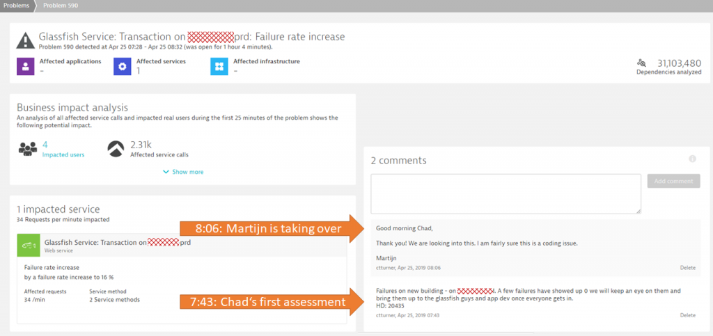

8:06 am – Development Team is taking over
Dynatrace problem tickets are not only easy to share (simply share the unique link), they also provide a simple, yet powerful comment feature – allowing you to keep track of who is working on a problem ticket.
As explained in this blog post – this feature allows this customer to easily communicate status to his management team who is actively looking at Dynatrace problems through the Dynatrace Mobile App. The following shows Problem 590 with two comments posted:
  1. Highlight that the problem was already analyzed and that it will be brought to the attention of Dev.
  2. Confirming that this most likely is a coding issue and that the team is working on it.
Simple but powerful: comments keep track of activities as different teams work on a problem

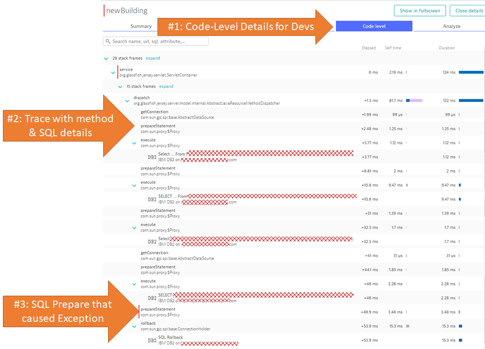

The Dynatrace PurePath provides an End-to-End trace for developers to immediately understand which SQL statement actually caused the SQL Syntax Exception as you can see in the next screenshot:
Dynatrace PurePath shows trace details and tells the developers which SQL Statement caused the Exception
Tip: The Dynatrace OneAgent automatically provides very detailed information on method executions, SQL statements or Exceptions. The screenshot you see above was captured without any additional configuration. In case you want the OneAgent to capture specific method arguments, return values or any other context data you can configure this through a feature we call Request Attributes. If you want to learn more check out my Performance Clinic Tutorial on Mastering Request Attributes.
