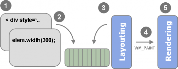

The normal flow when a document gets loaded is to incrementally build up a DOM tree, perform layout calculations of the elements and finally draw the document. Internet Explorer does this by parsing the HTML and CSS code, during which it schedules layout tasks. After the document (or part thereof) has been parsed, it sends itself a message that the scheduled layout tasks should be performed. When this message is handled by the process’ message handling mechanisms, Internet Explorer iterates the queued layout tasks and performs the necessary calculations. It then invalidates regions of the window that need to be redrawn and the Windows graphics system sends the window a message of type WM_PAINT which tells the window to repaint itself [3]. Note that the document gets repainted even if nothing visible changed, for example if the dimensions of an element with the style “display: none” changed, Internet Explorer will still redraw the entire visible portion of the document.  The figure below shows a schematic drawing of the Internet Explorer rendering process.
rendering
Steps in Internet Explorer Rendering and Layout

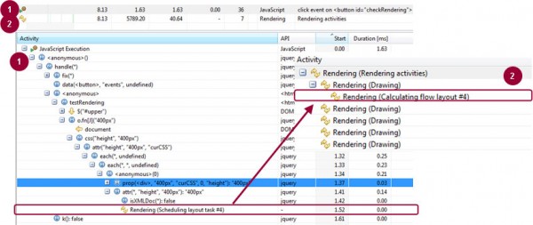

We simply create two div elements lower and upper and define a button with a click handler which changes the height of the first div. Below we see a trace of a button click in dynaTrace AJAX Edition which shows the execution of the button click handler (1) including the scheduling of the rendering task. The next path then shows the actual rendering task (2).
Rendering after changing width of a div
This also has some implications on performance analysis. If we would just measure the JavaScript execution time we would miss all rendering information. Consequently plain JavaScript instrumentation based performance analaysis cannot measure end user performance. Additionally this information is highly valuable in automated testing. When measuring rendering times during automated tests we can also detect regressions in end user performance.

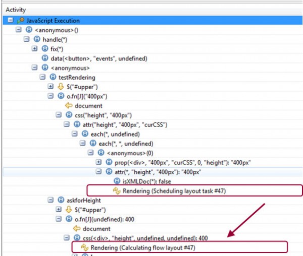

We now  access the height property of the lower div after the upper div’s height was modified. The difference – as we see below – is that rendering is now performed immediately when the property is accessed.
Immediate layout calculation due to property access
Why does this happen, especially as the property change on the upper div element has no effect on the lower div element? When the height property of the lower div element is accessed Internet Explorer realizes that there is a scheduled layouting task. As this task might – and most likely will – change layout properties of other elements it is performed before layouting-related information is returned by the DOM call.

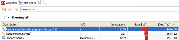

Analyzing rendering problem can be quite tough. I will explain how to use dynaTrace AJAX Edition based on real world sample. The starting point for Rendering analysis is the HotSpot View. Here we see which methods consume most of the time. In many cases this will be Rendering(Drawing). Don’t be scared this is quite normal and only means that most time when the browser is actively working is used for drawing.  However if – as in the case below – most of the time is spent for Rendering (Calculating …). This is a sign that obviously a  high number of layouting tasks are performed.  In the sample below we see that layout calculation is by far the top performance Hot Spot.
Layouting as performance hot spot

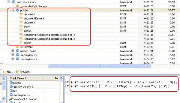

In order to find out more details we look at the backtrace and see that these layouting tasks are called within a function which performs massive DOM property access. In the source pane we see also see the source code where the sroll properties are accessed.
Property access forces rendering
