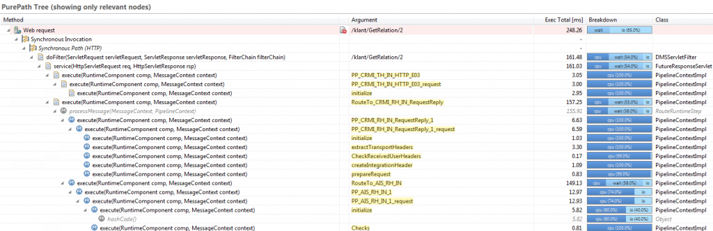

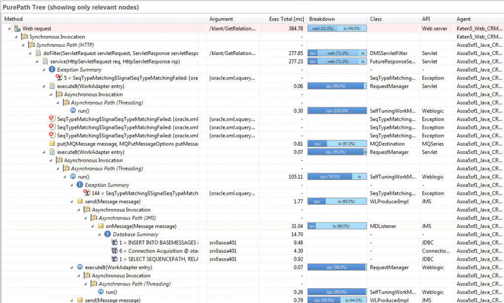

 In the following screenshot one can see all of the exceptions, response time and much more of a transaction, but the data cannot be related back to the developers of the application. The developers never wrote any code, they dragged and dropped elements in a graphical interface.
Out of the box PurePath

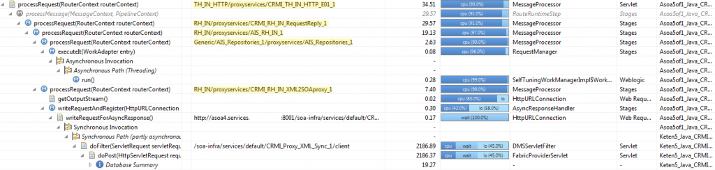

Once the sensor is added the PurePath tree will contain all of the stages which the request is using. Doing this it becomes clear which stage is responsible for which part of the PurePath.
PurePath with stage information
