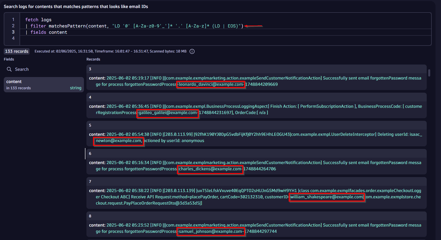

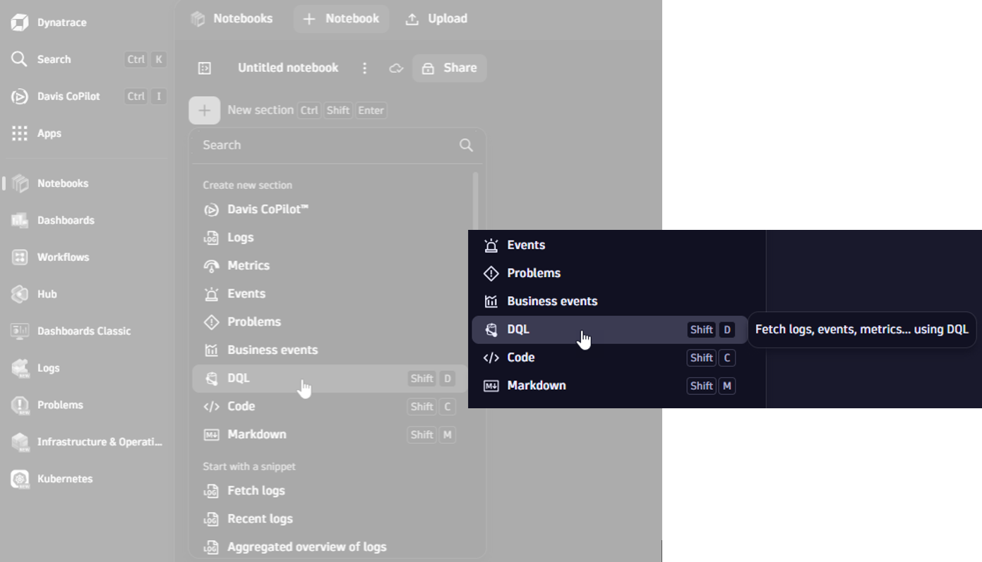

We can use the Notebooks app to query stored logs and search for log lines that contain email addresses. To do so, we create a new notebook, add a DQL section, and execute the following command:
Adding a DQL section in Dynatrace Notebooks app
Figure 1- Adding a DQL section by selecting “+ New section” and “DQL” or using the shortcut “Shift + D”

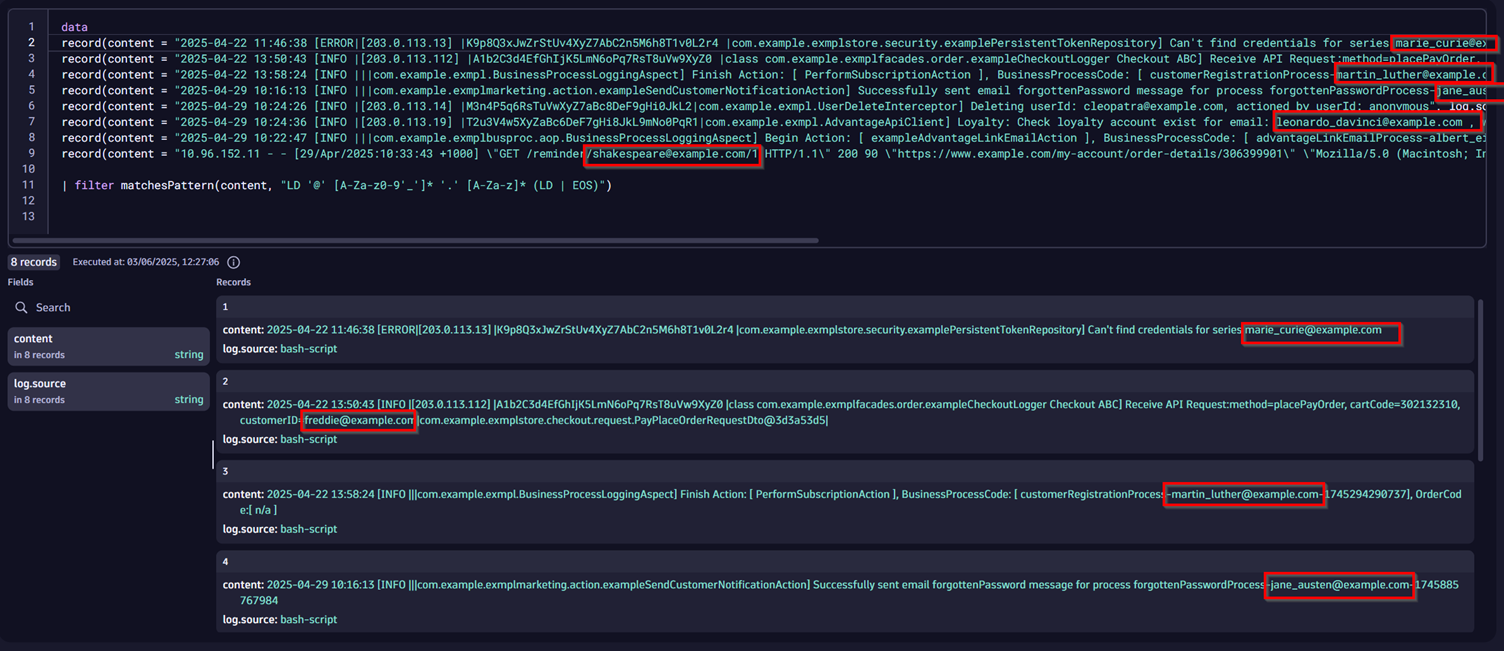

fetch logs
| filter matchesPattern(content, "LD '@' [A-Za-z0-9'_']* '.'
[A-Za-z]* (LD | EOS)")
The second part of this command executes a pattern matching command, which makes use of the Dynatrace Pattern Language (DPL) to define the pattern and reduces the result to show only those entries that contain an email address.
Resulting set of log entries identified containing email addresses
Figure 2 – Resulting set of log entries identified containing email addresses.

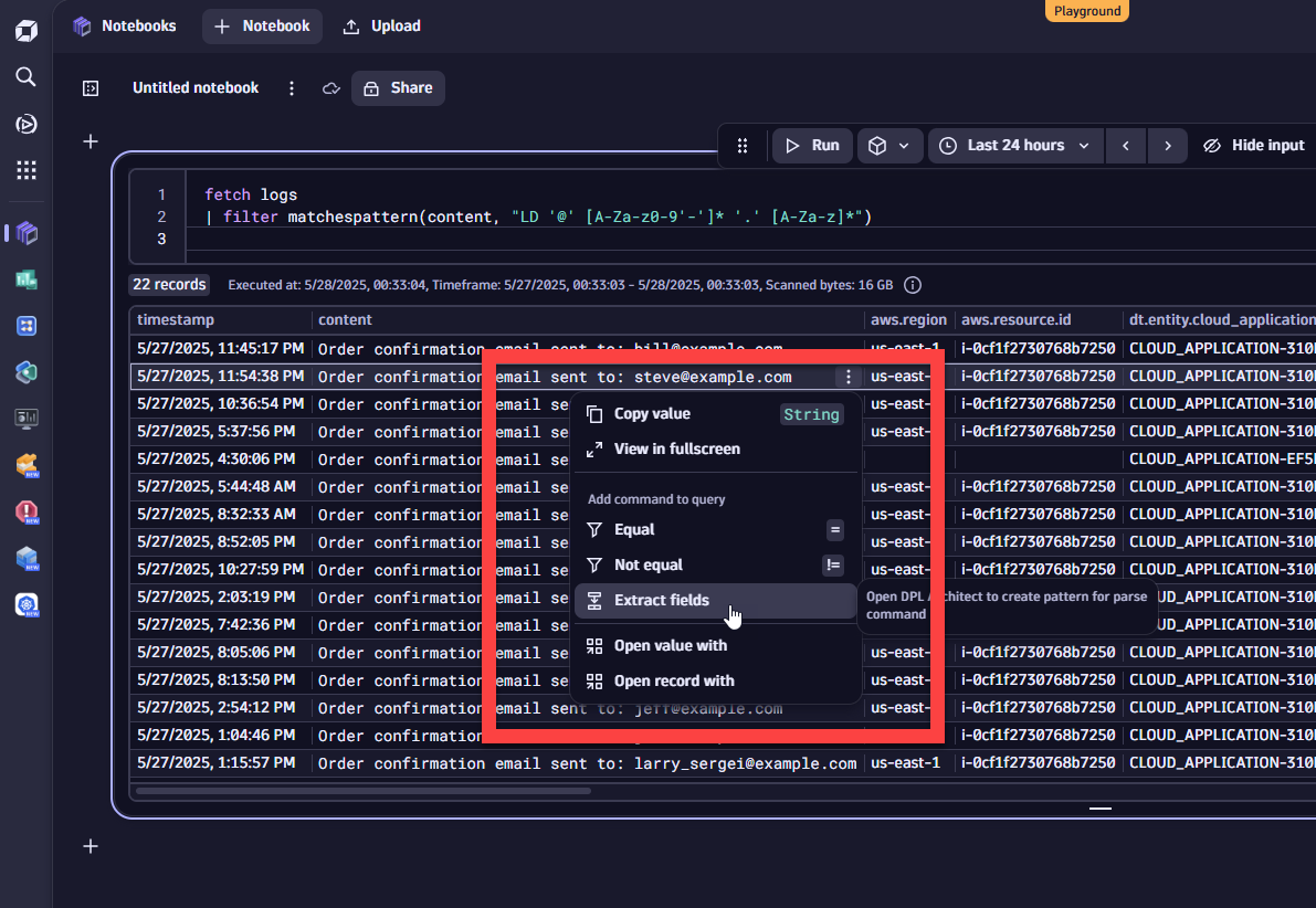

Step 4: Check the pattern to test the process of masking the email addresses
We will now parse the email addresses and mask the local part (before the @ symbol) using Dynatrace Query Language (DQL). This is parsing at query time to test whether the pattern is valid or not. It does not change or update the unmasked data that is already stored in Grail. This step ensures that the pattern we’ll be using in the following steps with OpenPipeline are valid. To achieve this, we must open the DPL architect by selecting the 3 dots on the right hand of a row-element in the content column and select “Extract fields.”
Extract fields option in Dynatrace Notebooks app
Figure 3 – Extract fields option is selected from the row item menu.

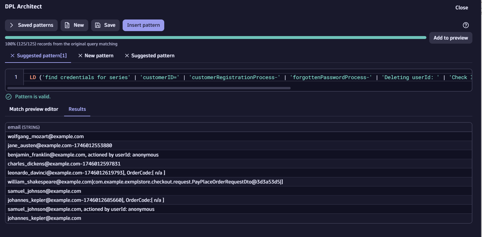

Parse the email field
We will use the following parsing pattern with DQL to extract email addresses based on the literals identified:
Pattern:
LD
'order confirmation email sent to' |
'find credentials for series' |
'customerID=' |
'customerRegistrationProcess-' |
'forgottenPasswordProcess-' |
'Deleting userId: ' |
'Check loyalty account exist for email: ' | 'advantageLinkEmailProcess-' |
'GET /reminder/') LD:email
Breakdown:
  • LD
    Matches any non-whitespace characters before the literal.
  • ('Can't find credentials for series' | ...)
    Matches any of the specified literals.
  • LD:email
    Captures the email address into a field named email.

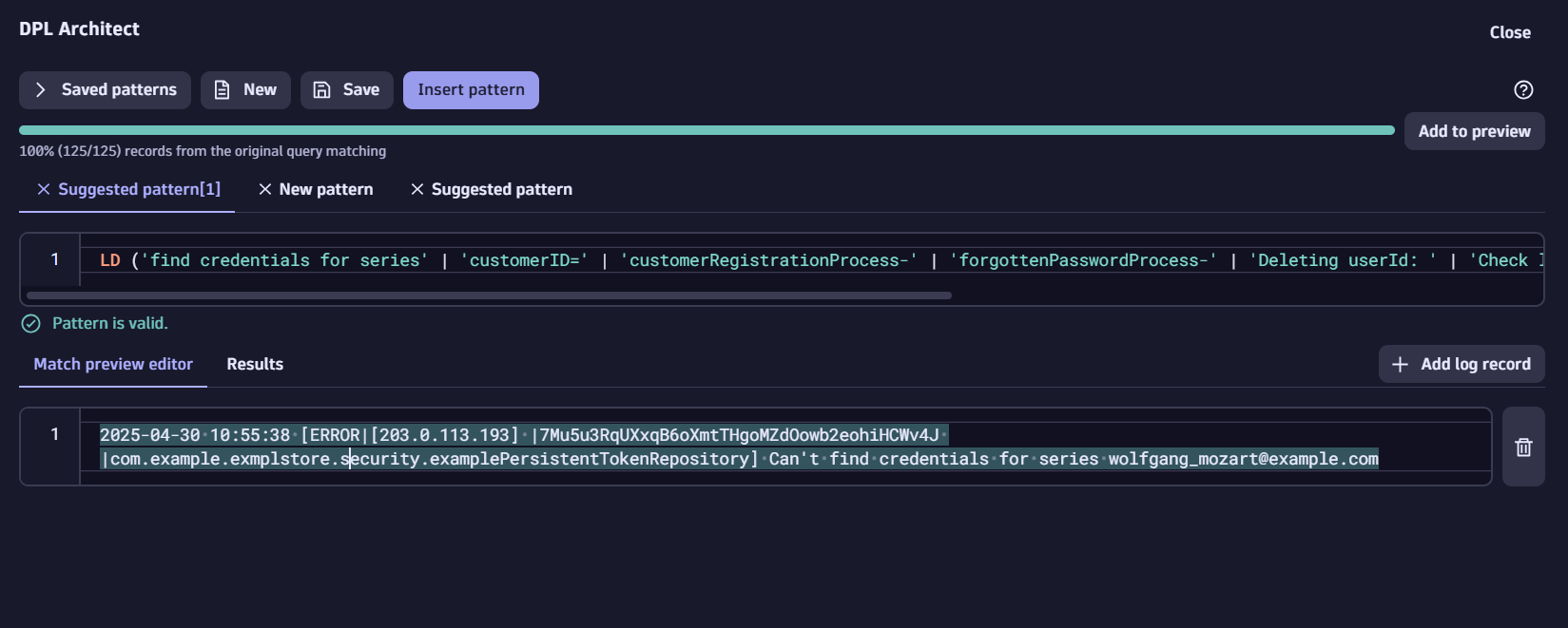

Validate the parsing rule using DPL architect in Dynatrace Notebooks by pasting the parse command (starting with LD):
DPL Architect with pattern detection sample in Dynatrace Notebooks app
Figure 4 – DPL Architect with pattern detection sample.

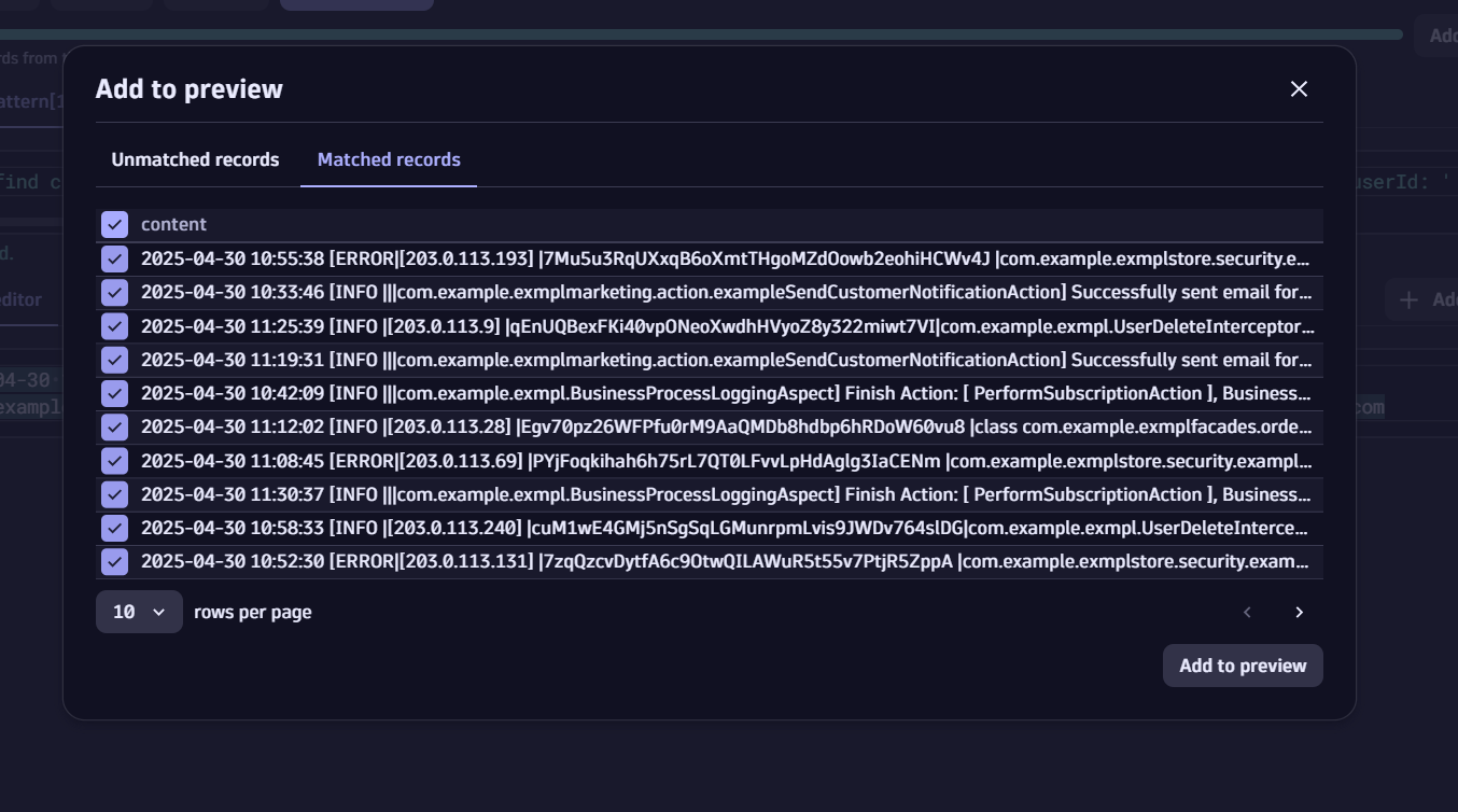

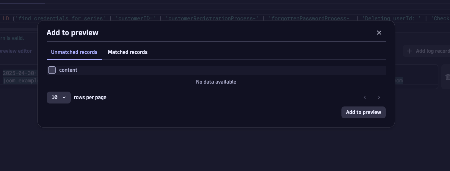

Make sure you select the ‘Add to preview’ action button to ensure there are no “Unmatched records” and all the matched records based on the previous filter can be truly passed:
Unmatched records view in Dynatrace Notebooks app
Figure 5 – Unmatched records view is empty, ensuring that no log items are missed by the parsing rule.
Matched records in Dynatrace Notebooks app
Figure 6 – Matched records view validates all records are selected.
Email addresses capture enabled in Dynatrace Notebooks app
Figure 7 – validate that you are able capture the email addresses.

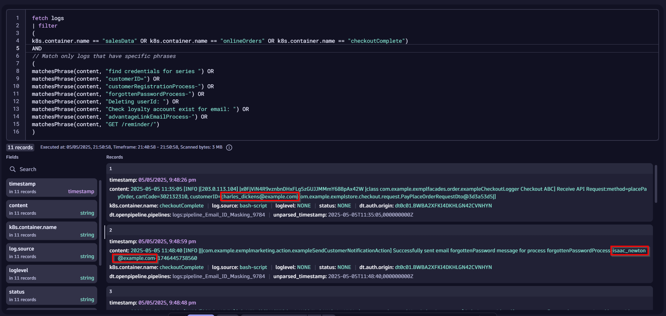

Test the process of masking the email
In the screenshot below, you can notice that the logs do contain unmasked email addresses:
Unmasked email addresses detected in Dynatrace Notebooks app
Figure 8 – Unmasked email addresses detected.

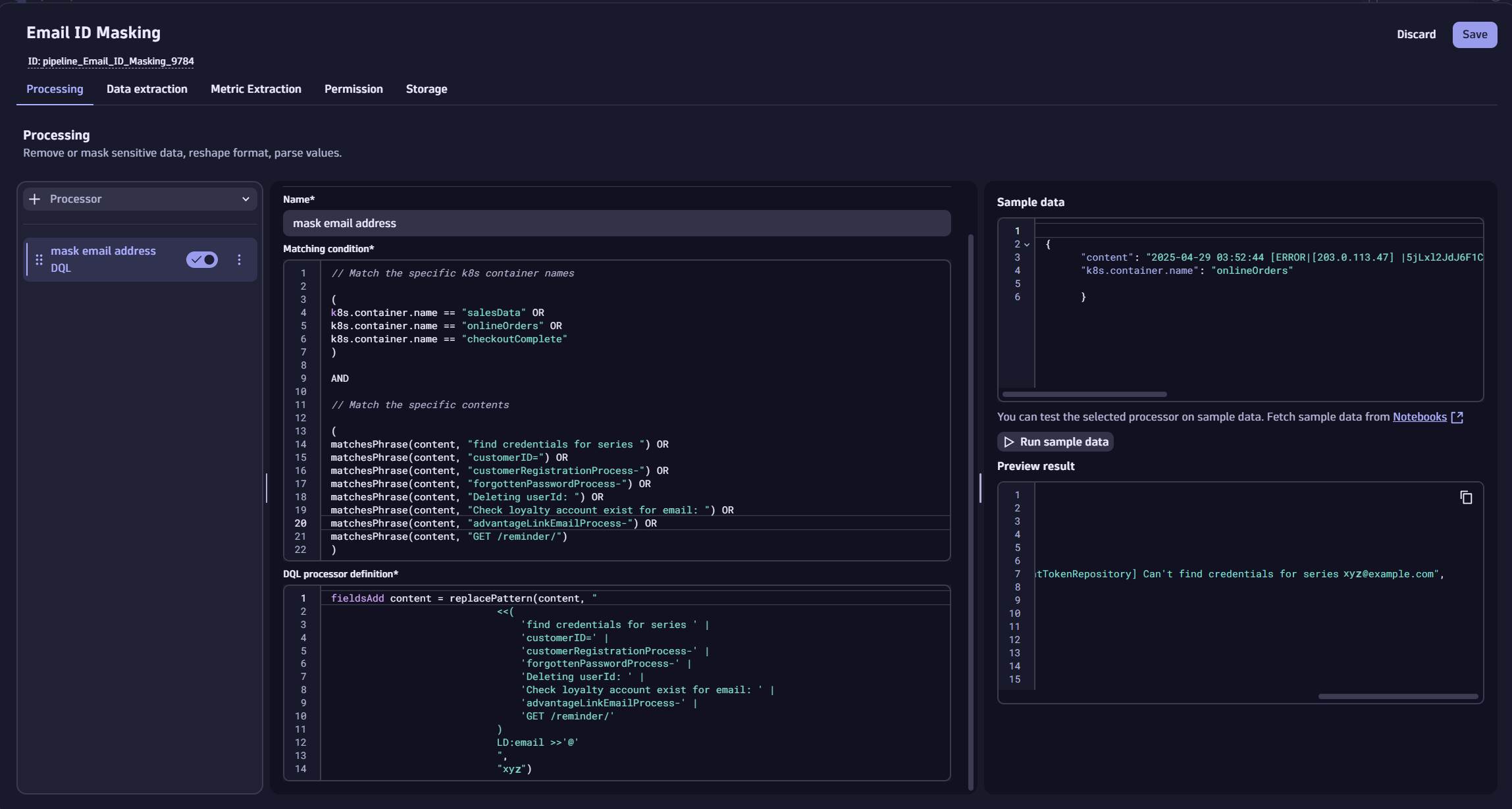

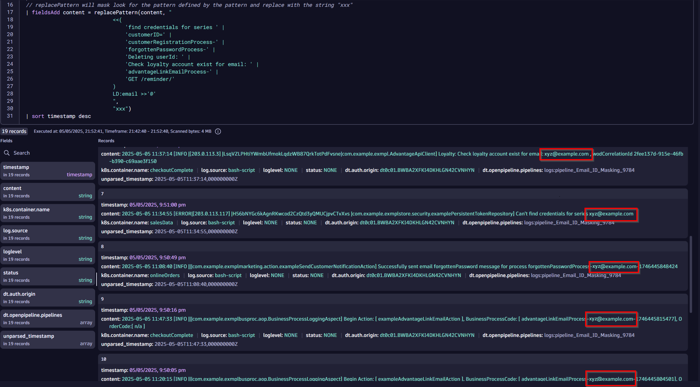

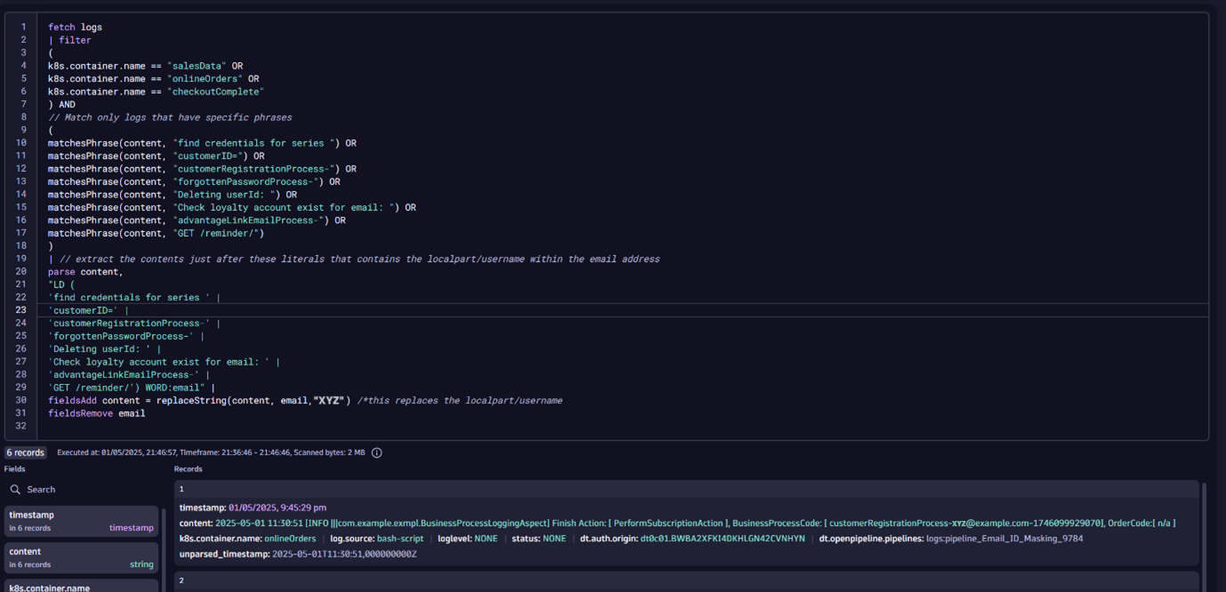

Test replacing and obfuscating the email address in the log content with a masked value (e.g., xyz):
Add below your existing query the fieldsAdd operation:
| fieldsAdd content = replacePattern(content,
'find credentials for series ' |
 'customerID=' |
 'GET /reminder/'
) LD:email
“xyz”)
This replaces the email address (stored in the email field) with xyz in the content field.
Masked email addresses in Dynatrace Notebooks app
Figure 9 – Email addresses are masked at query time with xyz value for testing and masking validation.
What it does:
This DQL command modifies the content field in a Dynatrace log record by replacing specific patterns defined – email addresses in this case – with the defined string “xyz”.

    • Before: customerID=marie_currie@example.com
    • After: xyz@example.com
  3. fieldsAdd content = …:
    The modified content (with the email local part masked) is stored back into the content field, overwriting the original value.

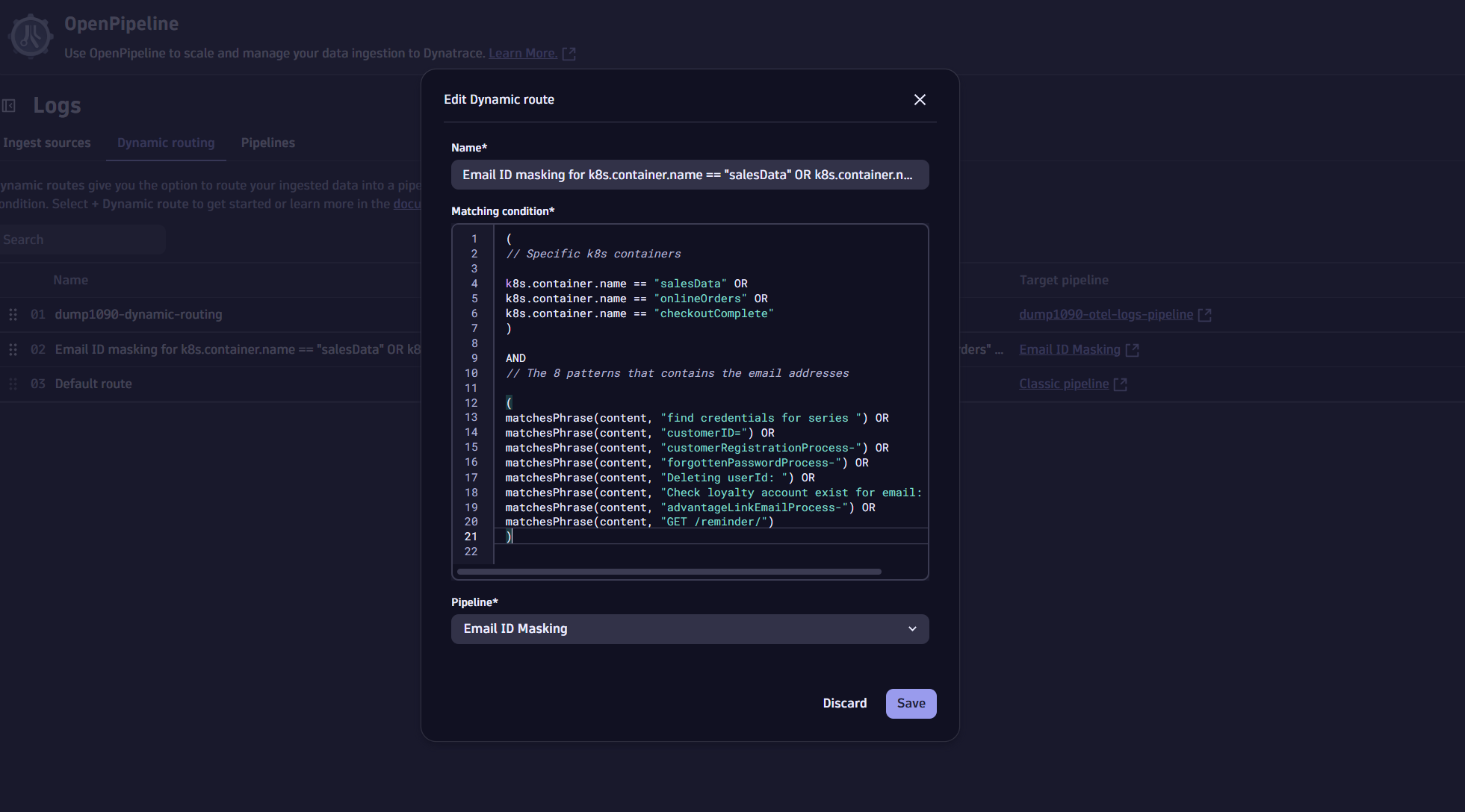

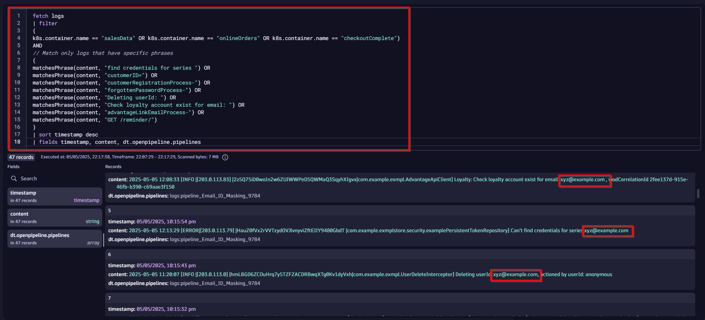

Step 5: Filter logs to avoid unintended masking
To ensure we only mask logs from specific sources and pattern containers, apply additional filters to isolate those logs only.
As a best practice, you should pre-filter your logs, by applying this filter directly underneath your fetch logs statement.
Filter by Container Names:
| filter k8s.container.name == "checkout"
OR k8s.container.name == "astroshop"
OR k8s.container.name == "aks-playground"
Filter by Content Patterns:
filter
matchesPhrase(content, "find credentials for series ") OR
matchesPhrase(content, "order confirmation email sent to ") |
matchesPhrase(content, "customerID=") OR
matchesPhrase(content, "customerRegistrationProcess-") OR
matchesPhrase(content, "forgottenPasswordProcess-") OR
matchesPhrase(content, "Deleting userId: ") OR
matchesPhrase(content, "Check loyalty account exist for email: ") OR
matchesPhrase(content, "advantageLinkEmailProcess-") OR
matchesPhrase(content, "GET /reminder/")
AND
// Match only logs that have specific phrases
matchesPhrase(content, "order confirmation email sent to ") OR
| // extract the contents just after these literals that contains the localpart/username within the email address and replace the pattern that comes after these strings.
'customerID=' |
 'GET /reminder/'
) LD:email
“xyz”)
Store this query in a Dynatrace Notebook for future reference, and feel free to select the Run button to validate that the output matches your expectations.
Result validation in Notebook app
Figure 10 – Result validation in Notebook.
All our earlier steps did not actually mask the incoming logs, but applied our masking at read/query, and secondly, just for us as the users of the Notebook.
The Notebook and its DQL snippet simply masked the data we visualized. Although this is useful for preventing users from displaying unmasked data when automated, it is even better if logs with PII are masked during ingest time.
Now that we have validated that our pattern works, we can use OpenPipeline to ensure that any log matching the DQL processor rule will undergo a series of processes that transform the log events during the ingest process.
Step 6: Set up OpenPipeline for real-time masking
Let’s configure OpenPipeline to mask email addresses at log ingestion.
  1. Launch OpenPipeline in Settings app: Navigate to OpenPipeline using search or the CTRL+K shortcut. Then select Logs from the OpenPipeline menu.
  2. Create a New Pipeline:
    • Go to Pipelines and create a new pipeline.
    • Provide a meaningful name (e.g., “Mask Email Addresses”).
    • In the Processing tab, add a DQL processor.
  3. Configure the DQL Processor:
    • Name the processor (e.g., “mask email address in astroshop OR checkout OR aks-playground”).
    • Replace the default matching condition true with our patterns defined:
      k8s.container.name == "astroshop" OR
      k8s.container.name == "checkout" OR
      ) AND
      matchesPhrase(content, "order confirmation email sent to ") OR matchesPhrase(content, "find credentials for series ") OR
    • Define what action should be applied when the condition matches, by defining the DQL processor:
       'order confirmation email sent to ' |
       'customerID=' |
       'GET /reminder/'
      ) LD:email
      “xyz”)
Email ID masking in Dynatrace Notebooks app
While it is suggested to test your new masking with sample data, you can alternatively input ‘example’ as text and select to save the processor and pipeline, as we have validated them earlier in our Notebook.
4. Set up and define Dynamic Routing:
  • Select the Dynamic routing tab
  • Create a new Dynamic route named “Email ID masking for specific container names.”
  • Use the same condition as the matching condition before.
  • Connect the route to the pipeline you’ve just created.
Matching conditions in Dynatrace OpenPipeline with Dynamic Routing
Figure 12 – Matching conditions in Dynatrace OpenPipeline with Dynamic Routing
Once configured and saved, OpenPipeline will automatically mask email addresses during ingestion.
Step 7: Validate the masking
To confirm the email addresses are masked:
  1. Re-run the DQL query in your Dynatrace Notebook, but this time without the parsing.
  2. Check the content field in the logs to ensure email addresses are replaced with xyz.
For example, marie_currie@example.com should now appear as xyz@example.com.
We can verify this by looking for these logs, and we can observe that the email addresses have been fully masked without any parsing at query time. Additionally, you can notice that the logs have the dt.openpipeline.pipelines attribute attached with the pipeline that was used during ingest time. This also confirms that the log was processed in that pipeline.
Processed logs in Dynatrace Notebooks app

Addendum: Exploring this approach in the Dynatrace Playground tenant:
A sample dataset, preloaded with tailored pattern matching and masking for the following steps and explanations, is available in the Dynatrace Playground tenant within this Dynatrace Notebook for hands-on exploration.
The individual steps can also be observed in the playground tenant with the logs ingested from the astroshop demo, while unfortunately, you lack the permissions to configure new pipelines and processors in Playground tenant.
If you look to test this within your personal tenant or a free trial tenant without actual logs containing PII, or running Astroshop yourself, you can download a copy of this Notebook or test with the pattern below, using the data command to generate sample data in a Dynatrace Notebook.
data
record(content = "2025-04-22 11:46:38 [ERROR|[203.0.113.13] |K9p8Q3xJwZrStUv4XyZ7AbC2n5M6h8T1v0L2r4 |com.example.exmplstore.security.examplePersistentTokenRepository] Can't find credentials for series marie_curie@example.com", log.source = "bash-script"),
record(content = "2025-04-22 13:50:43 [INFO |[203.0.113.112] |A1b2C3d4EfGhIjK5LmN6oPq7RsT8uVw9XyZ0 |class com.example.exmplfacades.order.exampleCheckoutLogger Checkout ABC] Receive API Request:method=placePayOrder, cartCode=302132310, customerID=freddie@example.com|com.example.exmplstore.checkout.request.PayPlaceOrderRequestDto@3d3a53d5|", log.source = "bash-script"),
record(content = "2025-04-22 13:58:24 [INFO |||com.example.exmpl.BusinessProcessLoggingAspect] Finish Action: [ PerformSubscriptionAction ], BusinessProcessCode: [ customerRegistrationProcess-martin_luther@example.com-1745294290737], OrderCode:[ n/a ]", log.source = "bash-script"),
record(content = "2025-04-29 10:16:13 [INFO |||com.example.exmplmarketing.action.exampleSendCustomerNotificationAction] Successfully sent email forgottenPassword message for process forgottenPasswordProcess-jane_austen@example.com-1745885767984", log.source = "bash-script"),
record(content = "2025-04-29 10:24:26 [INFO |[203.0.113.14] |M3n4P5q6RsTuVwXyZ7aBc8DeF9gHi0JkL2|com.example.exmpl.UserDeleteInterceptor] Deleting userId: cleopatra@example.com, actioned by userId: anonymous", log.source = "bash-script"),
record(content = "2025-04-29 10:24:36 [INFO |[203.0.113.19] |T2u3V4w5XyZaBc6DeF7gHi8JkL9mNo0PqR1|com.example.exmpl.AdvantageApiClient] Loyalty: Check loyalty account exist for email: leonardo_davinci@example.com , wodCorrelationId 2fee137d-915e-46fb-b390-c69aae3f150", log.source = "bash-script"),
record(content = "2025-04-29 10:22:47 [INFO |||com.example.exmplbusproc.aop.BusinessProcessLoggingAspect] Begin Action: [ exampleAdvantageLinkEmailAction ], BusinessProcessCode: [ advantageLinkEmailProcess-albert_einstein@example.com-1745886166709], OrderCode:[ n/a ]", log.source = "bash-script"),
record(content = "10.96.152.11 - - [29/Apr/2025:10:33:43 +1000] \"GET /reminder/shakespeare@example.com/1 HTTP/1.1\" 200 90 \"https://www.example.com/my-account/order-details/306399901\" \"Mozilla/5.0 (Macintosh; Intel Mac OS X 10_15_7) AppleWebKit/537.36 (KHTML, like Gecko) Chrome/135.0.0.0 Safari/537.36\" 203.0.113.145 - T2u3V4w5XyZaBc6DeF7gHi8JkL9mNo0PqR1 100", log.source = "bash-script")
| filter matchesPattern(content, "LD '@' [A-Za-z0-9'_']* '.' [A-Za-z]* (LD | EOS)")
Generated demo sample data showcasing PII data found in results in Dynatrace Notebooks app
Figure 14 – Generated demo sample data showcasing PII data found in results.
