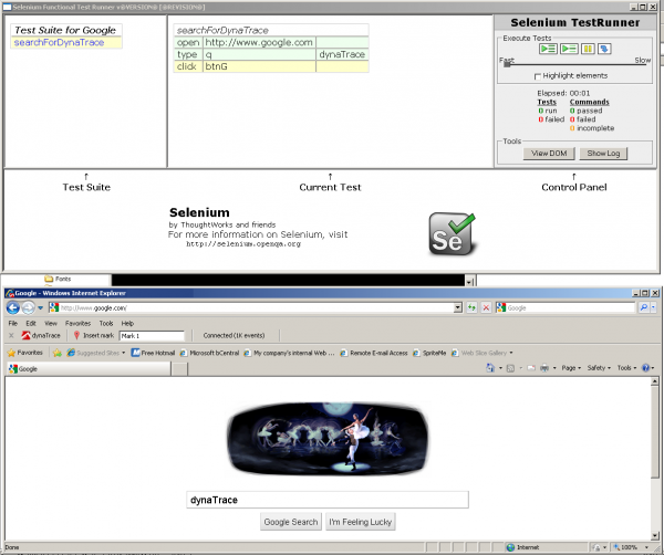

Before I run this script I make sure to launch the dynaTrace AJAX Edition. When I execute the script Selenium will launch the HtmlRunner in a separate browser instance and will then launch the browser that will execute your test steps. The second browser instance will have the active dynaTrace AJAX agent. You can tell this by the changed IE icon as well as an increasing number in the Captured Events displayed in the dynaTrace AJAX Edition IE Toolbar:
Executing an HTML Test Suite with dynaTrace AJAX capturing performance data
Note: Even though both browser instances use the DT_IE_XXX environment variables, the AJAX Edition will not collect information from the Selenium Test Runner. The Test Runner runs as an HTA Application which prevents the AJAX Edition Add-On from being loaded. In this case it is an advantage as we are not interested in the performance of the Selenium Runner.

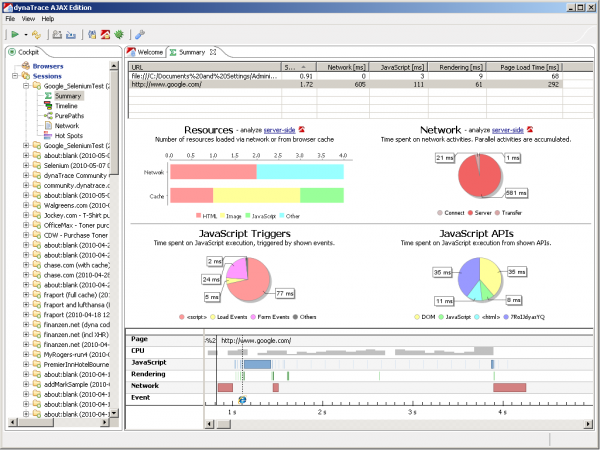

Once the test is done and the browser is closed we can explore the results captured in the dynaTrace AJAX Edition:
dynaTrace AJAX Edition captured performance data from the Selenium Test Run using the configured Session Name
The session name is the one we passed in via DT_IE_SESSION_NAME – Google_SeleniumTest in this case. You will see a URL to a local file. That is a file that Selenium opens which then actually opens the URL of the test application. Simply ignore this line and focus on those URLs of your test scenario.

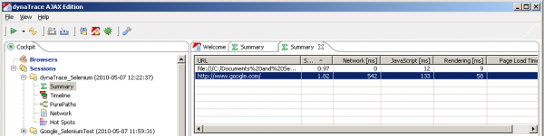

The result is the same. The Selenium server launches two browser instances. The first loads the Selenium Runner which won’t be analyzed by dynaTrace AJAX as it is an HTA Application. The second launches google.com and searches for dynaTrace. The following screenshot shows this captured session with the name dynaTrace_Selenium:
