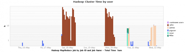

The first thing I did was look for a worthwhile job to analyze. To do this, I looked at cluster utilization broken down by user and job.
This chart visualizes the cluster CPU usage by user giving a good indication about which user executes the most expensive jobs
What I found was that John was the biggest user of our cluster. So I looked at the jobs John was running.

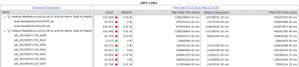

These are all the jobs that John was running over the last several days. Its always the same one, consuming about the same amount of resources
The largest job by far was an analytics simulation of a full day of measurement data.  This job is run often to test and tune changes to the analytics algorithms.  Except for one of the runs, all of them lasted about 6.5 hours in real time and consumed nearly 100% CPU of the cluster during that time. This looked like a worthy candidate for further analysis.

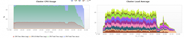

My next step was to look at a breakdown of the job from two angles: consumption and real time. From a real-time perspective, map and reduce took about the same amount of time – roughly 3 hours each. This could also be nicely seen in the resource usage of the job.
This dashboard shows the overall cluster utilization during the time the job ran. 100% of the cluster CPU is used during most of the time
The significant drop in Load Average and the smaller drop in the other charts mark the end of the mapping phase and the start of pure reducing. What is immediately obvious is that the reducing phase, while lasting about the same time, does not consume as many resources as the map phase. The Load Average is significantly lower and the CPU utilization drops in several steps before the job is finished.
On the one hand that is because we have a priority scheduler and reducing does not use all slots, but more importantly, reducing cannot be parallelized as much as mapping. Every optimization here counts two fold, because you cannot scale things away! While the mapping phase is clearly consuming more resources, the reducing phase is a bottleneck and might therefore benefit even more from optimization.

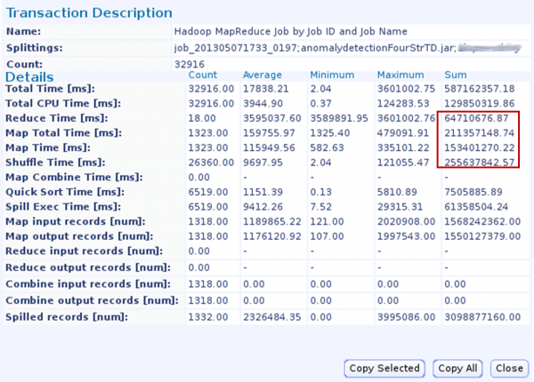

The breakdown of job phase times shows that the mapping phase consumes twice as much time as reducing, even though we know that the job real time of the two phases is about the same - 3 hours each
The breakdown of job phase times shows that the mapping phase consumes twice as much time as reducing, even though we know that the job real time of the two phases is about the same – 3 hours each
As we can see the Map Time (time we spend in the mapping function, excluding merging, spilling and combining) is twice as high as the reduce time. The reduce time here represents the time that tasks were actually spending in the reduce function, excluding shuffle and merge time (which is represented separately). As such those two times represent those portions of the job that are directly impacted by the Map and Reduce code, which is usually custom code – and therefore tuneable by our developers!

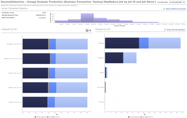

So as a next step I used Compuware APM to get a high-level performance breakdown of the job’s respective 3 hour mapping and reducing phases. A single click gave me this pretty clear picture of the mapping phase:
This is a hot spot analysis of our 3 hour mapping phase which ran across 10 servers in our hadoop cluster

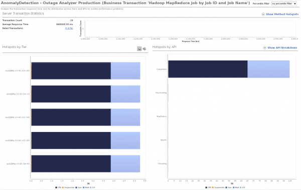

The hot spot dashboard for the mapping phase shows that we spent the majority of the time (about 70%) in our own code and that it’s about 50% CPU time. This indicates a lot of potential for improvement. Next, I looked at the reducing phase.
This hot spot shows that we spend nearly all of our reducing time in all reduce tasks in our own code!

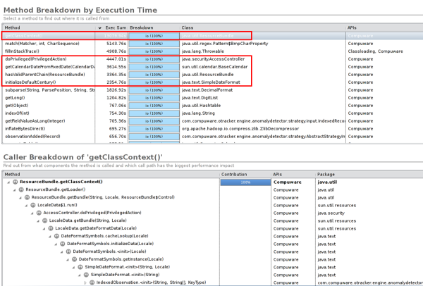

This shows that 99% of the reducing time is spent on our own code and not in any Hadoop framework.  Since the reduce phase was clearly the winner in terms of potential, I looked at the details of that hot spot – and immediately found three hot spots that were responsible for the majority of the reduce time.
Three simple code issues consume 70% of the reduce time
This is what the method hot spots dashboard for the reduce phase showed.
These are the method hot spots for the reduce phase, showing that nearly everything is down to only 3 line items
The top three items in the method hot spot told me everything I needed know. As it turned out nearly all other items listed were sub-hotspots of the top most method:
  1. SimpleDateFormat initialization:
    The 5 items marked in red are all due to the creation of a SimpleDateFormat object. As most of us find out very painfully during our early career as a Java developer, the SimpleDateFormat is not thread safe and cannot be used as a static variable easily. This is why the developer chose the easiest route and created a new one for every call, leading to about 1.5 billion creations of this object. The initialization of the Formatter is actually very expensive and involves resource lookups, locale lookups and time calculations (seen in the separate line items listed here). This item alone consumed about 40% of our reduce time.
    Solution: We chose to use the well-known Joda framework (the code replacement was easy) and made the Formatter a static final variable; totally removing this big hot spot from the equation.
  2. Regular Expression Matching (line two in the picture)
    In order to split the CSV input we were using java.lang.String.split. It is often forgotten that this method uses regular expressions underneath. RegEx is rather CPU intensive and overkill for such a simple job. This was consuming another 15-20% of the allotted CPU time.
    Solution: We changed this to a simple string tokenizer.
  3.  Exception throwing (line three in the picture)
    This example was especially interesting. During the reading of input data we are parsing numeric values, and if the field is not a correct number java.lang.Long.parseLong will throw a NumberFormatException. Our code would catch it, mark the field as invalid and ignore the exception. The fact is that nearly every input record in that feed has an invalid field or an empty field that should contain a number. Throwing this exception billions of times consumed another 10% of our CPU time.
    Solution: We changed the code in a way to avoid the exception altogether.
And there we have it – three simple hot spots were consuming about 70% of our reduce CPU time! During analysis of the mapping portion I found the same hot spots again, where they contributed about 20-30% to the CPU time.

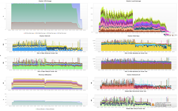

The result of the modified code exceeded our expectations by quite a bit! The immediate changes saw the job time reduced by 50%. Instead of lasting about 6.5 hours, it was done after 3.5! Even more impressive was that while the mapping time only went down by about 15%, the reducing time was slashed from 3 hours to 30 minutes!
This is the jobs cluster CPU Usage and Load Average after we made the changes
The Cluster Utilization shows a very clear picture. The overall utilization and load average during mapping phase actually increased a bit and instead of lasting 3 hours 10 minutes it was done after 2 hours and 40 minutes. While not huge this is still a 15% improvement.
The reduce phase on the other hand shrank dramatically: from roughly 3 hours to 30 minutes! That means a couple of hours of development work lead to an impressive 6-fold performance improvement! We also see that the reduce phase is of course still not utilizing the whole cluster and its actually the 100% phase that got a lot shorter.
