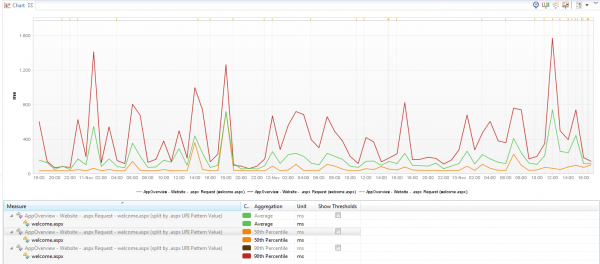

A percentile tells me at which part of the curve I am looking at and how many transactions are represented by that metric. To visualize this look at the following chart:
As you can see in the above graph, the average is very volatile. The other two lines represent the median and 90th percentile. As we can see the median is rather stable but has a couple of jumps. These jumps represent real performance degradation for the majority (50%) of the transactions. The 90th percentile (this is the start of the “tail”) is a lot more volatile, which means that the outliers’ slowness depends on data or user behavior. What’s important here is that the average is heavily influenced (dragged) by the 90th percentile, the tail, rather than the bulk of the transactions.
If the 50th percentile (median) of a response time is 500ms that means that 50% of my transactions are either as fast or faster than 500ms. If the 90th percentile of the same transaction is at 1000ms it means that 90% are as fast or faster and only 10% are slower. The average, in this case, could either be lower than 500ms (on a heavy front curve), a lot higher (long-tail), or somewhere in between. A percentile gives me a much better sense of my real-world performance because it shows me a slice of my response time curve.

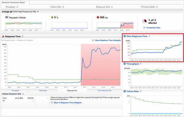

For exactly, that reason percentiles are perfect for automatic baselining. If the 50th percentile moves from 500ms to 600ms I know that 50% of my transactions suffered a 20% performance degradation. You need to react to that.
In many cases, we see that the 75th or 90th percentile does not change at all in such a scenario. This means the slow transactions didn’t get any slower, only the normal ones did. Depending on how long your tail is the average might not have moved at all in such a scenario!
In other cases we see the 98th percentile degrading from 1s to 1.5 seconds while the 95th is stable at 900ms. This means that your application as a whole is stable, but a few outliers got worse, nothing to worry about immediately. Percentile-based alerts do not suffer from false positives, are a lot less volatile and don’t miss any important performance degradations! Consequently, a baselining approach that uses percentiles does not require a lot of tuning variables to work effectively.
The following screenshot explains how percentile-based alerts do not suffer from false positives, are a lot less volatile, and don’t miss important performance degradation.
