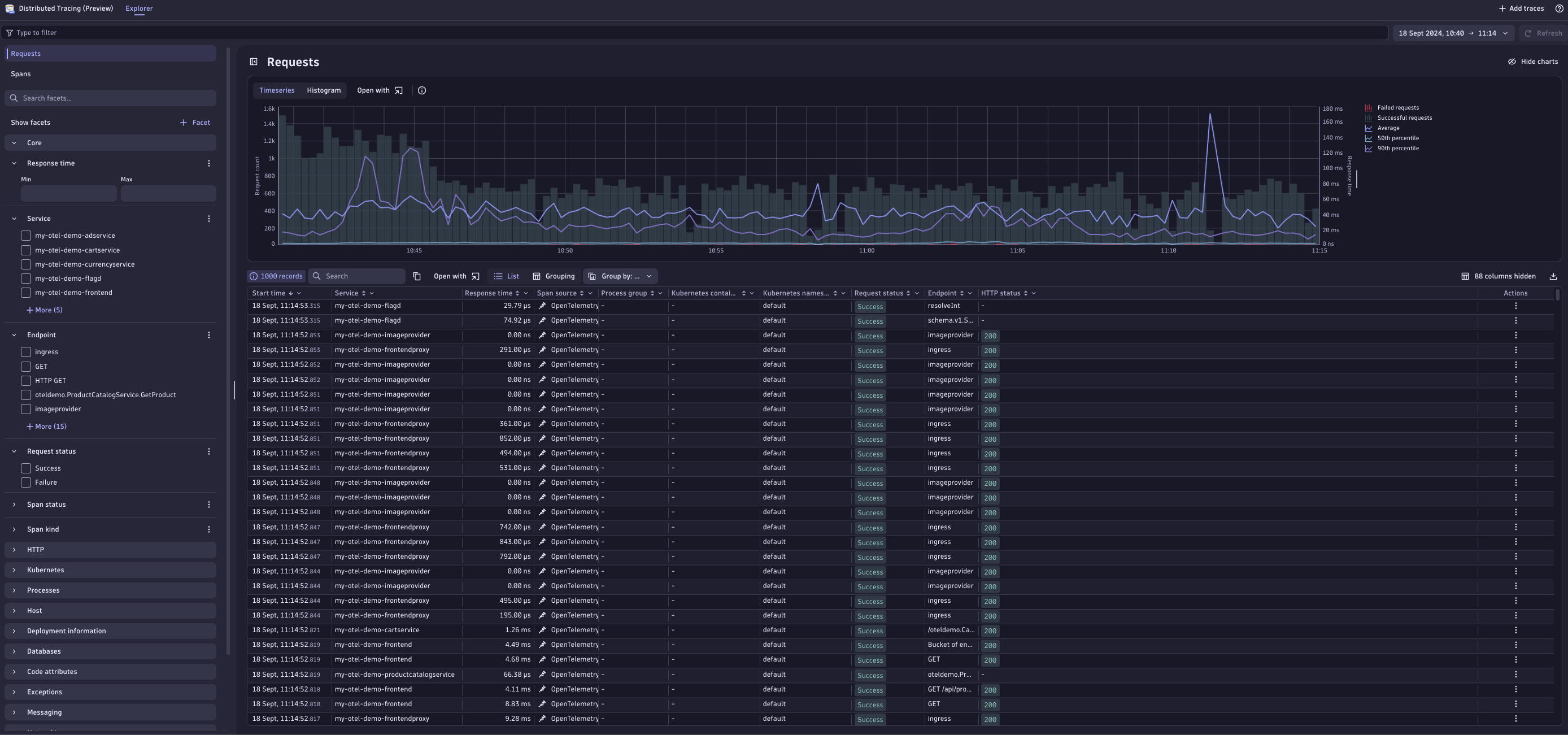

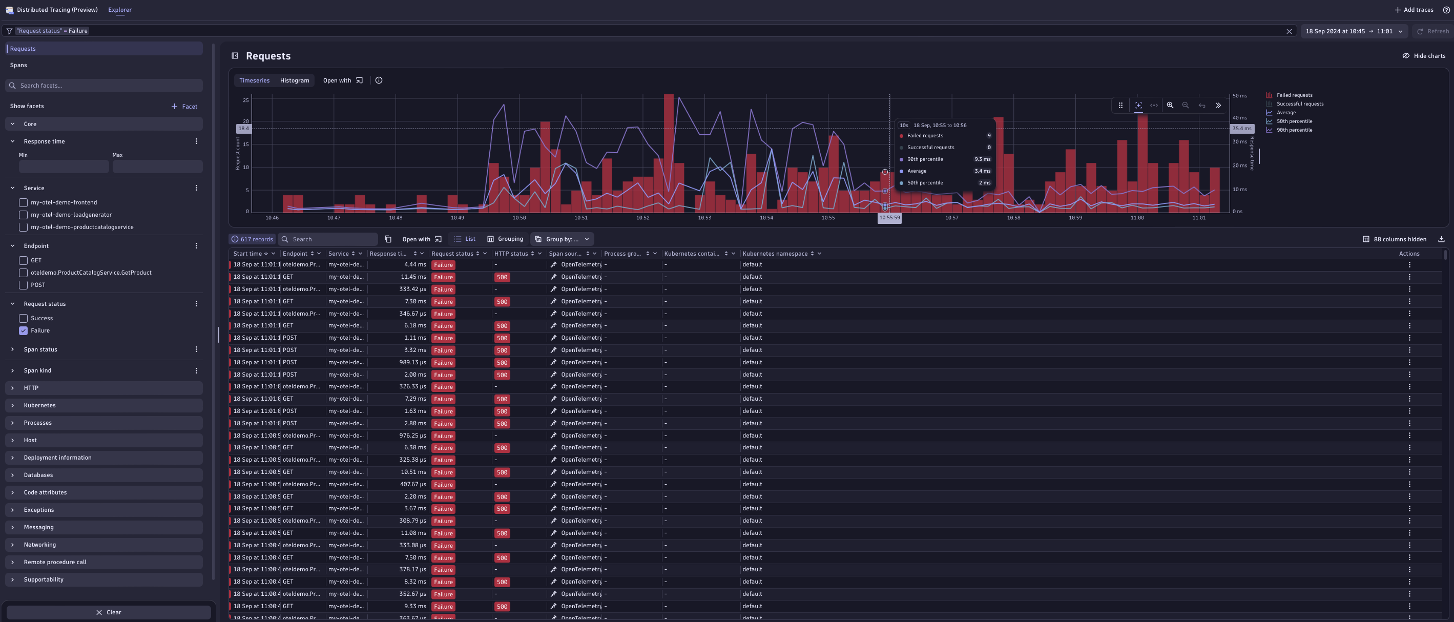

To gain insight into requests executed within the application, we can use the new Distributed Tracing app. This app provides an overview of all ingested traces within the application, including a list of the most recent traces and a time series chart representing metrics such as the response time percentiles and the number of successful and failed requests. The filtering fields on the left side make it easy to search for particular traces of interest, for example, if you want to inspect all the traces sent by a particular service.

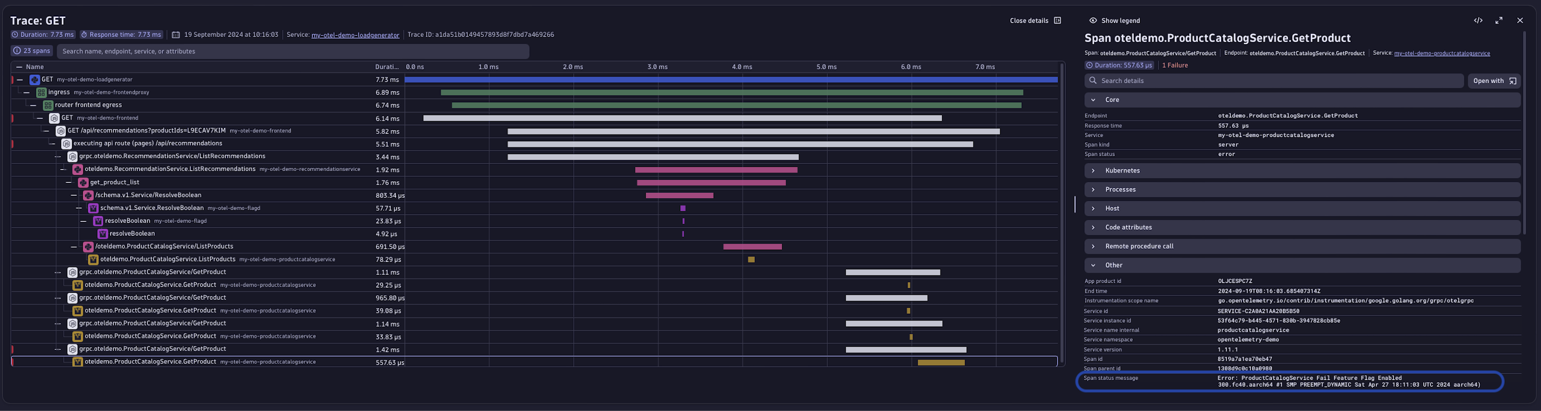

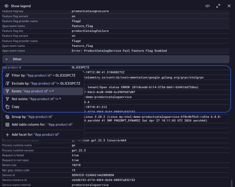

To investigate what’s happening here, we’ll open the details of one of the failed traces by selecting an entry in the span list. This leads to a detailed view of the complete trace, including all involved services in the executed request and the spans that are generated by these services.
Here we notice that the error seems to be caused by the product service, particularly instances of the GetProduct call. Select the failed span to access a detailed overview of the failed GetProduct request, including all attributes attached to the span, as well as a status description:
Here, we see that the status message indicates that the failures are related to the feature flag we changed earlier. However, not all of the GetProduct spans seem to be failing—only some.
Therefore, let’s investigate further by analyzing how certain attributes might impact the error rate. One interesting attribute to investigate is the product ID. In the example trace above, only some of the GetProduct requests failed.

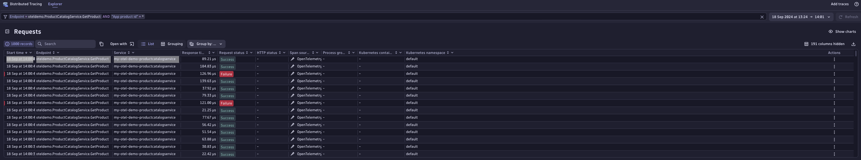

To analyze whether there is a correlation between this attribute and the failure rate, we first select the attribute and add a filter to only show traces where this attribute is available:
After applying this filter, the trace list above should only display the requests to the GetProduct endpoint of the productcatalogservice:

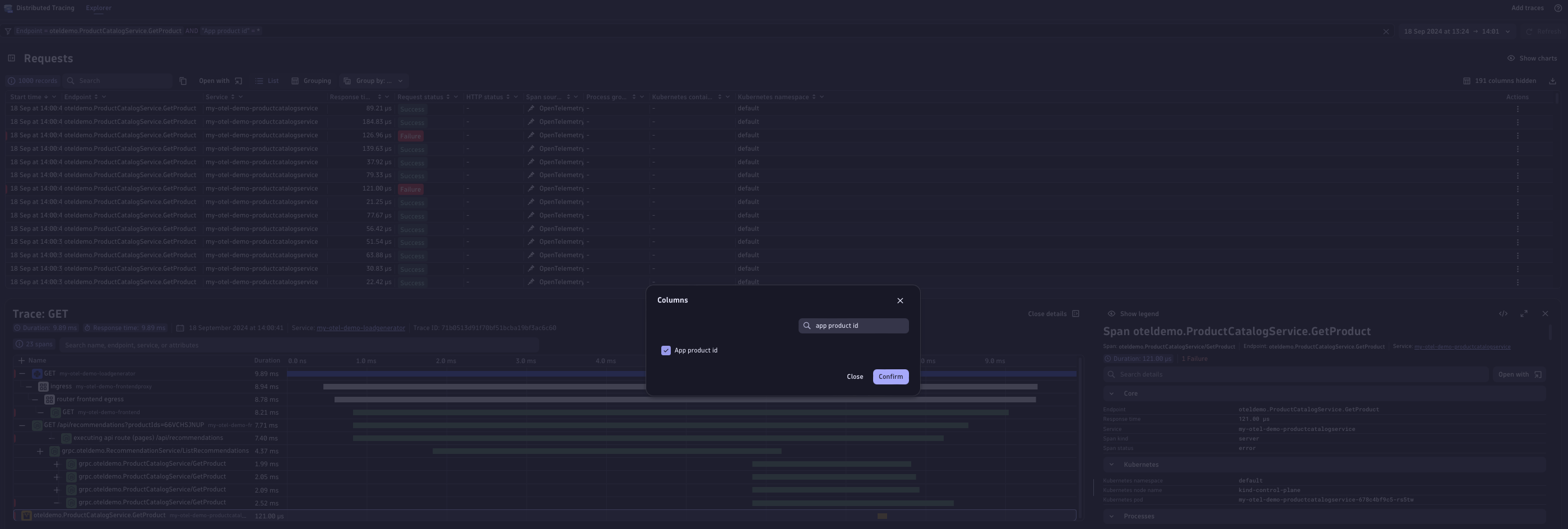

Next, we’ll add the product ID attribute to the columns of the trace list.
To do this, select the column settings at the top right of the table. Here, we’re presented with the option to add additional attributes to the column. Using the search field, let’s look for the product ID attribute and select it.

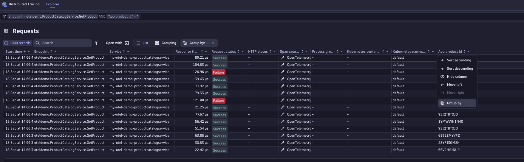

Once we’ve added the product ID attribute to the columns of the trace list, we can group the traces by that attribute. This shows us how many traces for a particular product ID were successful and how many failed.
To perform the grouping, select the header of the App product id column, and select Group By in the menu.

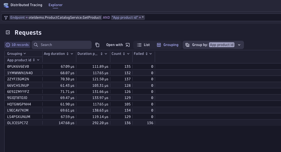

The result of this operation confirms our suspicion that there might be something wrong with a particular product, as all the errors seem to be caused by requests for a particular product ID:
