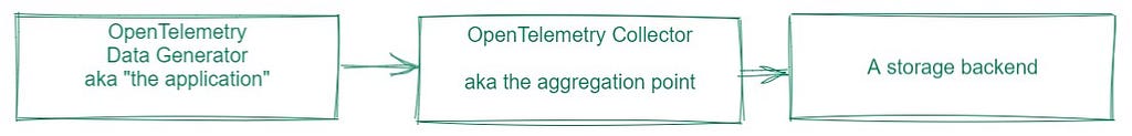

A basic OpenTelemetry setup
The most basic OpenTelemetry setup has three components:
  1. An OpenTelemetry trace generator. Usually, an application that emits OTEL data (metrics, logs, traces, etc.).
  2. An OpenTelemetry collector. The aggregation point for all that data.
  3. A storage back end. That’s where you want to send the data. In this demo, the back end will be Dynatrace.
Of course, you can have multiple components, but the above is the most basic setup.

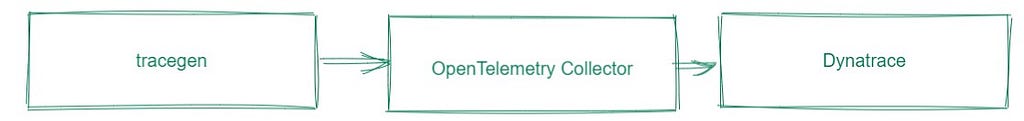

What will be built
In this demo, tracegen generates trace data that will be sent to an OpenTelemetry collector.
The collector will be configured to pass the trace data to Dynatrace.
In real life, tracegen would be replaced by your application(s). Of course, if you choose to install the OneAgent on your hosts, the OpenTelemetry collector becomes an optional component.

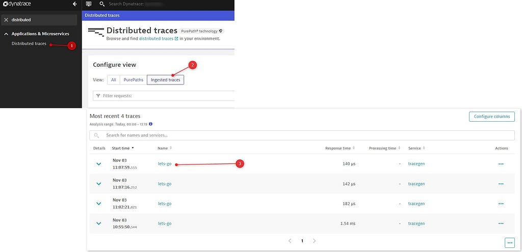

View traces in Dynatrace
Open Dynatrace, go to Distributed Traces and then toggle over to Ingested traces.
Distributed Traces in Dynatrace
In a few seconds, you should see a trace called lets-go (that’s what tracegen names the traces it sends).
