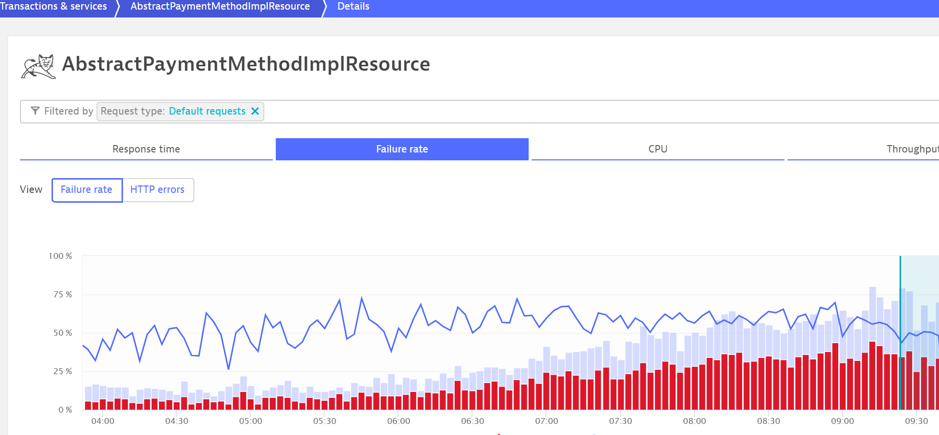

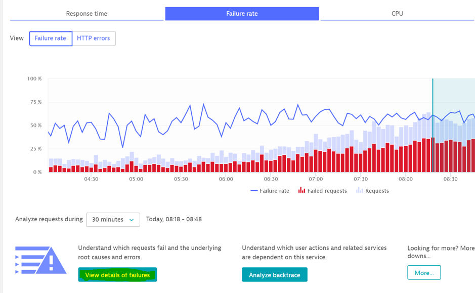

Here is an example where a service constantly reports many failures with the out of the box settings.
The error rate is around 50%. In red, we can see the number of requests where the failure has been reported against the total in blue. The line chart shows the failure rate percentage.
Because Dynatrace uses clever baselines, it will assume that it is normal and genuine issues could be missed unless the failure rate increases significantly. In the worst-case scenario, a service can report a 100% failure rate all the time so real errors will be invisible!

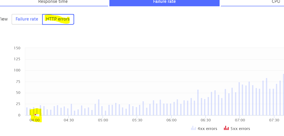

In this example, there was a genuine issue at 4:00 AM but it is buried in the noise. I have removed the noise in the screenshot below to illustrate it.
A small number of HTTP 500 errors in red were detected due to a connectivity issue with the database.

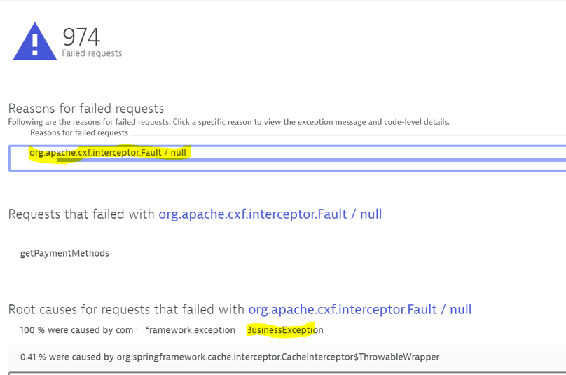

To see why Dynatrace thinks that this service is failing, let’s use the view detail of failure button.

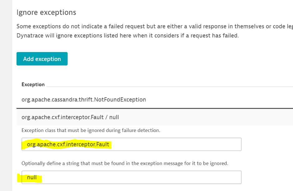

We can see that an org.apache/cxf/interceptor. Fault exception is thrown. It is a generic error handler but below we can see a business exception class. Further investigations revealed that it is a validation error which we don’t need to report.
We need to tell Dynatrace to ignore this exception because it is just noise.
On the service screen, select “…”, edit and go to the error detection screen.
Under “ignore Exceptions”, add the exception class and optionally the error message.
Save your changes and wait a couple of minutes.

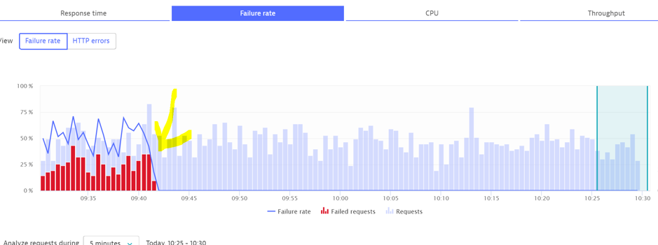

The failure rate should be reduced. We can see below that I committed the change at 9:42 and the failure rate dropped to 0.
It is important to ensure that it isn’t ignoring all the errors so check thoroughly.

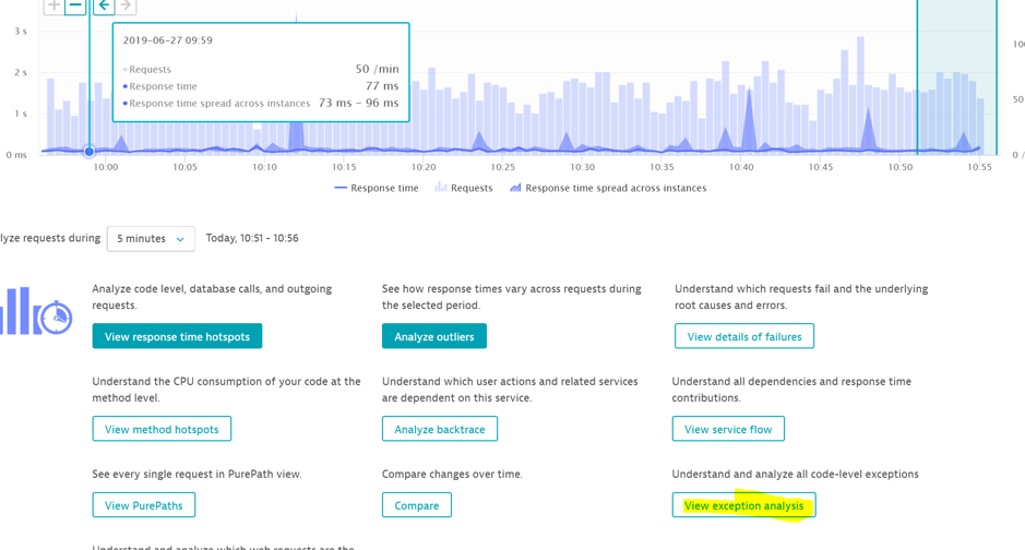

Include specific exceptions
In a similar fashion, application specific exceptions might not be reported by Dynatrace.
If the exception is gracefully dealt with (i.e. caught in developer’s speech) then Dynatrace will ignore it.
To see all the exceptions, use the “view exception analysis” button.
If you see an exception which you think is critical, add it to the error detection rules.

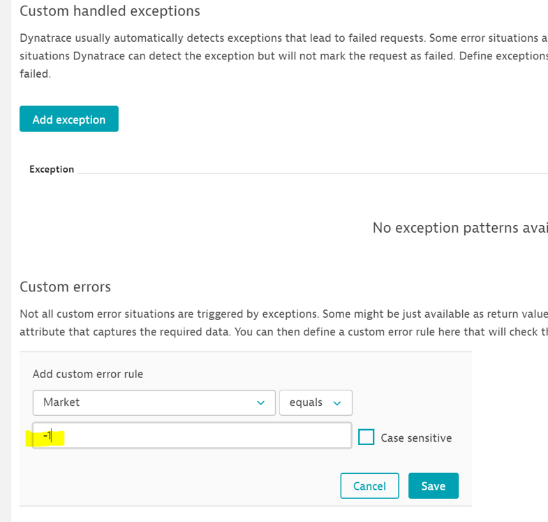

Once defined, the request attribute can be added to the error detection screen under custom errors and values can be specified.
See the example below where the request attribute called market to capture a return code and if the value is -1, Dynatrace will flag the request as a failed.

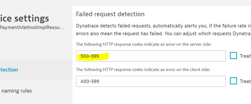

For each service, it is possible to change the way Dynatrace handles HTTP codes.
By default, Dynatrace only reports HTTP 5xx errors on entry. These codes can be amended to include or exclude specific ones.

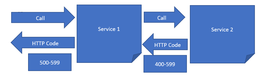

The first box lets you define codes that are seen by the caller.
The second box is for calls made to another service.
See the diagram below:
So, for instance, if service 1 is called and returns a code between 500 and 599, we have a failure.
What if the service returns an HTTP 200 we don’t. However, if service 1 calls service 2 and service 2 returns an error between 400 and 599, service 1 will be failing even if it returns an HTTP 200!
If it is not the desired outcome, change the second parameter to match your requirement.
