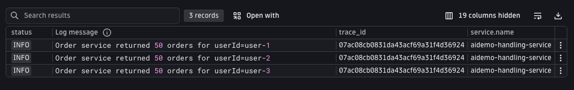

The catch: Unpredictable bugs in production
Our function looks much better, but when you ship it you start seeing this in your observability data:
traces
Dynatrace Observability
The downstream service paginates at 50 orders. The function returns the first page only and silently drops the rest. No test or review caught it. No skill covered it.
This is the class of bug that lives outside your codebase and outside your team’s documented knowledge. It only exists in the runtime behavior of the system. But what if the AI could verify its code against runtime information?

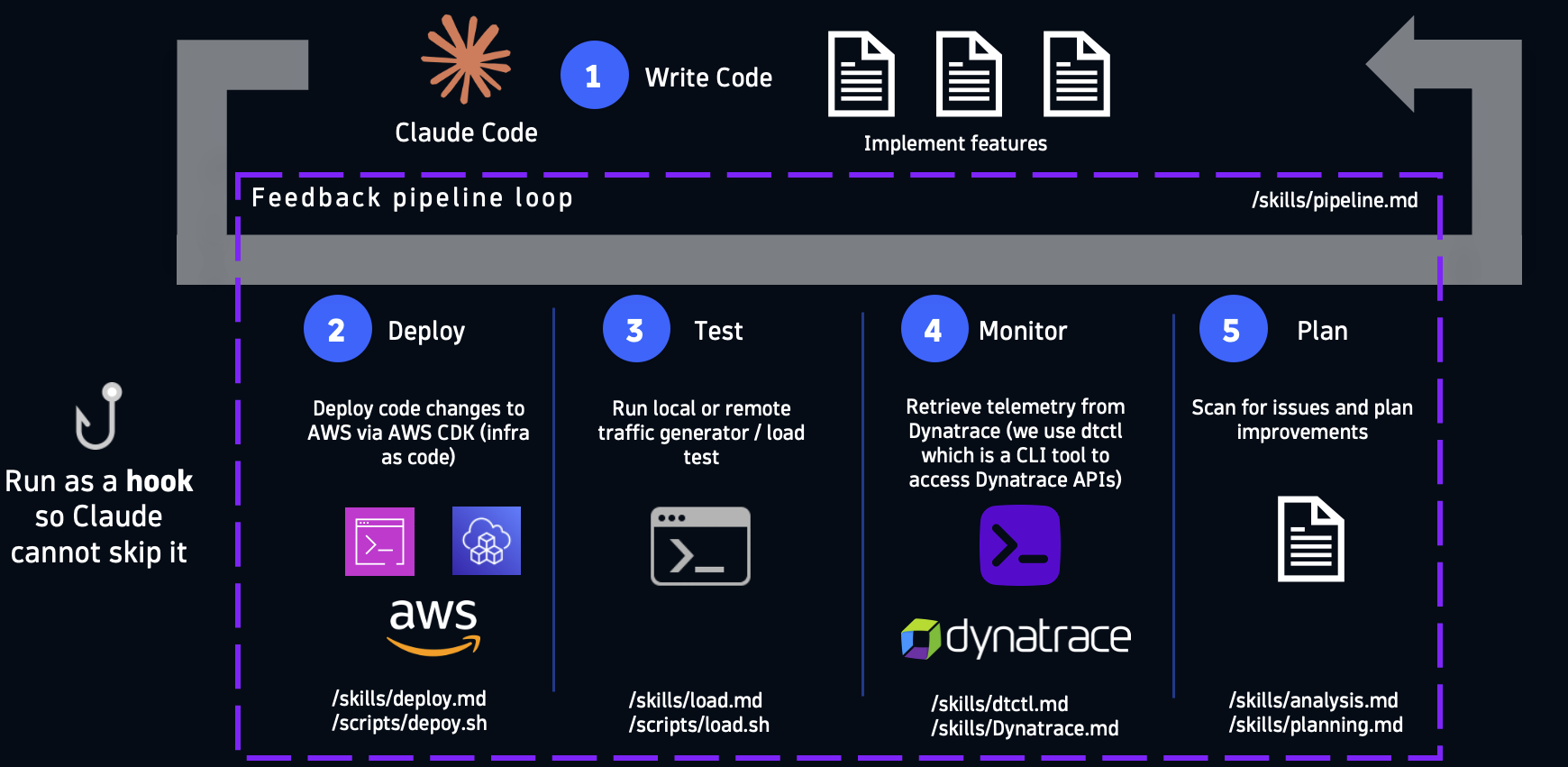

In practice, building this loop means giving the agent a small set of CLIs, tools, and skills, each scoped to one stage of the cycle. In a Dynatrace environment, that can include dtwiz to get telemetry flowing quickly and dtctl to work with Dynatrace APIs once the code is running:
  1. Write code: A coding agent, such as Claude Code, with your project skills loaded, implements features per the plan.
  2. Deploy: A deploy.md skill and deploy.sh script push code changes to your cloud provider via the infrastructure-as-code tool of your choice. For a new service or environment, a setup step can use dtwiz to analyze the system, recommend the right observability path, and help get telemetry flowing without hand-building collector configuration first.
  3. Test: Run synthetic load or trigger load test environments if running in a development or staging environment.
  4. Observe: A dtctl.md skill paired with dtctl, the CLI for working with Dynatrace APIs, retrieves the traces, metrics, logs, events, or entity data the deployed code just emitted.
  5. Plan: An analysis.md and planning.md skill instructs the agent to scan the telemetry for issues and plan improvements before the next iteration.
The critical detail: for automated workflows, this feedback pipeline should run as a hook, not an optional step that gets skipped. Hooks let you enforce that every code change passes through deploy-test-monitor-analyze before it’s considered “done.” Even when a humans stays in the loop, making the gate a habit is what turns a vibe coding session into engineering.
