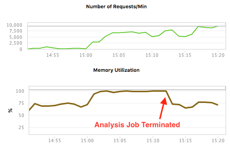

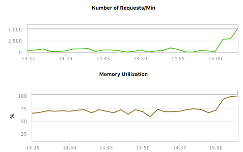

In the chart below we observe the Number of Requests and the Memory Utilization. Wow, the increase in the Number of Requests is causing memory utilized to go up. Quick, call Engineering and get them on this right away.
We can easily see that there’s a correlation between the Number of requests and the memory size. Based on this data it would be relatively easy to conclude that the increase in Requests is causing memory to increase. But the truth is simply that these two observed values have nothing to do with each other. After talking to the system operators, we learn that a large memory intensive analysis job was running. Once they shut down the Analysis job, things changed. Look at the same measures after a few minutes have passed. Same conclusion? Probably not.

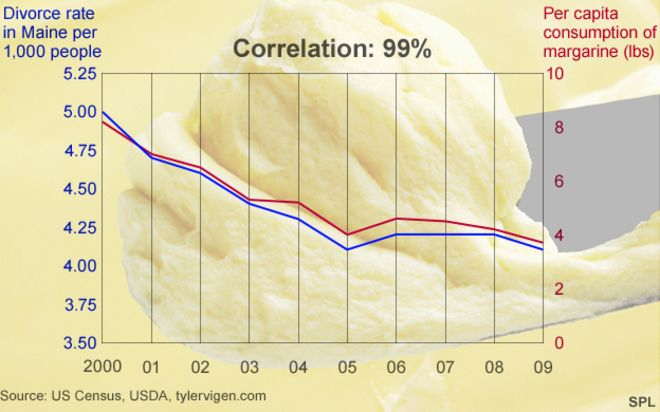

Just because we observe one value as going up and observe another value go up, does not mean they have anything to do with each other. The Number of Requests and Memory example above is a good example, and understandably confusing. Let’s look at a more obvious example. Tyler Vigen[1] did some great work using US Census data to look for spurious correlations in random public data and came up with some great conclusions. Did you know that margarine consumption can cause divorce?[2]
Clearly there’s no connection between margarine consumption and divorce rates but this is the exact conclusion that some APM vendors make when they use correlation to determine what’s wrong with your Enterprise Data Center.

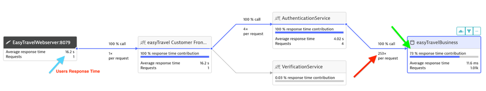

In complex multi-threaded computing systems, there’s lots of things going on at once. And as a Performance Engineer if I’m going to get to the root cause of my system problems and fix the user response time complaints, I must have an ability to know for certain which events cause what other events particularly as transactions cross threads, processes, machines and even data centers. This allows for quickly resolving issues and accurately getting to the root cause even in complex systems. The following diagram shows a relatively simply transaction that flowed across two java tiers and an Oracle database.nThis transaction is from a single user click which was reported to be taking too long, 16.2 seconds to be exact (light blue arrow). By using a causation-based approach to analyze the various events in this multi-tier environment, we can easily see that there’s 235 calls into Oracle (see the red arrow), all for a single user click.mNote that this makes up 73% of the total users’ response time (green arrow). This type of analysis cannot be done without causation and being able to determine exactly what behavior on a backend database tier is directly the result of a user action on the user’s browser.
If I attempt to use correlation to resolve this type of problem, I would not find this type of problem at all. I would simply be guessing as to what activity on the downstream tiers was caused by the upstream user click event. But only when being able to use causation can I determine what events (trips to the database) are happening as part of a single user click event.
