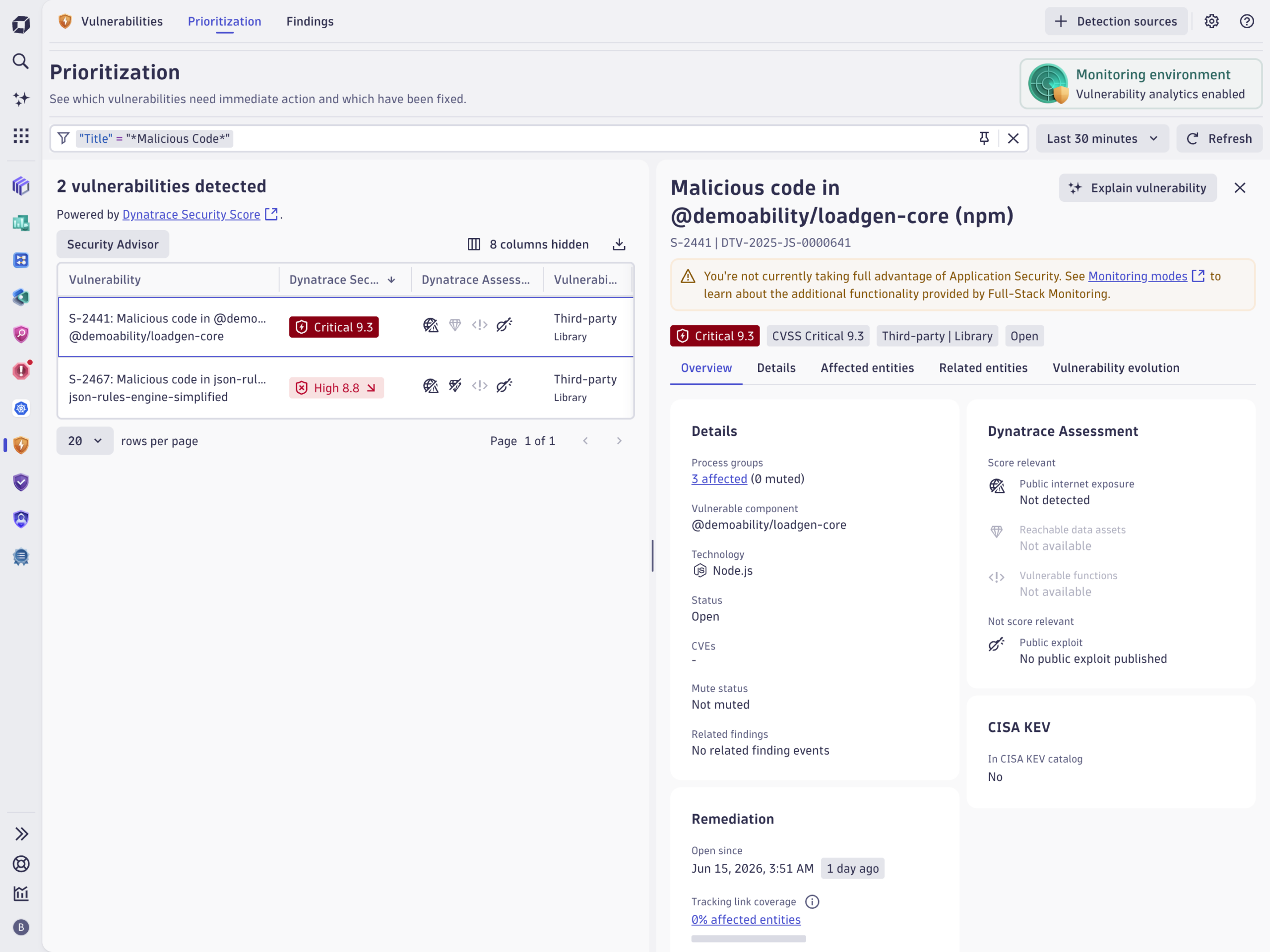

By expanding coverage of malicious packages in RVA, you don’t just get another threat list — you get malicious packages evaluated against what’s actually loaded and executing in your applications (Figure 1).
Figure 1. Malicious package detection in the Dynatrace Vulnerabilities app
That means your teams can cut through the noise and focus on genuine exposure rather than working through theoretical inventories, and they can triage and remediate in the same place where they already manage vulnerabilities.
