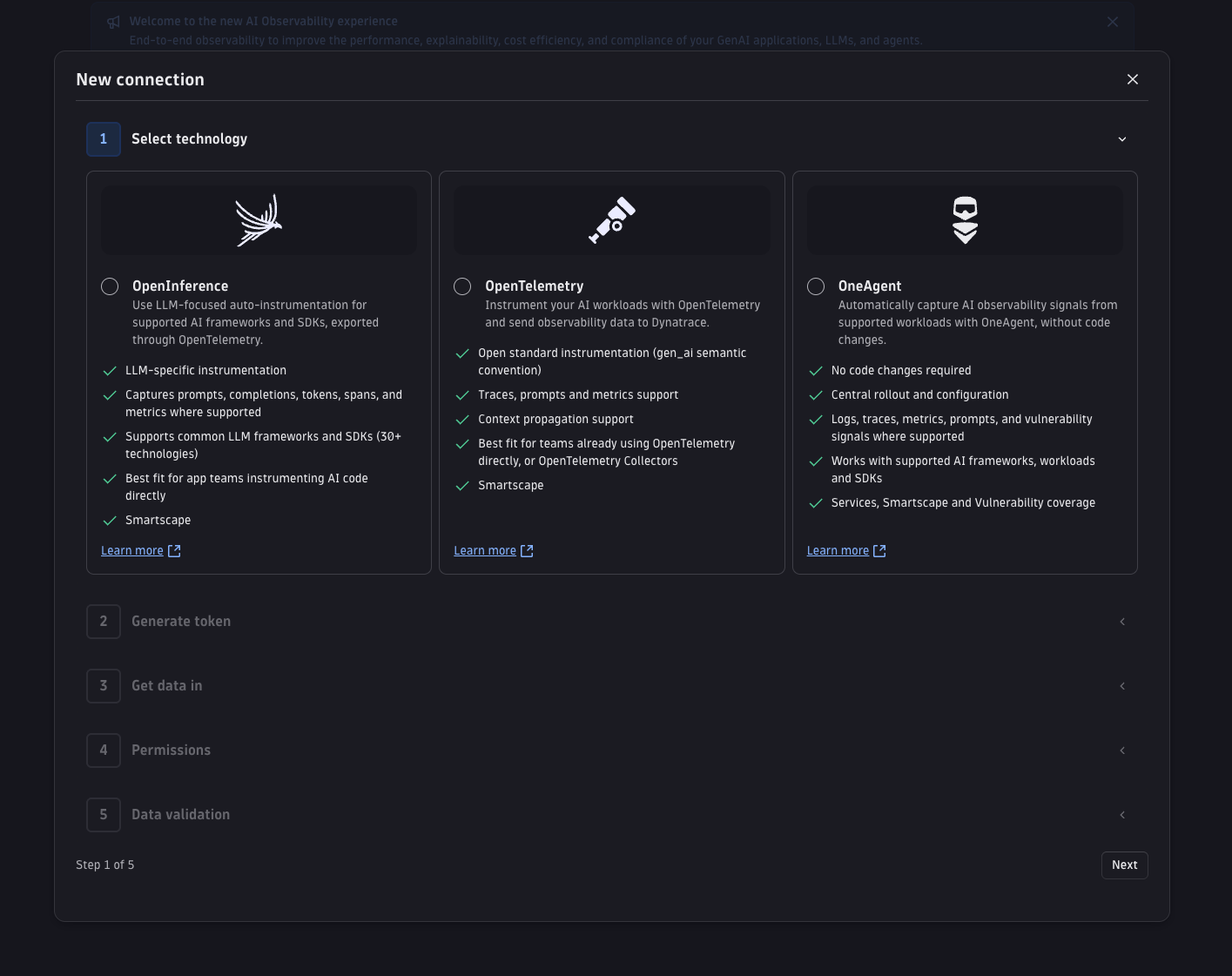

OneAgent auto-instrumentation options make it easy to capture AI application telemetry.
What is the OpenInference project, and how does Dynatrace support it?
The OpenInference specification is an open semantic convention and instrumentation standard for AI applications, built on OpenTelemetry standards and originally developed by Arize. It auto-instruments 33+ frameworks, including LangChain, LlamaIndex, CrewAI, AutoGen, OpenAI, and Anthropic, capturing LLM calls, agent runs, tool calls, and retrieval steps as distributed traces without code changes.
In late May 2026, Arize donated the OpenInference specification to the OpenTelemetry project. The OpenTelemetry governance board accepted the donation, and the merge landed in mid-June. As a result, the instrumentation – both the SDK and the framework – is now part of the OpenTelemetry project itself, governed the same way as any other OTel instrumentation.
Dynatrace support for OpenInference telemetry means teams gain vendor independence today, while supporting the same conventions the broader OpenTelemetry ecosystem is converging on.

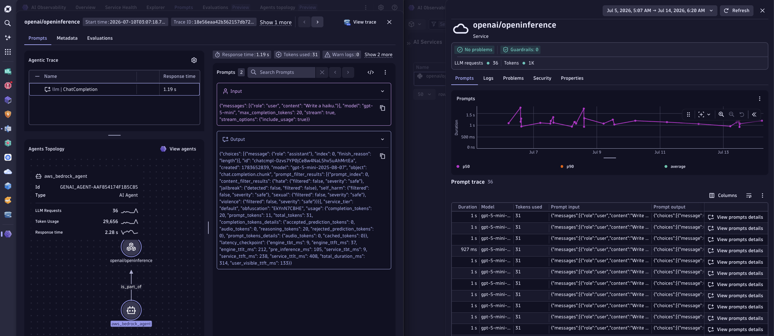

Dynatrace ingests OpenInference telemetry directly, normalizing its attribute conventions to the gen_ai.* attribute Dynatrace AI Observability is built on. This gives you full-stack visibility into your AI workloads and lets you reduce duplicate instrumentation effort while keeping your options open.
If your team already ships OpenInference spans, that instrumentation now also works in Dynatrace, unmodified. Once it lands in Dynatrace, that telemetry powers the same performance and cost monitoring, root cause analysis across agent and tool chains, as telemetry that originally arrived as native gen_ai.* attributes. Have a look at our documentation and learn how to get started with the OpenInference specification in AI Observability.
OpenInference topology view

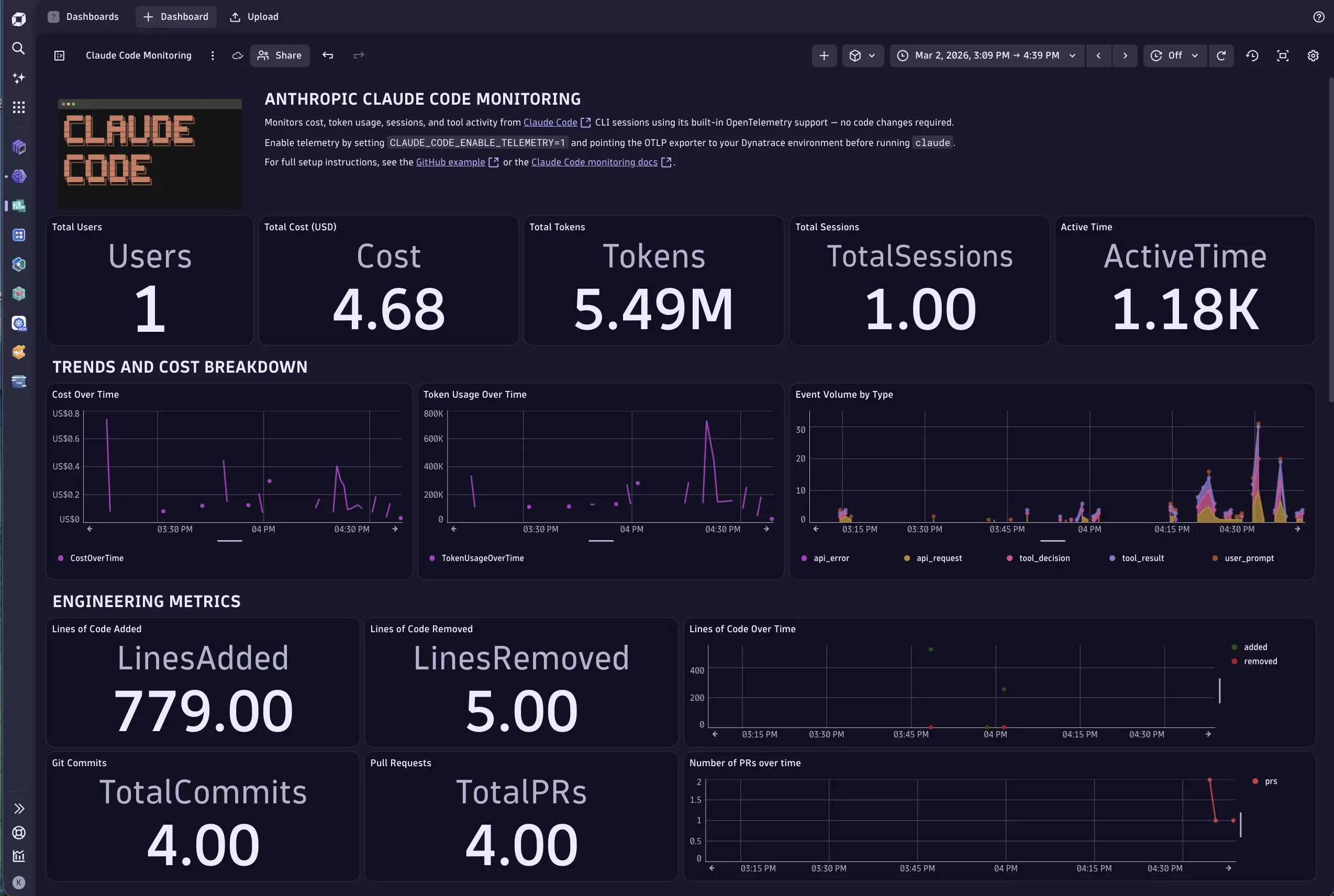

AI Observability can capture OpenTelemetry signals from these agents to monitor token consumption, cost, session activity, and tool behavior in real time. That gives teams a centralized view of agent usage across the organization, rather than piecing it together from separate terminals, SDKs, and vendor dashboards.
This is where Dynatrace goes further than other tools that are built primarily to debug a coding agent’s own output. Because agent telemetry lands in the same platform as your production traces, services, and infrastructure, you’re not limited to asking whether the agent’s suggestion was good. You can connect coding-agent activity to what actually shipped: the commits, pull requests, and downstream production behavior that followed.
For a closer look at supported agents, including Cursor, Claude Code, Google Antigravity, Codex , OpenCode, and GitHub Copilot, see our blog, Dynatrace expands AI Coding Agent monitoring.
Claude Code Agent monitoring in AI Observability
