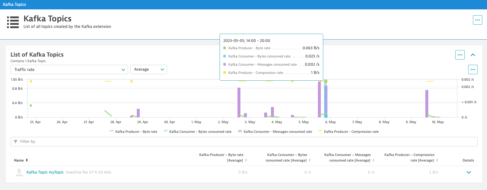

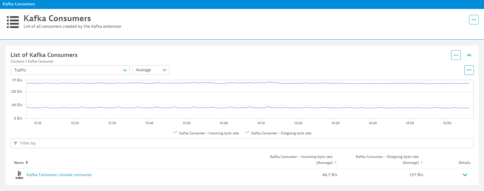

.With the Kafka extension, you can get additional insight into your Kafka server with metrics for brokers, topics, producers, consumers, and more. The extension also provides alerts for the most critical metrics. It creates a custom topology and entities for brokers, topics, producers, and consumers. It provides a dashboard for easier access and configuration of the extension and its entities.
The extension will gather different metrics depending on if it's monitoring a Kafka broker, producer or consumer. Make sure to activate the extension on all of them to get all metrics.
