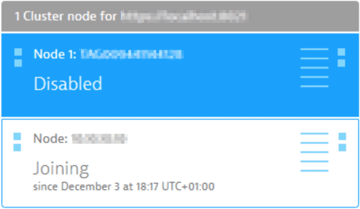

Disable OneAgent traffic on the source nodes but keep them running until data replication is finished and until non-replicated transaction storage data has expired.

Image of a node joining cluster
Transaction storage
Disabling a node effectively sets the transaction storage to read-only mode, but the node is still able to handle requests.
