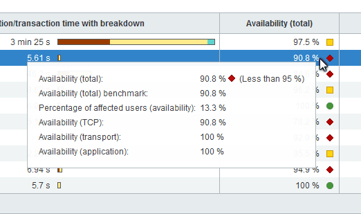

Reporting availability
The key availability metric is used both on the Data Center Analysis Reports, EUE Overview and Software Services reports. It is accompanied by a breakdown into transport, TCP and application context.
Availability tooltip
