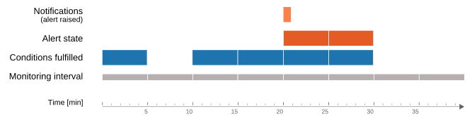

Figure 1. Alert raised after n intervals..
To ensure that the alert is triggered only when the problem persists in time, you can configure the alert to be sent only after several consecutive intervals (by default, 1) during which the conditions specified in the alert definition are met.
Example setting:
  • Raise after 3 monitoring intervals during which the conditions are fulfilled.
Alarm trigger example

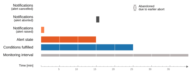

Figure 2. Alert canceled after n intervals..
Specifying when the alert should be canceled means that it is not automatically lowered until the specified number of intervals elapses.
Example settings:
  • Raise after 1 monitoring interval during which the conditions are met.
  • Cancel after 4 monitoring intervals during which the conditions are not fulfilled.
  • Abort after 30 minutes.

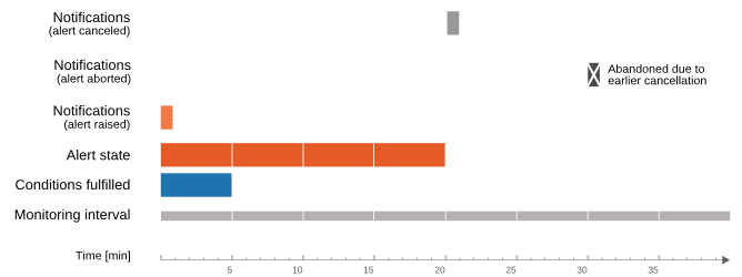

Figure 3. Alert aborted after n minutes after the alert was triggered.
You can configure the alert to be aborted even if the triggering conditions are still present.
Example settings:
  • Cancel after 1 interval during which the conditions are not fulfilled.
  • Abort after 15 minutes.

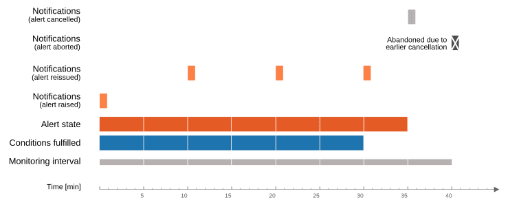

Figure 4. Alert reissued every n minutes after the alert was triggered.
In this example, an alert is first raised immediately after the trigger conditions appeared, and then reissued every ten minutes.
  • Cancel after 2 intervals during which the conditions are not fulfilled.
  • Abort after 40 minutes.
  • Reissue every 10 minutes.
