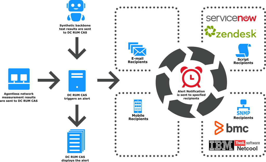

A raised alert typically indicates a network, application, or performance problem that requires issuing an incident ticket into the tracking system or adding an entry to a system log. To automate this process, the report server can run a custom script when an alert is triggered.
Alert system concept
