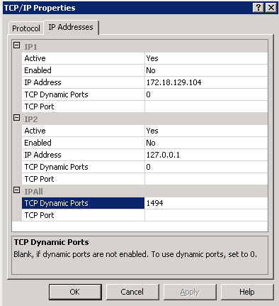

How do I determine the port number for a named instance of the SQL Server?
If enabled, the default instance of the SQL Server Database Engine listens on TCP port 1433. Named instances of the database engine are configured for dynamic ports. This means they select an available port when the SQL Server service is started. You can determine your SQL Server named instance in several ways; using SQL Server Configuration Manager is one of the simplest ways.
In general, you should refer to your SQL Server named instances by name so that you always address the valid instance (the port number may change but the instance name does not). If, during installation of the report server, you are unable to use the instance name and are forced to give a port number, you can check its value:
Log in to the system either remotely (via Remote Desktop, for example) or locally.
In Windows, go to Programs ► Microsoft SQL Server <server_version> ► Configuration Tools and choose SQL Server Configuration Manager.
Select Protocols for <instance_name> and then double-click TCP/IP to inspect the instance TCP/IP settings.
In the TCP/IP Properties dialog box, on the IP Addresses tab, determine the currently assigned port number.
If the TCP Dynamic Ports dialog box contains 0, this indicates that the Database Engine is listening on dynamic ports. The IPAll dialog contains the port number used by the SQL Server named instance you selected.
TCP/IP properties for the SQL Server named instance
