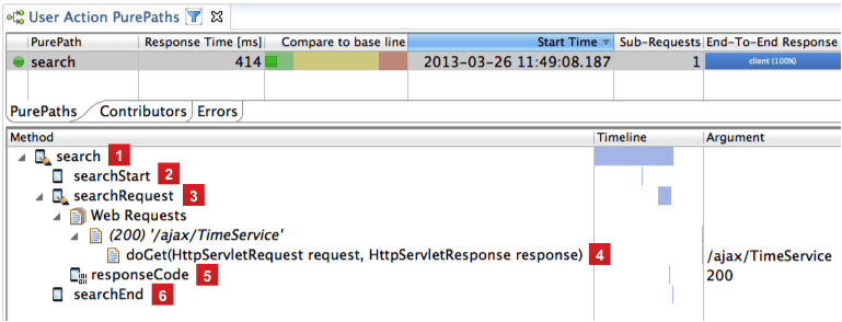

Start an action, which results in a mobile action PurePath in AppMon. Call this method at the beginning of the code that you want to time. You must set the action end using a call to leaveAction. A value is returned if the action is created successfully, but not if an error occurs. Call lastErrorCode or lastErrorMsg to find out which error occurred.

reportEventWithName
- (DTX_StatusCode) reportEventWithName:(NSString *)eventName
Parameter Description
eventName The name of the event.
Send an event to AppMon, which results in a node of a mobile action PurePath.
reportValueWithName
- (DTX_StatusCode) reportValueWithName:(NSString *)valueName
                               intValue:(NSInteger)value
                            doubleValue:(double)doubleValue
                            stringValue:(NSString *)stringValue
valueName The name of the value.
intValue An integer value in the range of 0‐2147483.
doubleValue Double value.
stringValue String value.
Send a key/value pair to AppMon, which results in a node of a mobile action PurePath. The value can be processed by a measure and be charted.

Instrumentation Example
The example code below creates a User Action PurePath that looks like this:
Example PurePath
Example PurePath
#import "Dynatrace.h"
- (BOOL)application:(UIApplication *)application didFinishLaunchingWithOptions:(NSDictionary *)launchOptions
    // initialize Dynatrace here or anywhere else (mind that actions and events that occur before initialization are not reported to dynaTrace.)
    [Dynatrace startupWithApplicationName:@"easyTravel"
                                   serverURL:@"http://easytravel.example.com:8080/eT/"
                                allowAnyCert:NO
                             certificatePath:nil];
- (IBAction)performSearch:(id)sender
    // [1a] start action "search"
    DTXAction *action = [DTXAction enterActionWithName:@"search"];
    // [2] named event inside an action
    [action reportEventWithName:@"searchStart"];
    // [3a] starting sub-action
    DTXAction *child = [DTXAction enterActionWithName:@"searchRequest"
                                         parentAction:action];
    // [4] NSURLRequest and NSMutableURLReqest are tagged automatically
    NSError* error;
    NSHTTPURLResponse* response;
    NSURL *searchURL = [[NSURL URLWithString:
                         [NSString stringWithFormat:@"http://127.0.0.1:8080/ajax/TimeService?tz=GMT",
                          [sender query]]] retain];
    NSData *data = [NSURLConnection sendSynchronousRequest:[NSURLRequest requestWithURL:searchURL]
                                         returningResponse:&response error:&error];
    [searchURL release];
    if(data == nil){
        // [x] report an error if communication fails
        [action reportErrorWithName:@"CommunicationError" errorValue:[error code]];
    // [5] custom value inside an action
    [child reportValueWithName:@"responseCode" intValue:[response statusCode]];
    // [3b] end action "searchRequest"
    [child leaveAction];
    // [6] named event on successful completion
    [action reportEventWithName:@"searchEnd"];
    // [1b] end action "search"
    [action leaveAction];
