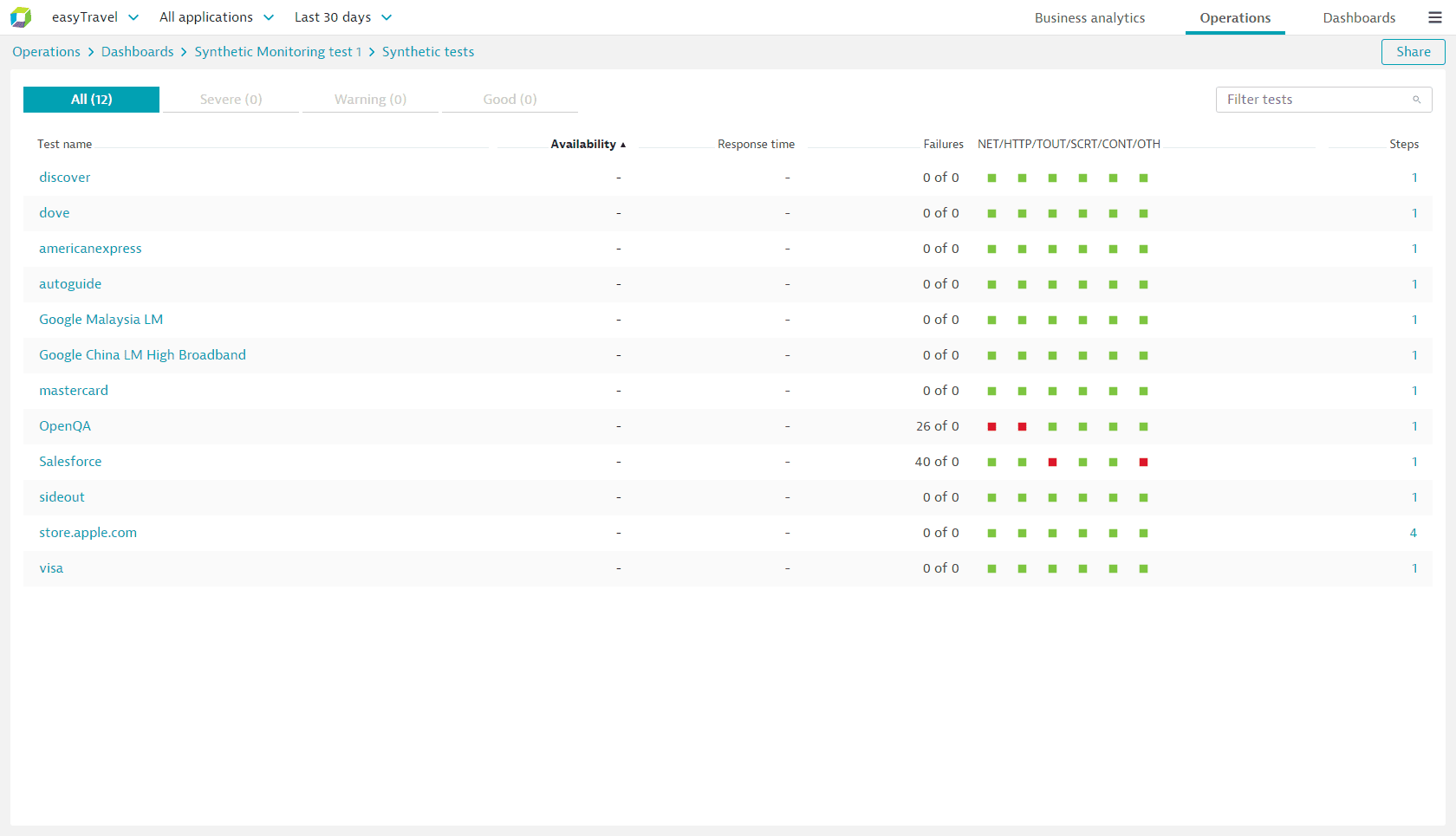

Click on the tile to display details about the selected tests in the tile. Each selected test shows:
  • The name of the test
  • Availability
  • Response time
  • Failures
  • Indicators for network, HTTP, timeout, script, contributor group, and other errors. A red indicator signifies errors. You can hover over any red indicator to see the number of errors for the error category. Click a red indicator to see a detail list of all the errors in the test for the associated error category. Each error listed shows information on the type of error, the URL where the error occurred, and the time the error occurred.
  • The number of steps in the test. You can click the number in the steps column to view a breakdown of errors by category for each step.
Click on any red indicator light to view details for the error.

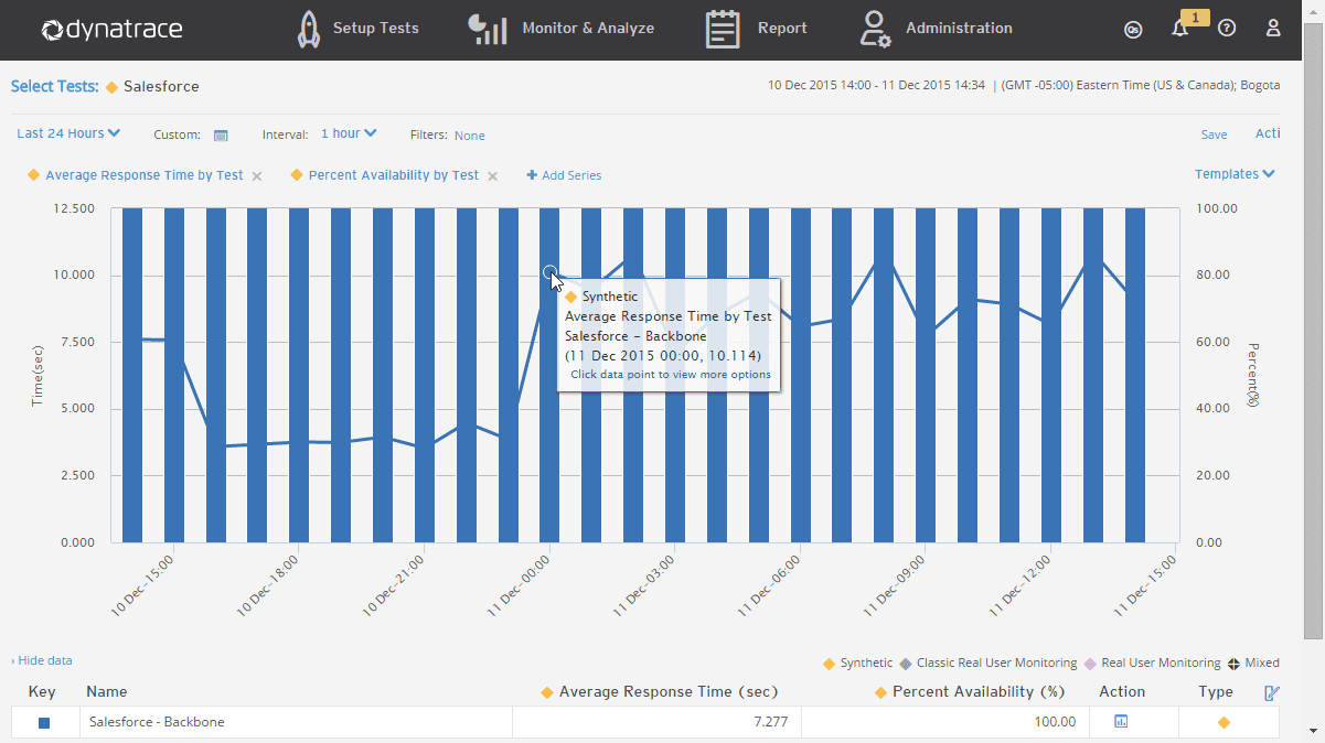

Clicking on any test in the list shows detailed Application Monitoring performance data for the selected test, such as average response time or percent availability. You can chart your data in any meaningful charting format. Hover over data points to see detailed information for the selected data point and drill down from the data point to perform root cause analysis and other Synthetic Monitoring diagnoses.
Click a test in the Synthetic Test list to drill down to the Interactive Chart in the Dynatrace Portal or MyKeynote portal, as shown in the following figures. By default, the chart shows response time and availability. You can reconfigure the chart to show data for other metrics, or drill down for more detailed information.
For details of charting the data in the Dynatrace Portal, see Interactive Charts in the Dynatrace Synthetic documentation.
When drilling down to an interactive chart in the MyKeynote portal, the MyKeynote Sign In page may appear for the initial drill down. Enter a valid Username or Email address and Password, and click Sign In. Refresh the screen after the sign in If the Performance Trend Graph does not appear.
