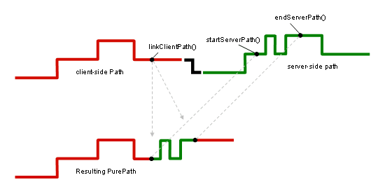

Linking client & server paths
The following diagram illustrates how tagging links the Client-side path of a transaction to the Server-side path to create one PurePath for the entire transaction.
Linking Client-side to Server-side Path

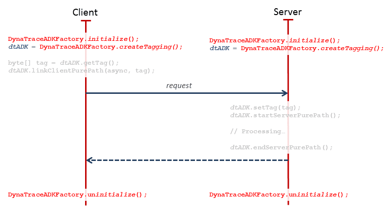

Initialize the Tagging ADK
Coding the initialization is illustrated by the figure below. The initialization step is required on both the client side and the server-side, once per process.
Initializing DynaTraceADKFactory
After successful initialization, DynaTraceADKFactory lets you create a Tagging object, which serves as the interface to the Agent.
Initialize DynaTraceADKFactory before creating a TaggingADK object:
DynaTraceADKFactory.initialize();
Use the following code to retrieve a TaggingADK object:
Tagging tagging = DynaTraceADKFactory.createTagging();
To free up resources allocated by the DynaTraceADKFactory, uninitialize the factory before your application quits:
DynaTraceADKFactory.uninitialize();
Uninitializing the DynaTraceADKFactory is necessary to disconnect properly from the AppMon Server and Collector, and to free up allocated resources.

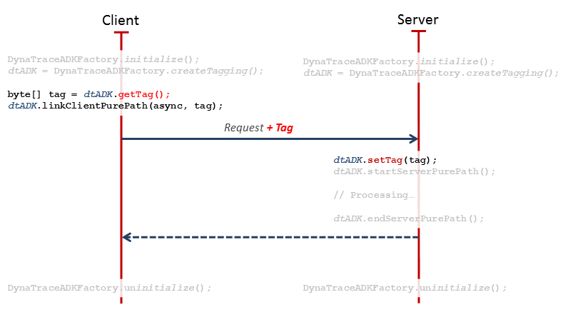

Tag a request
Client-Side (Caller)
  1. Retrieve the current AppMon TraceTag.
  2. Specify where to include the server-side path (insert a link).
  3. Send the AppMon TraceTag along with the request to the server side.
Server-Side (Callee)
  1. Read the remote AppMon TraceTag.
  2. Place this tag on the server side.
  3. Start the server-side PurePath and continue processing.
  4. After the request is processed, mark the end of the server-side PurePath.
Tagging a Request
Tagging a Request

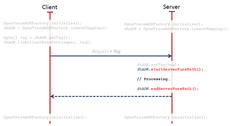

Mark the server-side path's start and end
On the server side, you must specify where your path starts and ends. Enclose the actual processing code by startServerPurePath() and endServerPurePath().
Specifying a PurePath Start and End
public void waitForRequest() {  }
public void execute(Request req) {  }
public void handleRequest(Request req) {
  tagging.setTag(req.getTag());
  tagging.startServerPurePath();
  execute(req);
  tagging.endServerPurePath();
public void run() {
  while(true) {
    Request req = waitForRequest();
    handleRequest(req);
