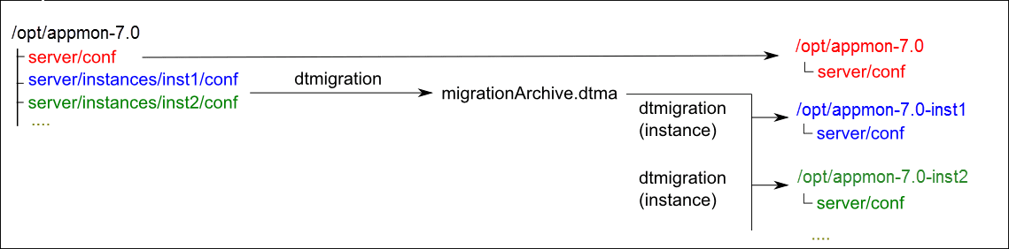

If you use AppMon Server instances that you created using the dtserver -instance command, you likely have two or more servers configured. The following steps let you to separate them into two separate installations, or distinct installation folders.
You should not perform an upgrade and separate the instances in a single step. First, split the instances into two distinct installations, for example inst1 and inst2. Once you have split the installation instances, then upgrade each one separately. The following shows the workflow.

Migrate the default server instance using the additional parameter -migrateInstances default when migrating from the migration archive to <DT_HOME_NEW> which is the target migration directory. See the Upgrade and Migration Guide for more information.
For the remaining server instances, where <DT_HOME_OLD> is the original AppMon installation directory, for each AppMon Server instance, where <INST_NAME> denotes the instance name, perform:
  1. Install a new AppMon Server using the installer on the target host.
  2. Migrate all files, including files such as .ini files and agent resources shared between the default server instance and the server instance by executing the following command.
    java -jar dynatrace-migration.jar -migration -sourceDTHome "<DT_HOME_OLD>" -targetDTHome "<DT_HOME_NEW>" where <DT_HOME_NEW> is the selected installation folder, for example /opt/dynatrace-7.0-instance1.
  3. Execute the following command to migrate the server instance files to the default server instance.
    java -jar dynatrace-migration.jar -migration -sourceDTHome <DT_HOME_OLD>" -targetDTHome "<DT_HOME_NEW>" -migrateInstances serverinstances -makeServerInstanceDefault "<INST_NAME>".
  4. Delete the <DT_HOME_NEW>/server/instances folder for cleanup and configuration verification.
