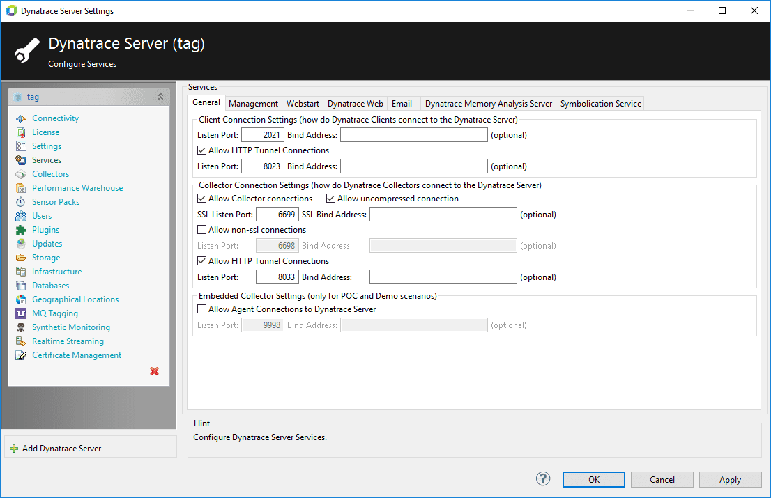

AppMon Server
You can configure all other related settings in the AppMon Client in the Services pane of the Dynatrace Server Settings dialog box, as shown below.
Services pane of the server settings dialog box

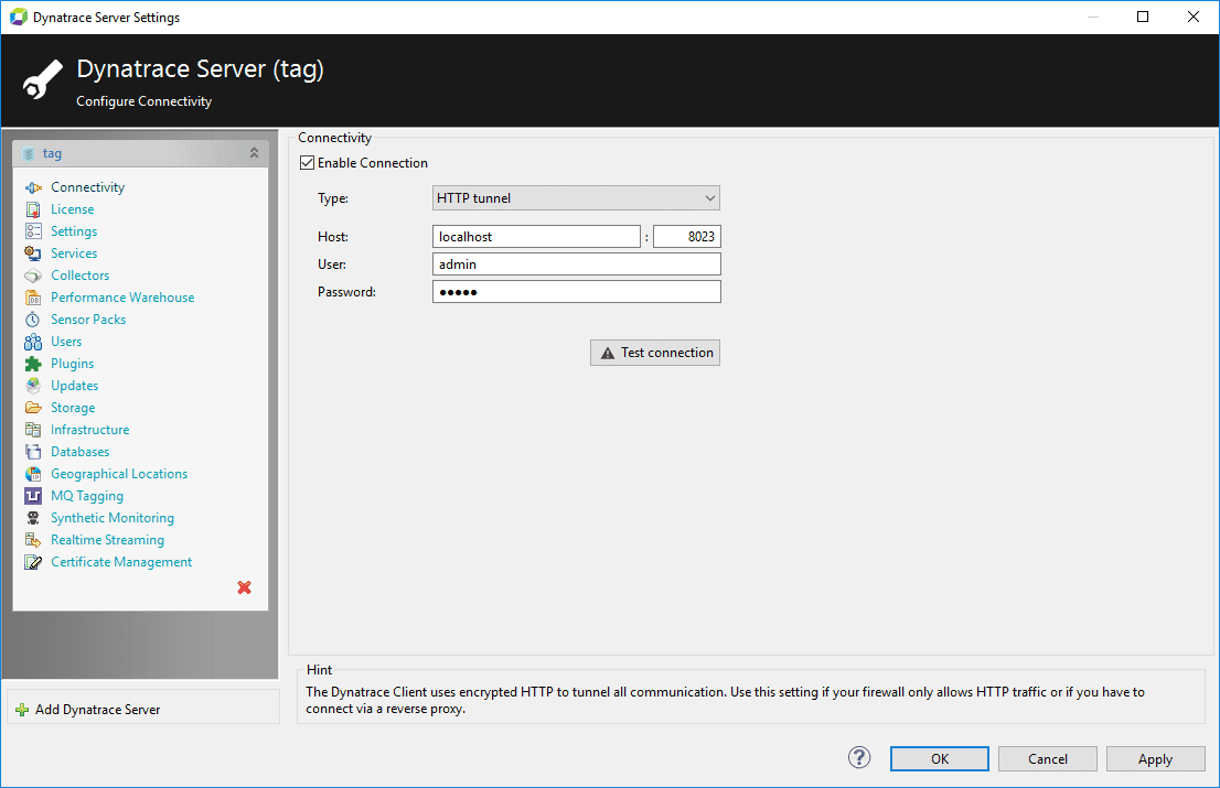

AppMon Client
To connect the AppMon Client to the AppMon Server using a HTTP tunnel, the Server's HTTP tunnel port has to be configured in the AppMon Client. All options are available in the Connectivity pane of the Dynatrace Server Settings dialog box for the AppMon Server.
Connectivity pane of the server settings dialog box
