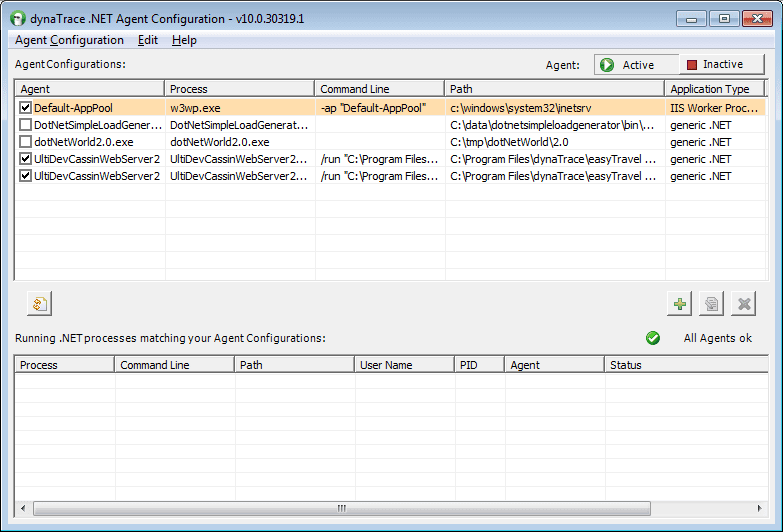

Main window
Main window
The .NET Agent Configuration tool main window has two parts. The upper part shows a list of Agent configurations. They define in which .NET process an Agent should be placed. The Application Type column displays the type of .NET process. ASP.NET Worker Processes are highlighted to distinguish them from other .NET processes.
The first time the .NET Agent Configuration tool starts, this list is empty because no agent configurations have been defined yet. See Creating a .NET Agent Configuration (below) for details on how to create an Agent configuration.
The bottom part of the window lists all currently running .NET processes that the active Agent configurations in the upper list. This list is updated automatically every 20 seconds and when an Agent configuration is activated/deactivated by clicking the check box next to it. You can manually refresh the processes list by clicking the refresh button.
