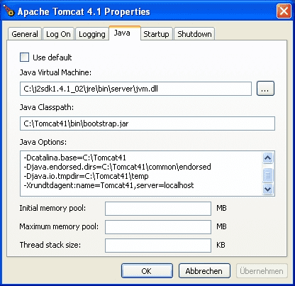

Tomcat as a Windows service
  1. If available, access the Tomcat Service Manager by choosing Start menu > All Programs > Tomcat > Monitor Tomcat.
    Otherwise, <TOMCAT_HOME>/bin /tomcatw<version>.exe //ES//<serviceName> displays the Apache Tomcat Properties dialog box.
    For example, to instrument Atlassian Confluence, get the Confluence service name from Properties in the Services Control Panel and
    <ConfluenceProgramDirectory>/bin /tomcatw<version>.exe //ES//Confluence<serviceNumber>. Note that <ConfluenceHome> is not the program directory, but the data directory.
  2. Select the Java tab and add the following line at the bottom of the Java Options:
    -agentpath:<DT_HOME>\agent\lib\\dtagent.dll=name=<AgentName>,server=<dynatraceCollectorName> Depending on the version and / or Agent path (with or without spaces), quotes may be needed around the path (as shown in the wizard sample string) or may get in the way.
    If this fails, check for the registry key HKEY_LOCAL_MACHINE\SOFTWARE\Wow6432Node\Apache Software Foundation\Procrun 2.0\Tomcat<version>\Parameters\Java.
