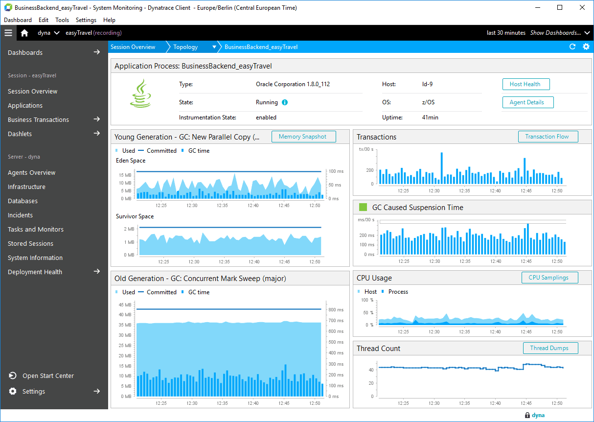

AppMon automatically monitors all JVMs and CLRs that are connected through an Agent. Data appears in the Transaction Flow dashlet, and in the Process Health dashboard.
