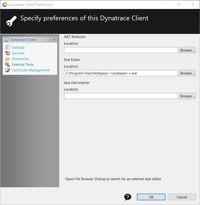

If you want to inspect logs, double-click them or click Download, and the contents appear in the AppMon Client.
We recommend you configure an editor to analyze the logs. If you choose External Editor from the context menu, your editor or the configuration dialog appears so you can configure the editor.
External Tools Dialog
