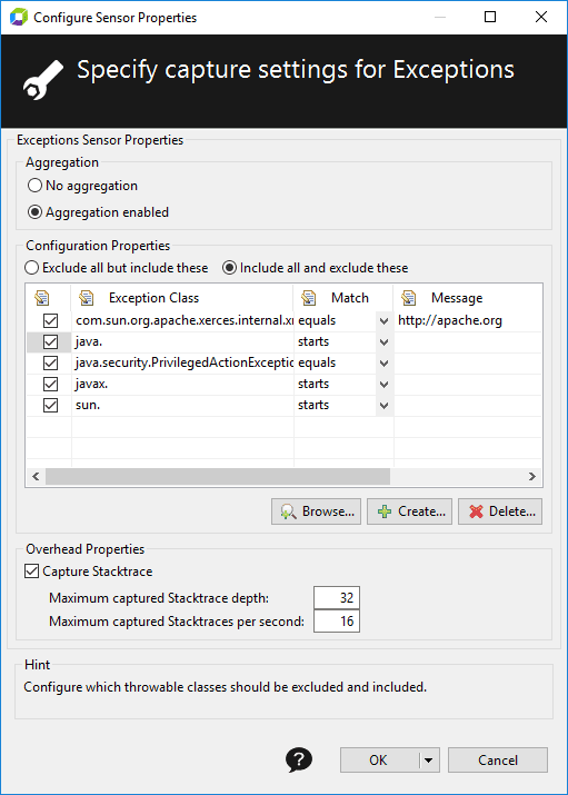

1.1 Exceptions capture settings
To enable exceptions capture:
  1. Open the System Profile Preferences dialog box and go to the Sensor Configuration item of the required Agent Group.
  2. Find the Exceptions or .NET Exceptions sensor, and double-click it for editing.
  3. There are two ways to handle exceptions capture:
    • Capture everything, and skip specified exceptions.
    • Capture specified exceptions, and skip everything else. Select the required option, and specify classes to be captured/excluded. You can do it manually, or use Class Browser. See Java Exception sensor and .NET Exception sensor for more information.

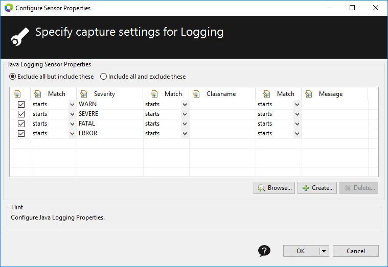

1.2 Log capture settings
AppMon logging captures errors and warnings. You can also enable capture of DEBUG messages.
Warning
DEBUG logging captures can cause considerable overhead in your application.
  2. Find the Java Logging or .NET Logging sensor, and double-click it for editing.
  3. There are two ways to handle log capture:
    • Capture everything, and skip specified messages.
    • Capture specified messages, and skip everything else. Select the required option, and specify messages to be captured/excluded. See Java Logging sensor and .NET Logging sensor for more information.

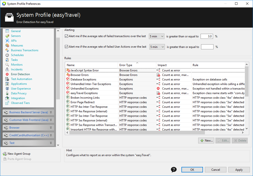

1.3 Errors capture settings
AppMon detects errors in your application with a configurable set of error detection rules. These rules are based on exceptions, HTTP response codes, and log messages. AppMon counts errors by transaction. The node that triggers the error is marked in the PurePath. Optionally, the transactions are marked as failed. The System Profile dictates the configuration for error detection rules. These rules are for common problems in applications, like unhandled exceptions that are outside of the transaction scope, or HTTP 500 responses. See System Profile - Error Detection for information about configuring error detection rules.
Error detection settings

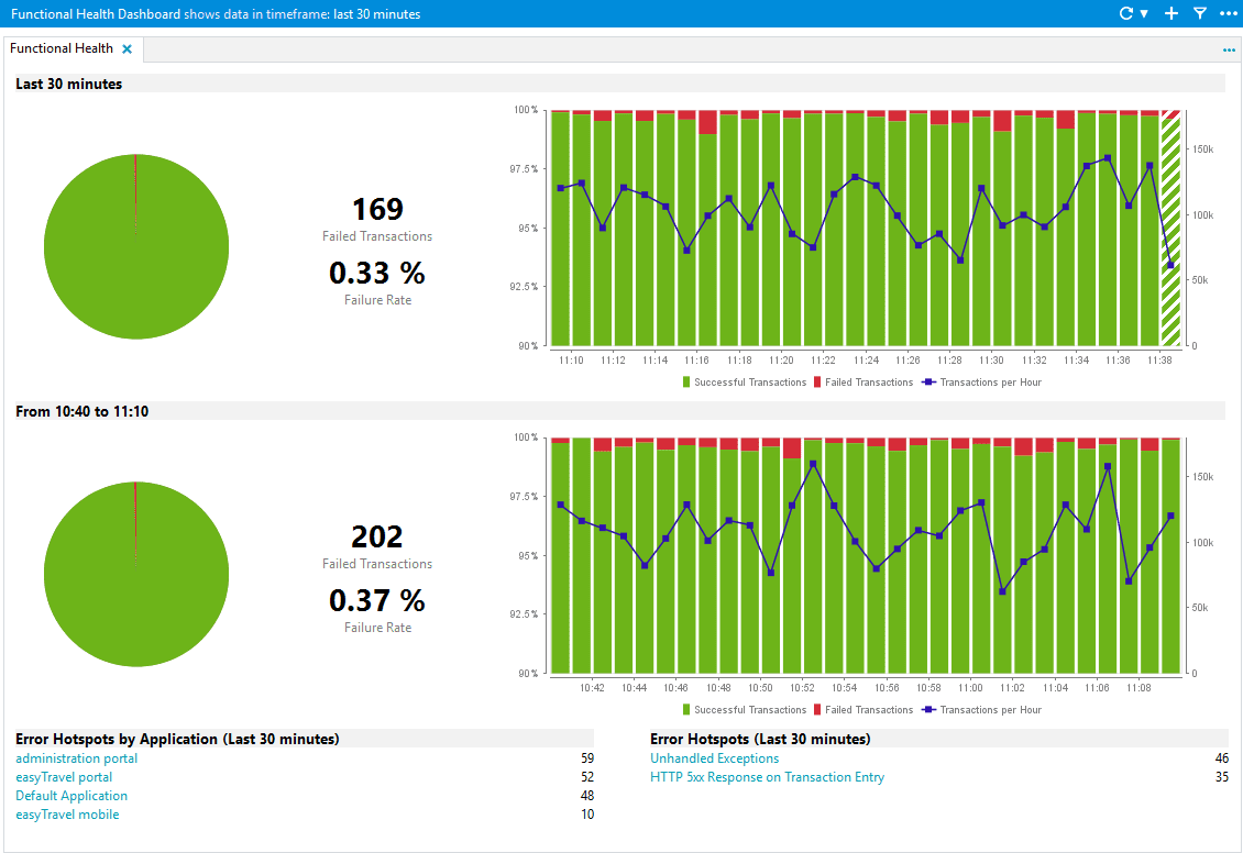

2.1 Overview functional health
For an overview of the functional health of your application, use the Functional Health dashlet. You can see how the transaction's load and failure rate compare to another time frame.
Functional health dashlet

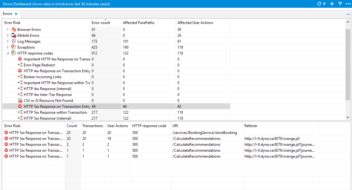

2.2 Overview errors
For an overview of errors within a certain time frame, use Errors dashlet.
Errors dashlet
Errors dashlet
The Errors dashlet includes the following:
  • The upper, Error Overview pane: Details errors and their occurrences.
  • The lower, Error Details pane: Details the exception class and message for the group of error rules or a single rule, selected in the upper pane.

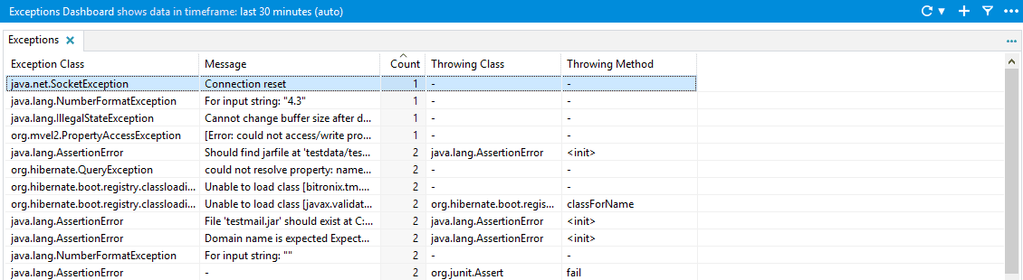

Use the Exceptions dashlet. To view all the exceptions found in the PurePaths of your session. You can see the exception class, message, which class threw the exceptions, and how often it occurs.
Exceptions dashlet
Exceptions dashlet

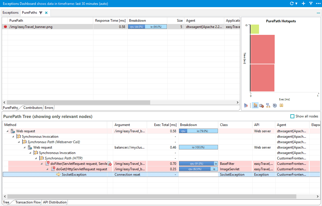

Right-click the exception and select Drill Down > PurePath to identify where the exception came from and why it did occur.
Drilldown to PurePath from the Exceptions dashlet
From here you can drill down to business transactions or web requests to identify the transaction that triggers the exception.

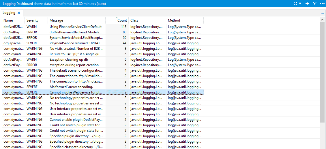

3.2 Identify the root cause of error logs
Identify the root cause the same way you identify exceptions. Use the Logging dashlet, and drill down from here.
