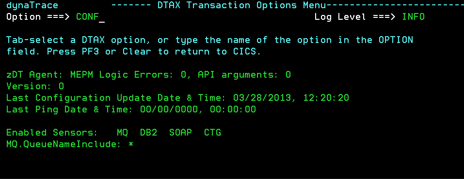

Expected queues and/or transactions (including SOAP and CTG transactions) are not being monitored
Verify that the CICS Sensor is configured correctly, and that the monitored CICS region's configuration matches that of the CICS Sensor in the system profile.
Edit the CICS Sensor Properties for the System Profile under diagnosis.
Issue a DTAX CONF command to display the following output:
