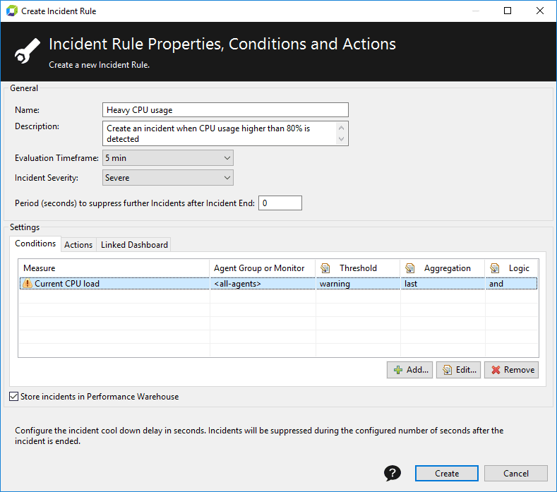

General settings
  • Name: Give the rule a unique name that describes its purpose.
  • Description: Optionally, provide a description of the rule. The description can include the measures associated with it and the action that occurs if the rule is violated.
  • Evaluation Timeframe: Select the duration used to evaluate if the defined conditions are met.
    For example, if you select a timeframe of one minute and use a PurePath duration measure with an average aggregation as input for the incident rule, the average PurePath duration of the last minute is checked for violation every 10 seconds. Measures remain in memory for one hour.
    The following graphic illustrates how timeframe is used to check for incidents.
    The longer the evaluation timeframe is, the smoother the averaged values will be. Use longer timeframes to reduce the impact of short periods of unusual values that would cause violations with shorter timeframes. The following graphic shows this smoothing effect for different evaluation timeframes. Note how the 10s-values fluctuate wildly while the 60s average provides a much smoother impression. 3m and 10m averages are even smoother and in this example don't show much detail at all.
    Smoothing effect of different incident evaluation timeframes
    The evaluation timeframe doesn't have any direct impact on incident duration though. Incidents close only when their condition hasn’t been met for a minute. This more effectively deals with measurements oscillating around their thresholds. Once this timespan has passed without further violation, incidents are closed with the closing time set to fit actual measurements.
  • Incident Severity: Choose the severity of incidents to show in incident-related dashlets. Incident severities are Informational, Warning, or Severe. Select the level that requires a response to notifications.
  • Incident Suppression: Set the incident delay in seconds. Incidents are suppressed during the configured number of seconds after an occurrence, to avoid sending redundant notifications.
  • Store incidents in Performance Warehouse: Set by default, this setting guarantees a complete incident history for the available charting data time frame. Disable this option if an incident should trigger actions without a historical record. All configured actions are still performed. Closed incidents are deleted no later than the next AppMon Server restart.

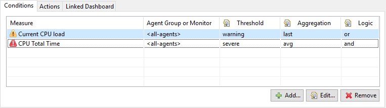

    If measures are combined with AND, their splittings have to match. If the first condition is violated by a measurement from an Agent, and the second condition is violated by a measurement from a different Agent, the combination will not be seen as violating.
    The matching takes into account the available splittings of each measure. For example, if an agent-based measure is combined with a monitor-based measure by the AND operator, it will only need matching hosts. Similarly, if one of the measurements is agent-based and the other is host-based (the example screenshot above shows such a scenario, as Current CPU load is agent-based and CPU Total Time is host-based), only the host will have to match.
    Some measures might contain additional splitting information beyond Agent/host/application, for example Garbage Collector type. If both relevant measures have these splittings, the splitting values must match; if only one of the involved measures do, the values will be ignored.
If you change thresholds in a measure, it will affect all incident rules which are using this measure. When you need the same measure with different thresholds, create a copy of it, and set the new thresholds there.
Dynamic Measures and combining conditions with and
If you have multiple conditions combined with and, AppMon smartly matches by splitting. For a violation to occur, all ANDed conditions need to be violated by the same split - if condition A is violated due to a measurement from agent X and condition B is violated due to a measurement from agent Y, this does not constitute a violation of the overall incident rule. Some measures provide very specific splittings, e.g. the Garbage Collection measures are split by individual garbage collectors. If you combine two such measures, these split values need to match for a violation to occur. If you combine such a measure with a different one that does not have this kind of splitting, that specific splitting value is ignored and only splitting values existing in both measures have to match.

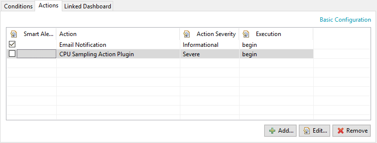

Actions
You can add automatic actions to be performed on the incident:
The Actions tab has two modes: basic, where you can only configure email notification, and advanced, where you can configure any action. Click Advanced Configuration or Basic Configuration to switch between them.
A message displays if the general AppMon email configuration is missing. If this happens, you can configure email by clicking Yes in the message box. The Email tab of Services item of the Dynatrace Server Settings dialog box opens.

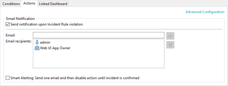

Basic configuration
Actions - Basic configuration
For basic configuration, you can only configure email notification for incidents. The Default From user of the Email settings is the sender. You can change is in the Advanced Settings mode.
  • Send notification upon Incident Rule violation: Select to activate email notifications.
  • Email: Type in email recipients. You can use the actual email address, or AppMon user names and user groups. In that case, AppMon sends the notification to the email address from the user account.
    The list of recipients appears in the Email Recipients field.
  • Smart Alerting: Sends email just once if multiple incidents occur, until the raised incident is confirmed by a user. Otherwise notification goes out for each incident.

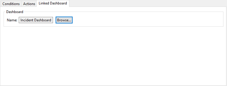

Linked dashboard
You can link a dashboard to the incident rule. This dashboard is used for reporting the incident by email. You can also quickly navigate to the dashboard from the Incidents dashlet, via context menu of the incident. You can only select dashboards stored on the server where the System Profile is stored. The default for new incident rules is the Incident Dashboard, which is deployed with every AppMon Server.
Linked dashboard
Linked dashboard
For built-in baseline incident rules, the linked dashboard configuration includes an option to open the affected splitting in the Applications dashboard.
For built-in host incidents, the configuration includes an option to open the Infrastructure monitoring dashboard for the affected host.
