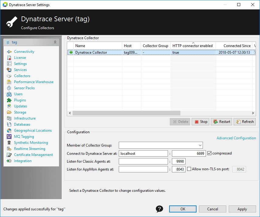

The Collectors pane of the Dynatrace Server Settings dialog box allows you to view and configure Collectors, connected to the AppMon Server. To access it, click Settings > Dynatrace Server > Collectors.
Server settings - Collector

Collector properties
Select a Collector to configure:
  • Collector group
  • The Collector-Server connection.
  • The Agent-Collector connection.
The rest of the Collector parameters are configured via the Collector configuration file.
Add collector to a group
To add collector to a group, select the group from the Member of Collector Group list, or type the name of a new group and click Apply.
Configure Collector-Server connection
To configure Collector-Server connection, specify the Server host and the port in the Connect to Dynatrace Server at fields. If needed, select the compressed checkbox. Restart the Collector for changes to take effect.

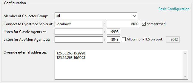

Click Advanced Configuration to configure multiple bind addresses and/or listening ports for Agent connections to the Collector. Specify them in the Override external addresses textbox.
Advanced configuration
AppMon requires separate configuration in the one of the following fields:
  • AppMon 2017 May Listen for OneAgents at.
  • AppMon 2018 April and later Listen for AppMon Agents at.
AppMon Agent uses secure connection by default, to allow non-secured connections, select the Allow non-TLS on port checkbox, and specify port for such connections.
