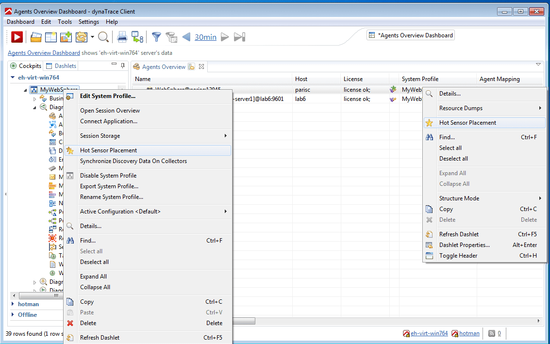

Applying Hot Sensor Placement
Hot Sensor Placement menu
Use the System Profile context menu to apply Hot Sensor Placement to all Agents of a System Profile at once. To apply it to a single Agent, use the context menu on the Agent in the Agent Overview.
Hot Sensor Placement executes on the method level. All methods on the SUD continue to execute the original code, even during the Hot Sensor Placement, until the Hot Sensor Placement's completion. Methods that start after the Hot Sensor Placement run the new code with the configuration changes applied.
