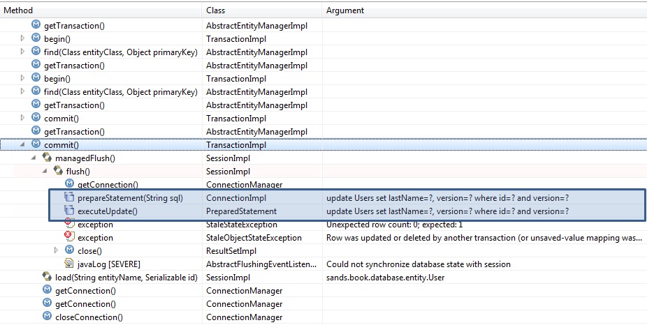

Optimistic locking is best achieved by defining a Version attribute in your entities. When entity changes are then synchronized with the database, SQL statements are generated that check whether the entity has been modified in the meantime leading to an OptimisticLockingException. The code below uses two EntityManagers which modify the same Entity.

As you can see in the trace below the second update fails as the SQL statement with the version property in the WHERE clause does not affect the expected number of rows.
