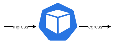

NetworkPolicies have to be defined on both sides
The last thing to consider is that to allow a connection between pods, the connection has to be allowed on both sides.
For example, if pod1 should be allowed to connect to pod2, an egress policy has to be defined for pod1, and for this connection to work, an ingress policy has to be defined for pod2.

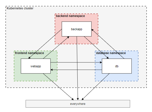

Step 2: Verify that the three pods can talk to each other
  • Wait until the pods are running
  • Instead of curl to the service names, you can also curl to the service’s IP address or the pod’s IP address to test the connection.
kubectl exec webapp -n frontend -- curl backapp.backend # connection works
kubectl exec webapp -n frontend -- curl db.database # connection works
kubectl exec backapp -n backend -- curl webapp.frontend # connection works
kubectl exec backapp -n backend -- curl db.database # connection works
kubectl exec db -n database -- curl webapp.frontend # connection works
kubectl exec db -n database -- curl backapp.backend # connection works
Kubernetes pods can talk to each other

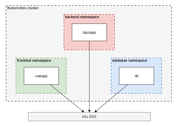

Step 4: Verify that no connections between the pods are possible anymore
kubectl exec webapp -n frontend -- curl backapp.backend # connection does not work
kubectl exec webapp -n frontend -- curl db.database # connection does not work
kubectl exec backapp -n backend -- curl webapp.frontend # connection does not work
kubectl exec backapp -n backend -- curl db.database # connection does not work
kubectl exec db -n database -- curl webapp.frontend # connection does not work
kubectl exec db -n database -- curl backapp.backend # connection does not work
No connections between pods in Kubernetes cluster

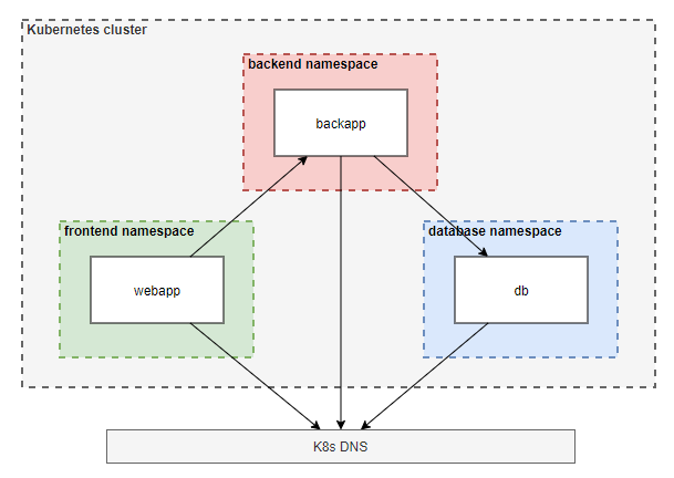

Step 5: Create and apply NetworkPolicies that allow the following traffic
From the webapp pod to the backapp pod:
  • Create a NetworkPolicy that selects the webapp pod and allows outgoing traffic (egress) to the backapp pod:

Step 6: Verify the connections are possible like they should be
Kubernetes pod connections
