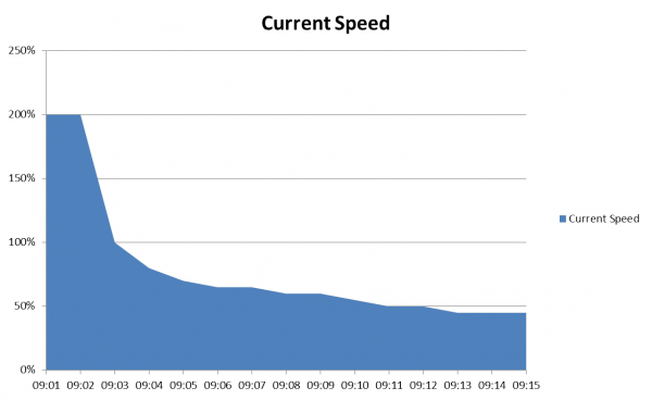

After that I started my batch job with a single instance and started measuring the throughput. When putting the “CurrentSpeed” into a chart it looked something like this:
The speed would start at 200% and go down according to the target time after the start
It started at 200%, which my java code reports if the remaining transactions are zero.  Once I start the load the calculated speed goes down to indicate the real relative speed. It quickly dropped below 100%, indicating that it was not fast enough to meet the time window. The longer the run took, the less time it had to finish. This would mean that the required throughput to be done in time would grow. In other words, the relative speed was decreasing. So I went ahead and produced three AutoScaling actions and the respective alarms.

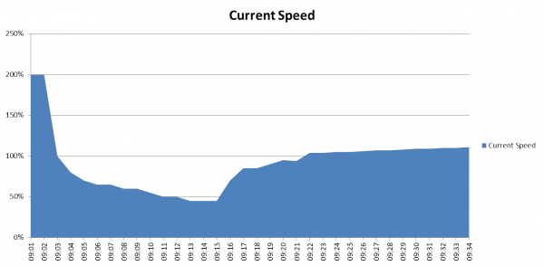

The first doubled the number of instances if current speed was below 50%. The second added 10% more instances as long the current speed was below 105% (a little safety margin). Both actions had a proper threshold and cool down periods attached to prevent an unlimited sprawl. The result was that the number of instances grew quickly until the throughput was a little more than required. I then added a third policy. This one would remove one instance as long as the relative current speed was above 120%.
The Adjustments result in higher throughput which adjust the relative speed
As the number of instances increased so did my applications throughput until it achieved the required speed. As it was faster than required, the batch would eventually be done ahead of time. That means that every minute that it kept being faster than needed, the required throughput kept shrinking. Which is why you see the relative speed increasing in the chart although no more instances were added.
Remaining Time in Minutes Remaining Transactions Required Throughput per Minute Actual Throughput Relative Speed
60 600 10 12 120%
59 588 9.97 12 120.4%
58 576 9.93 12 120.8%
57 564 9.89 12 121.2%
Upon breaching the 120% barrier the last auto scaling policy removed an instance and the relative speed dropped. This lead to a more optimal number of instances required to finish the job.
