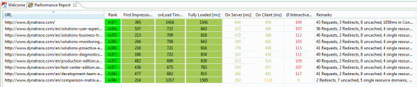

We just launched our new corporate web site. Right after the site went live it was time for me to analyze its performance with our dynaTrace AJAX Edition. Everything looked good – no problems on the page -straight A’s on the Performance Report (read more on this on my blog How we improved our Performance Rank from D to A):
Performance Report showing good grades on newly launched dynaTrace Web Site
