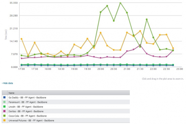

The measurement results from the Compuware network in the periods leading up to, and during, the Super Bowl showed some clear winners and losers in page load time. Events like the Super Bowl require high-frequency measurements, so we set our locations to collect data every 5 minutes to catch every variation in performance, no matter how fleeting.
For the period from 5PM EST until 11PM EST on Sunday, February 3, the top and bottom 3 sites were:
Top 3 Performers
  1. Go Daddy
  2. Paramount
  3. Lincoln Motor Cars
Bottom 3 Performers
  1. Doritos
  2. Coca-Cola
  3. Universal Pictures
Top and Bottom Web Performers - Super Bowl 2013
Top and Bottom Web Performers – Super Bowl 2013
All of these sites chose different approaches to delivering their message online. And what we found through our analysis is that the issues that they encountered almost perfectly aligned with those that Compuware finds during every major online event.
