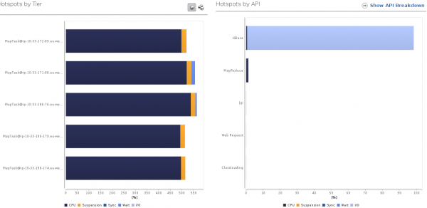

More specifically we spend nearly all time in HBase. As we are loading data, into HBase we would expect it to be the primary contributor.
This break down shows that all MapTasks are processing and spend nearly all their time sending data to hbase
This break down shows that all MapTasks are processing and spend nearly all their time sending data to HBase

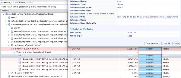

Next I took a look at the HBase inserts. We can see how many items we processed and inserted into HBase:

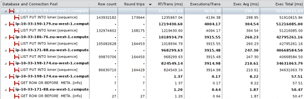

This shows the inserts per region server and hbase table/column family. We also see the number of roundtrips compared to the number of rows inserted
This shows the inserts per region server and HBase table/column family. We also see the number of roundtrips compared to the number of rows inserted
A couple of things are interesting here. First of all we see that the number of inserts is not equally distributed across the region servers. That  is again due to the fact that the table was empty, and hbase started in a single region (see the previous screenshots and hortonworks blog).  We can also compare the number of inserted rows with the number of roundtrips, making sure that we leverage batching correctly.

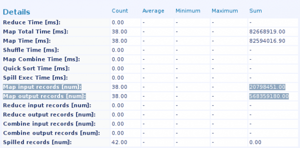

When comparing this with the number of mapped records we see that we are doing roughly 27 inserts per input record and each output record corresponds to a single HBase row.
This shows Details about the MapReduce Job and several counters. In this case we see the mapped records.
In summery we can say that the loading is already pretty optimal, the CPU load on the cluster is fine and we insert ~1700 rows into HBase per roundtrip.

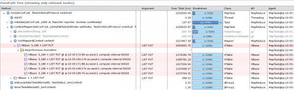

This shows a single task attempt inserting rows into HBase, we can see that it inserts many rows in a single roundtrip
Together with the fact that HBase really was the main contributor here means, that there was nothing much that I could do to speed things up, at least not with some serious expert help (suggestions on how to improve this beyond pre-spliting are welcome). So let’s move on the the index job.

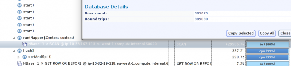

The Database Overview shows a single Scan that makes a roundtrip to the HBase region server for every single row it retrieves
Look at the roundtrips and the row counts processed. There is one more roundtrip than there are rows! That means the MapReduce job is calling out to the HBase region server for every single row, which is very inefficient.
The default scan caching on a Pig HBase job should be 100, but that was obviously not the case. The performance breakdown showed me that we were indeed spending all of our time waiting on HBase.

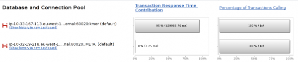

The HBase region Server contributes over 95% to our job execution time
This flow also shows that we spend 95% of our time waiting on HBase

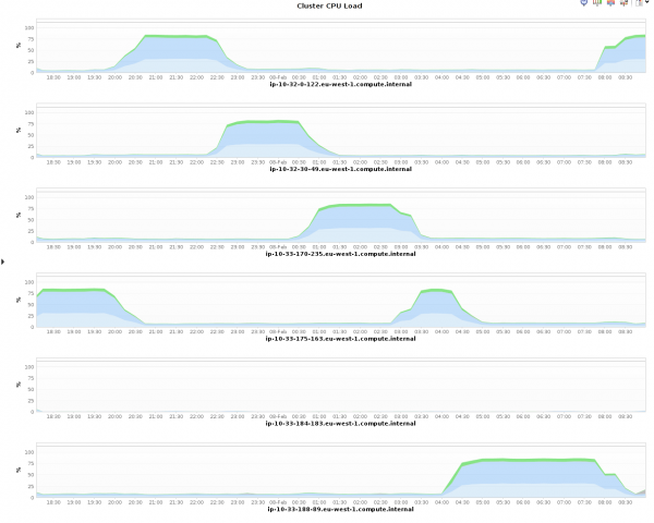

Because we are making one network roundtrip for every single row, the utilization of my cluster was miserable.
The CPU utilization in the hadoop cluster is bad, it only has a couple of spikes which seem to coincide with HBase region splits
Therefore adding more hardware would not have helped much – it was not the lack of resources that made my indexing job slow.

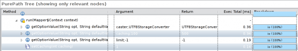

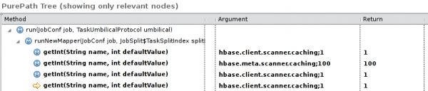

Now I was really curious, I added a couple of sensors to get more visibility and what I found was that HBaseStorage did pick up by caching configuration option as defined in the script, but the actual HBase Scanner was still being configured to use 1 as cache size!
The two selected rows show that while the Pig option (the first) retrieves the caching option defined in my pig script, the Scanner itself still gets Caching size 1 (second selected row)

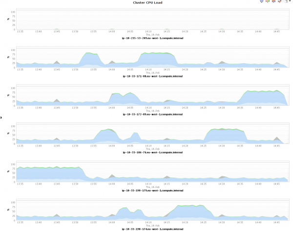

Thus we’ve turned this job from one mostly waiting on HBase and network to one that is actually leveraging the CPU. As a result the utilization of my cluster is much better now, albeit far from optimal.
The CPU load on the Cluster is much better now, compared to before.
There is still a lot of room for improvement, CPU utilization of my Hadoop nodes is not close to 100%, so we might be able to make this even faster, but that is work for another day. What’s important is, without the insight that our APM solution gives us I would have never know how to fix this!
