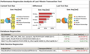

As a final step I publish the comparison results along with the unit test results to give every developer easy access to it. The following screenshot shows how such a comparision report would look like – giving the developer insight into how the performance characteristics of their code has changed from build to build:
Regression Analysis Report Showing Database and Web Service Problems
