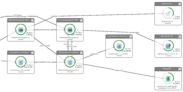

The first thing I always do is look at the topology of an application to get a feel for it.
Overall Transaction Flow of the Application

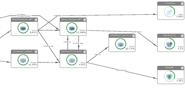

As we see it’s a modestly complex web application and it’s using MongoDB as its datastore. Overall MongoDB contributes about 7% to the response time of the application. I noticed that about half of all transactions are actually calling MongoDB so I took a closer look.
Flow of Transactions that access MongoDB, showing 10% response time contribution of MongoDB

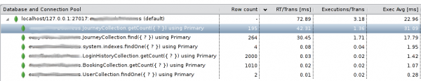

Those transactions that actually do call MongoDB spend about 10% of their response time in that popular document database. As a next step I wanted to know what was being executed against MongoDB.
Overview of all MongoDB commands. This shows that the JourneyCollection find and getCount contribute the most to response time
One immediately notices the first two lines, which contribute much more to the response time per transaction than all the others. What was interesting was that the getCount on the JourneyCollection had the highest contribution time, but the developer responsible was not aware that he was even using it anywhere.

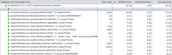

What jumps out is that those particular transactions spend indeed over 40% of their time in MongoDB, so there was a big potential for improvement here. Another click and we looked at all MongoDB calls that were executed within the context of the same transaction as the getCount call we found so mysterious.
All MongoDB Statements that run within the same transaction context as the JourneyCollection.getCount
What struck us as interesting was that the number of executions per transaction of the find and getCount on the JourneyCollection seemed closely connected. At this point we decided to look at the transactions themselves – we needed to understand why that particular MongoDB call was executed.

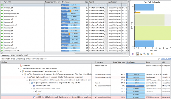

It’s immediately clear that several different transaction types are executing that particular getCount. What that meant for us is that the problem was likely in the core framework of that particular application rather than being specific to any one user action. Here is the interesting snippet:
The Transaction Trace shows where the getCount is executed exactly

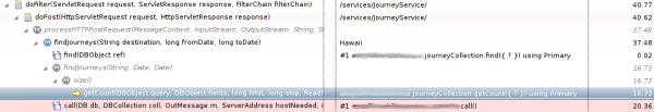

We see that the WebService findJourneys spends all its time in the two MongoDB calls. The first is the actual find call to the Journey Collection. The MongoDB client is good at lazy loading, so the find does not actually do much yet. It only calls the server once we access the result set. We can see the round trip to MongoDB visualized in the call node at the end.
We also see the offending getCount. We see that it is executed by a method called size which turns out to be com.mongodb.DBCursor.size method. This was news to our developer. Looking at several other transactions we found that this was a common pattern. Every time we search for something in the JourneyCollection the getCount would be executed by com.mongodb.DBCursor.size. This always happens before we would really execute the send the find  command to the server(which happens in the call method). So we used CompuwareAPM DTM’s (a.k.a dynaTrace) developer integration and took a look at the offending code. Here is what we found:
