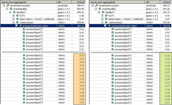

Analyzing the JavaScript execution with the FREE dynaTrace AJAX Edition shows me all the 1000 invocations of processObject in both use case scenarios. In both cases execution time of the method increases over time – that is explained by a growing globalString object which gets more expensive to manipulate the larger the string grows. By the way, I know there are better ways to concatenate strings, and I should try out some of these recommendations. An excellent read here are the blogs from the guys at SitePen, e.g.: String Performance: An Analysis or String Performance: Getting Good Performance from Internet Explorer.
Let’s look at my results side-by-side showing the average execution time of processObject as well as the first couple of calls and the last couple of calls of the overall 1000 invocations of that method:
Execution Time Comparison between my two scenarios
The left execution trace shows the JSON example where I constantly have 1000 JavaScript objects in memory (300ms). The right shows the XML example where I only have 1 JavaScript object in memory (150ms). The processObject method is called 1000 times in both scenarios and is doing exactly the same thing – concatenating the individual properties of the passed JavaScript object to a global string. The difference in execution time of these string concatenations, however, changes dramatically the longer the string gets. The only explanation I have for this “phenomenon” is that IE’s Memory Management is impacted greatly by having the additional 1000 JavaScript objects in memory (see my detailed analysis below the next image).

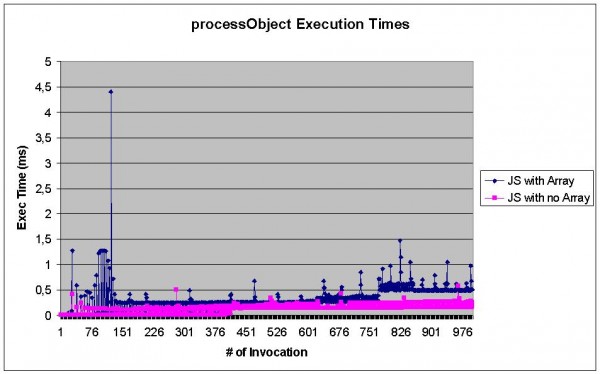

I copied the 1000 execution times of processObject for both use cases into an excel spreadsheet and graphed the timings. It’s interesting to see how the exec times change over time with an interesting spike at about 800 times the method was invoked:
JavaScript execution time over time
The blue line shows the execution time of the scenario where I have the 1000 additional JavaScript objects in memory. The pink line shows the times with only 1 custom JavaScript object in memory. There are two interesting observations here – and I hope some of you (my fellow readers) can share your thoughts on it and correct me if my conclusions are incorrect: We see an increased exec time at the very beginning and a jump in execution time after about 800 executions of this method. I assume it has to do purely with the Garbage Collection and Object Allocation strategy of IE. Daniel Pupius’ blog about Garbage Collection in IE6 gives some answers on when IE kicks of the GC (after 256 variable allocations, 4096 array slot allocations and 64kb of String allocations). I am sure Microsoft has changed the GC strategy for IE7 but Daniel’s blog definitely explains the spike in my graph. My string size ends up being 79k. After about 800 executions it crosses the 64kb limit. Interesting is that from that point on I have constantly high execution times. So – the GC always runs when you have strings larger than 64kb!! I explain the individual smaller spikes with the GC runs triggered by 256 variable allocations. What I can’t explain is the much higher execution times in the very beginning – any thoughts?

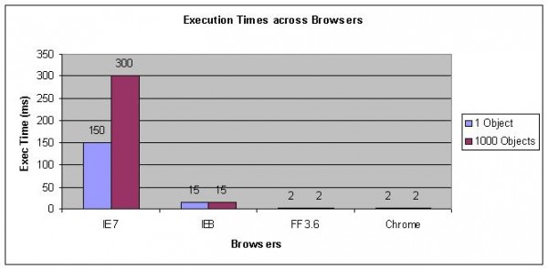

Running this example on IE8, FireFox and Chrome is FAST
I ran the same example on Internet Explorer 8, FireFox 3.6 and the latest version of Chrome. Not surprisingly the execution time on all of these latest versions of these browsers where between 2 and 15ms. These timings were the same for both use case scenarios (1 and 1000 objects in memory). Chrome and FireFox were in fact the fastest with only 2ms of execution time. IE8 took 15ms. The following graph shows the comparison between the tested browsers:
