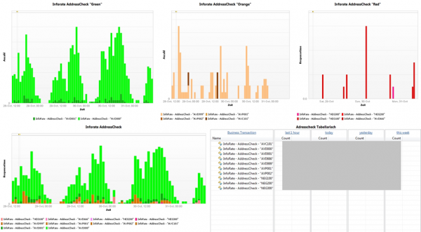

Using dynaTrace allowed them to accomplish these and other general Application Performance Management goals without needing to modify the 3rd Party eCommerce Platform and without any help of the 3rd party address validation service. The following dashboard shows the calls to the address validation service. On the top line we see green which represents the calls that return with a success, orange which represents validations with partial success and red that indicates those calls that failed. The bottom left chart shows an aggregation of these 3 return states showing spikes where up to 30% of the validation calls don’t return a success:
Monitoring 3rd Party Service Calls, the response code and impact on End Users
Monitoring the service like this allows Leder & Schuh to

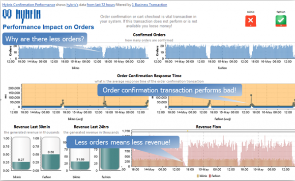

As indicated in the beginning, the option “cash on delivery” is much more popular than paying by credit card. In case the address validation service returns that the address is invalid or in case the service is down (not reachable) the user only gets the option to pay with credit card. Correlating the status and the response time of the service call with the actual orders that come in allows Leder & Schuh to see the actual Business Impact. It turns out that more users bounce off the site in case the only payment option they are given is paying per credit card (Functional Impact) or in case the validation service takes too long to respond (Performance Impact). The following dashboard shows how business can be impacted by the quality of service calls:
Quality of Service Calls (Performance or Functional) have a direct impact to Orders and Revenue
Quality of Service Calls (Performance or Functional) has a direct impact to Orders and Revenue
