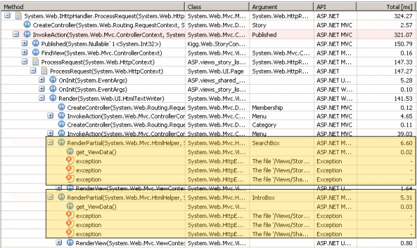

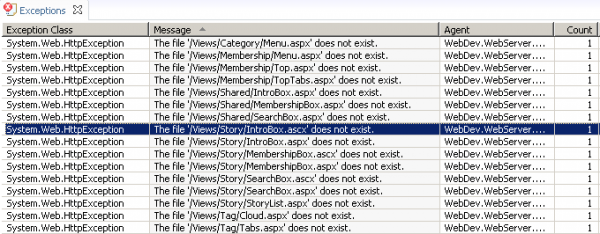

I am currently working with the project Kigg from CodePlex. Its a great application that makes extensive use of ASP.NET MVC. When browsing to the default page several things happen. ASP.NET processes the default page. The application uses a master page which also gets processed. Both – the master page and the default page contain calls to the HtmlHelper class to render certain controls like Menu, SearchBox, MembershipBox and more. Kigg uses RenderPartial by passing a partial name as first parameter. From the outside everything looks fine and it works great. You might be surprised to see the following view captured with dynaTrace:
Exceptions thrown by a single page request
When we drill into the PurePath we see that those exception are thrown by RenderPartial:
3 Exceptions thrown for each RenderPartial

This location patterns are used in case a partial name is passed to the RenderPartial method. For every pattern – RenderPartial is calling a File.Exists to check the files existance – and throwing an exception in case the file does not exist. In the case of the PurePath shown above – the actual control that was referenced was stored in the ~/Views/Shared directory and had an .ascx extension. The first 3 attempts to locate the file with the other file patterns failed. The 4th succeeded and the control could be loaded.
The problem that we have though is that every page request is throwing many exceptions. Exceptions that are hidden for us developers and that don’t actually show a real problem with the application. But – the more exceptions that are thrown the more overhead you have. Imagine several hundred concurrent users on this front page. Every web request throws 16 exception (in this case) – making it several thousand exceptions every second if we expect some decent load. Exceptions – that cause overhead and degrade overall performance.
